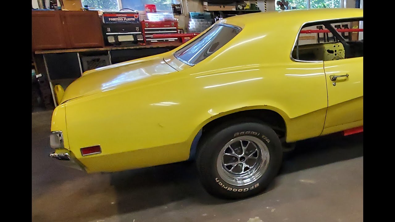

It was a rain day here in the great NorthWet, so I decided to do some work on the CJ Cougar. First, I stripped parts off the front fender. Something I should have doon a long time ago. The L/H fender had a slightly different shade Yellow extension on it. It appears who ever swapped in had no idea how to access the back side to remove the nuts and just cut new holes to get to them.

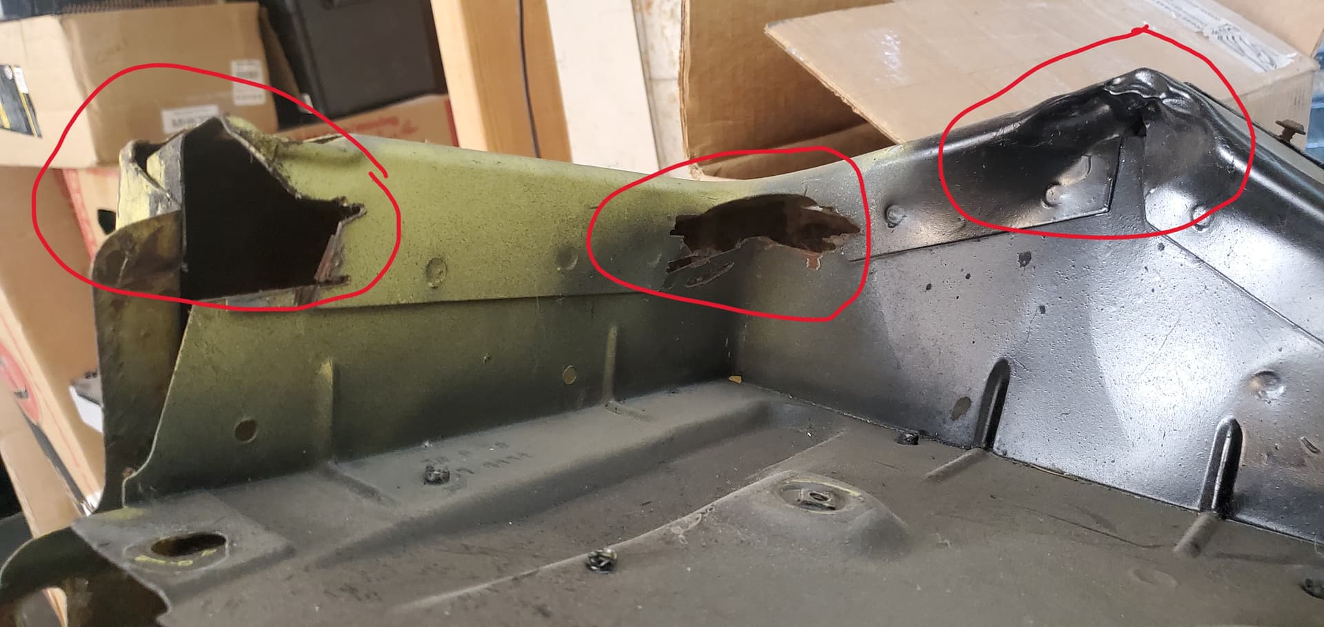

There is also damage as you can see here. I do have 2 more L/H front fenders that I can use. I doubt I’ll try to fix that little mess.

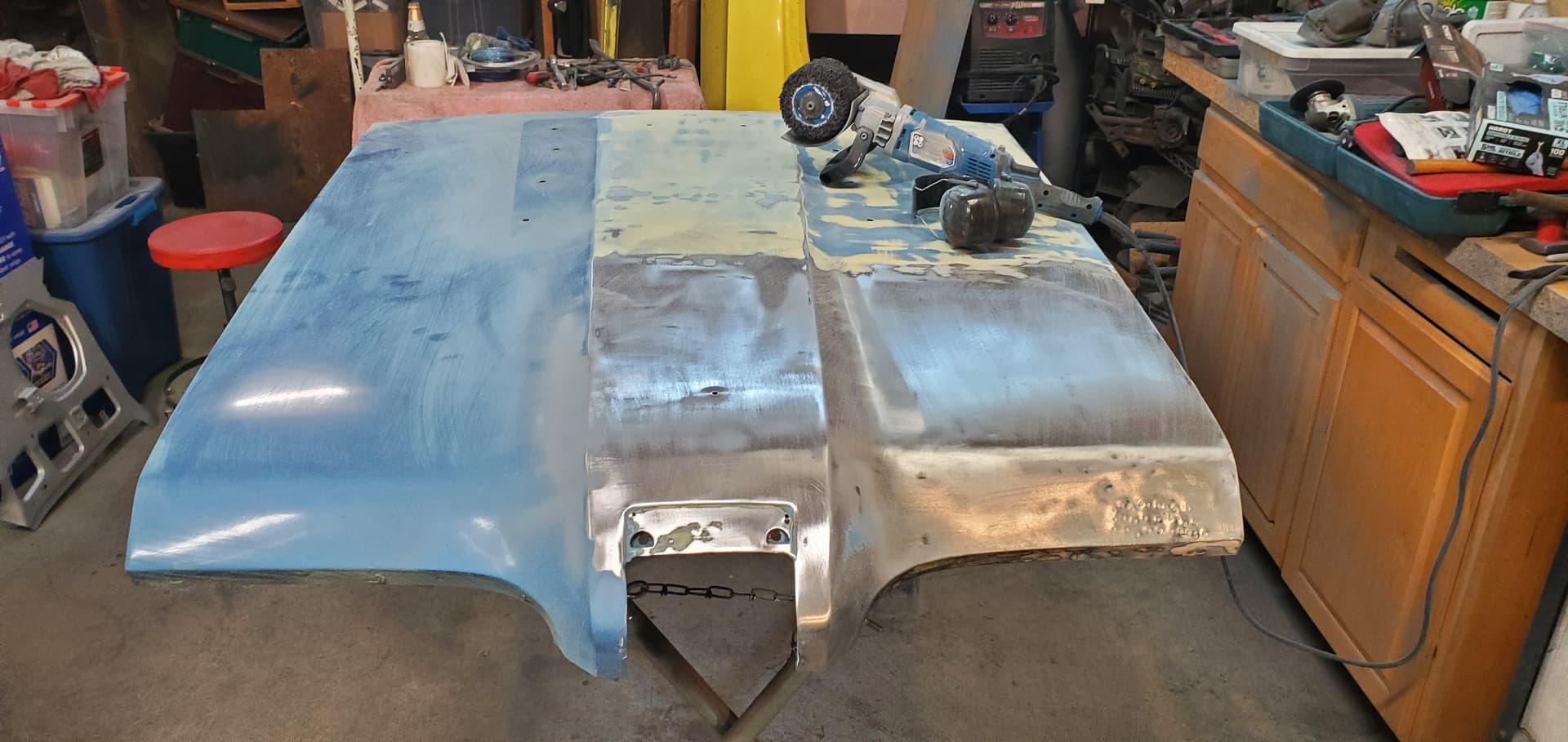

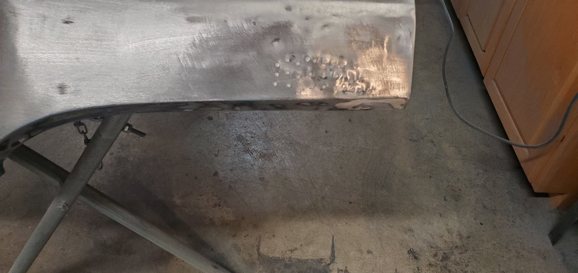

Then I decided to start stripping paint off the hood. I worked on about 2/3s of it only going to metal on maybe 20% of the hood. I knew it had that hole in the front center but didn’t realize it had previously repairs done to it.

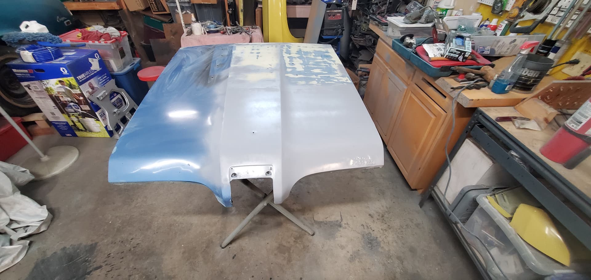

It was getting a bit late and stopped here. I’ll need to make a tent before I go back to it. So I sprayed some sealer on it for now.
I’ll get back on to it maybe tomorrow. I need to do some shopping first though. That Metal Conditioner does work well, it’s a lot faster than a sander, not as expensive as having it stripped with media, soda or dipped. May not be as good in the long run. But it has to fit my budget.

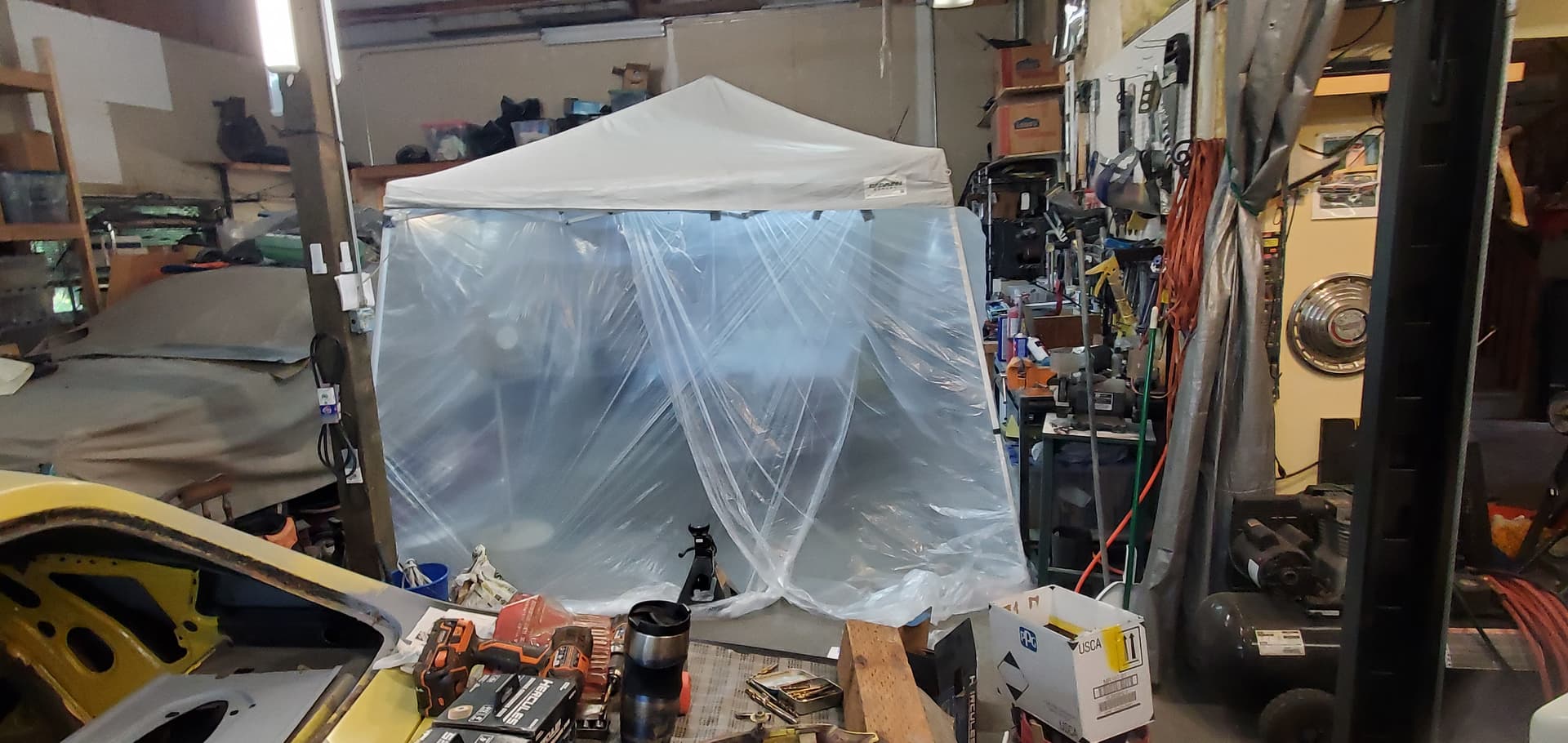

Tent and respirator are a good idea with all that lead paint dust.

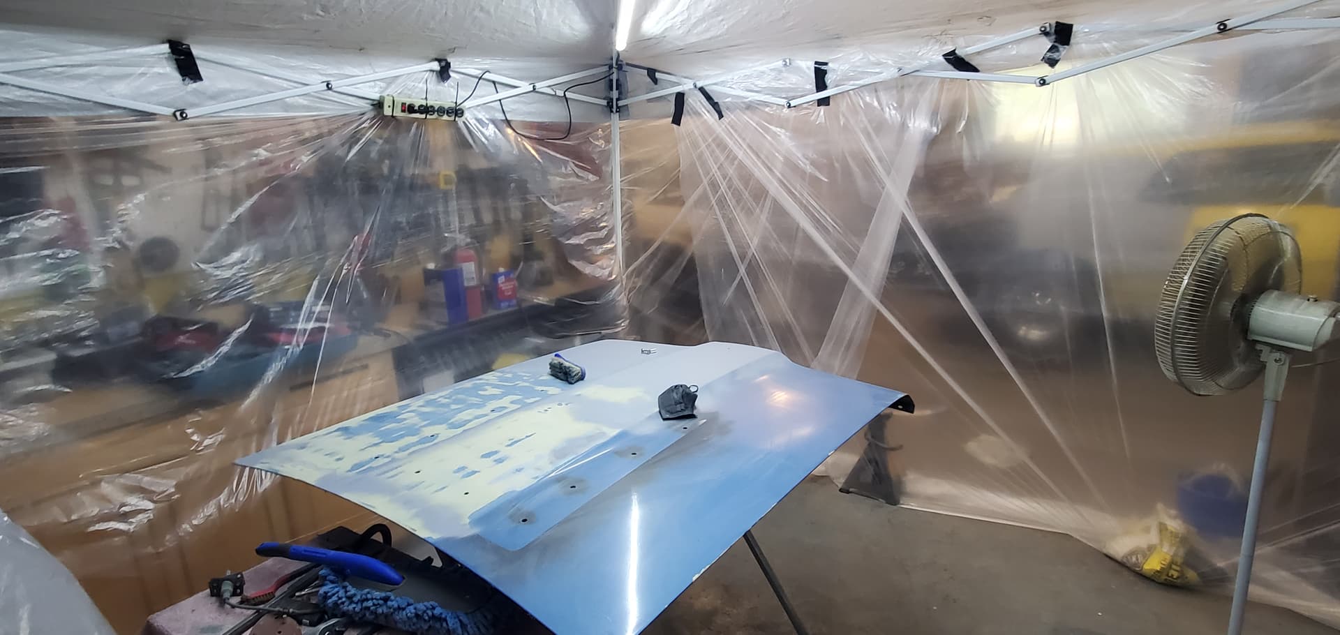

I got the work tent done earlier today.
Complete with a power strip, fan and an 8 foot LED light.

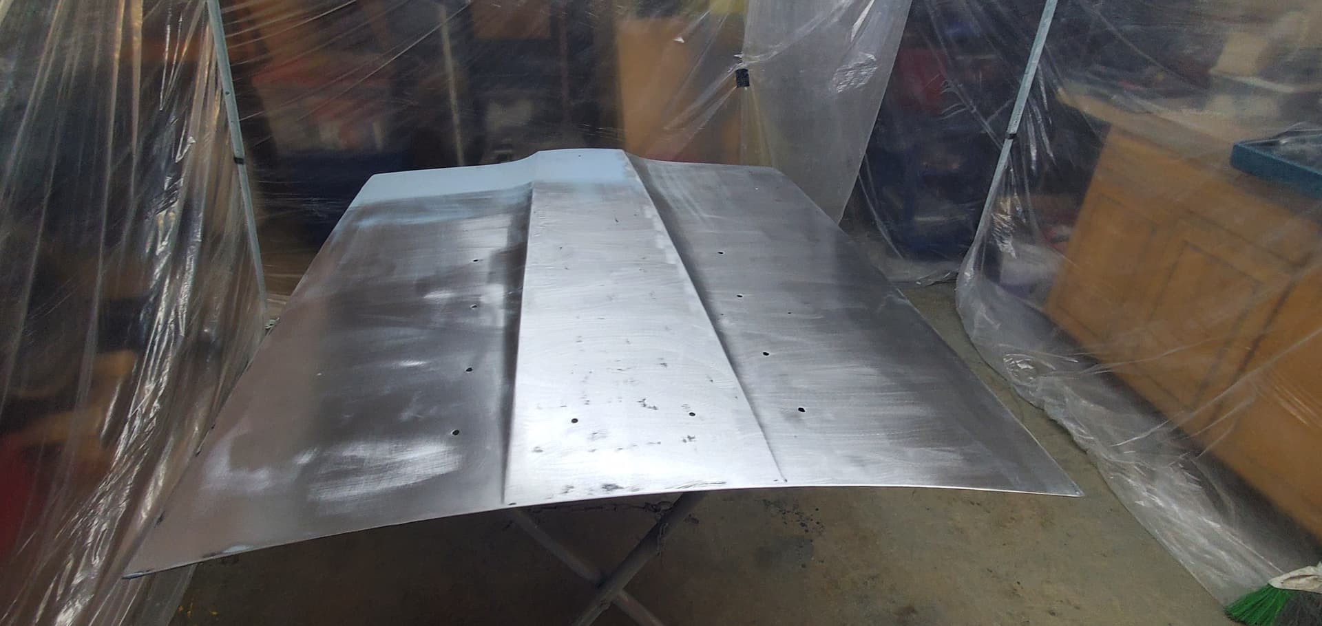

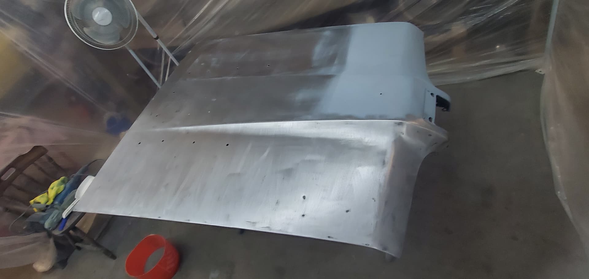

I finished stripping the hood.
I did not remove the primer I sprayed yesterday. I may in the AM before I primer the rest of it,

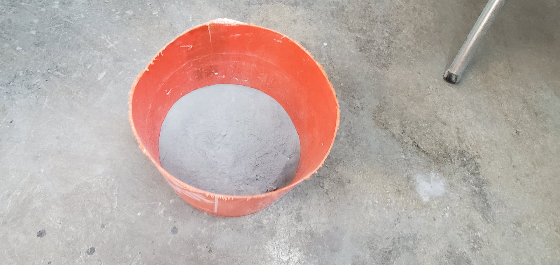

Stripping the rest of the hood only took maybe 45 minutes,
And produced a good 2 inches of dust in this bucket.
