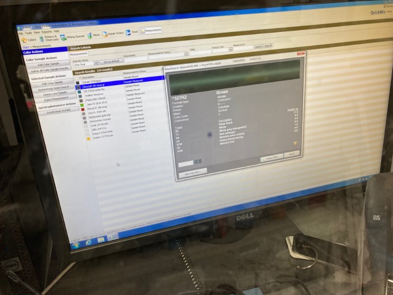

We did a digital scan of the fender extension from my GT-E. Here is a photo of my GT-E next to Joe V’s 428CJ GT-E with original paint. As you can see it is a perfect match.

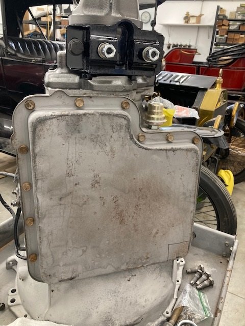

The transmission was professionally rebuilt. They tested the pan with alcohol and found it had pinholes in one corner (marked in a square).
I ordered a new pan and bolts. Today I installed it and torqued the bolts to 185 inch pounds.

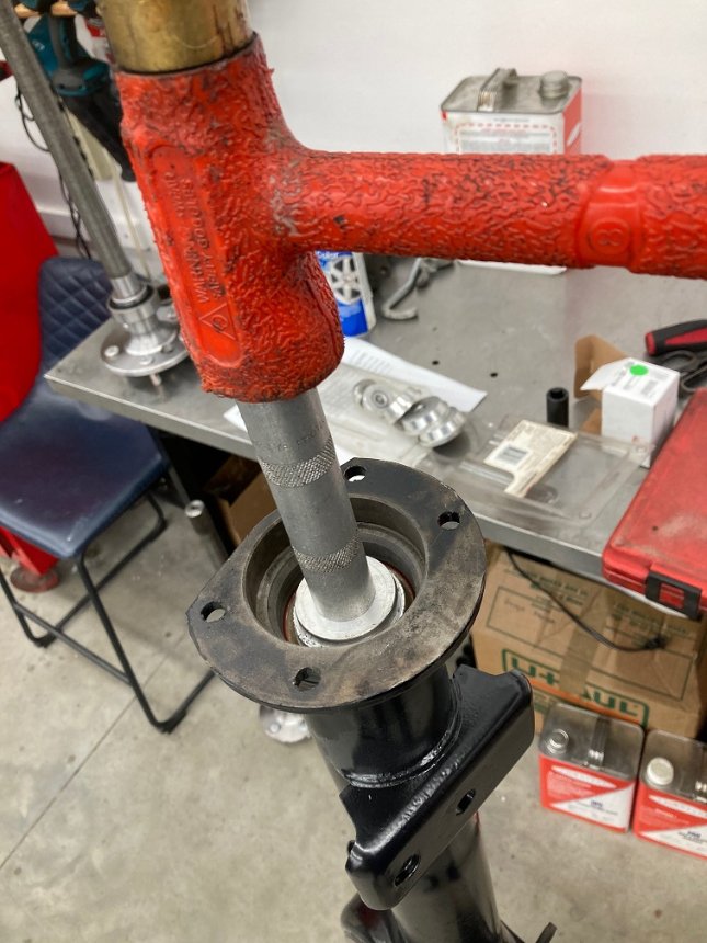

I bought new 31 spline axles from Summit to go with the 31 spline 3.50 open rear end. The axle studs that came with the axles were SFI approved however they were too long to use with factory styled steel wheel lug nuts so I had to press all of them out and then buy normal length studs and press them in. The axles were a little long, so I had to take them to a local machine shop to be trimmed a tiny bit. Which meant they removed all the studs in order to chuck the axles in their lathe.
So I am really good at axle stud installation.
The new axles use a standard 28 spline style axle seal, the axle itself is polished and fits the seal. I put the seals in the newly powder coated housing with a seal installer and dead blow hammer…

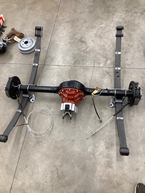

The axles, springs and brakes all got restored too. Today the last of the rear end work was done. It’s ready to be installed.

FYI, ditch the cork transmission oil pan gasket for this. https://www.summitracing.com/parts/lub-llt-f0c6
You’ll thank me later it’s 100 % better then cork.
