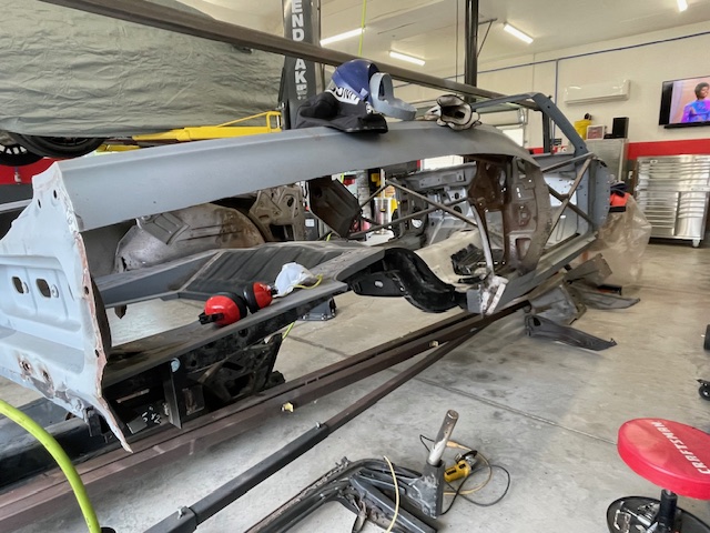

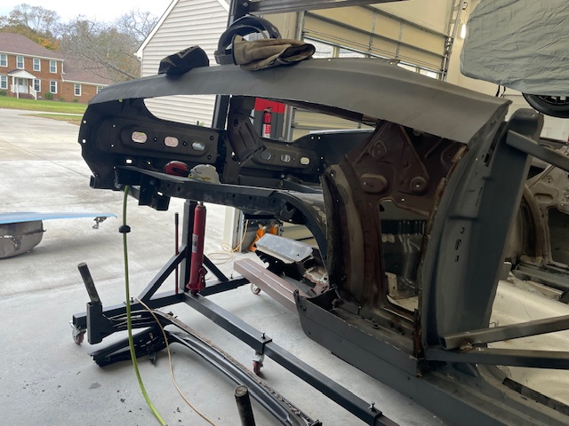

It’s been a while since I posted, so I thought I would give an update on my progress. I have the driver side inner rocker, front torque box & replacement rear frame rail installed, and the outer rocker extension and some other parts patched, so the driver side structure is pretty much done. Still have to complete the plug welding, but I’m happy with the results. The passenger side should go much faster once I get started, since I know what to expect now.
One thing I did learn is that there IS a difference in the rear frame rail between a coupe and convertible. The length is the same for both. The difference lies in the torque box on the side of the inner rocker. Pretty easy to covert from coupe to the convertible, but the other way around would be more work. Posting a few pics of the difference, both before and after the alteration.

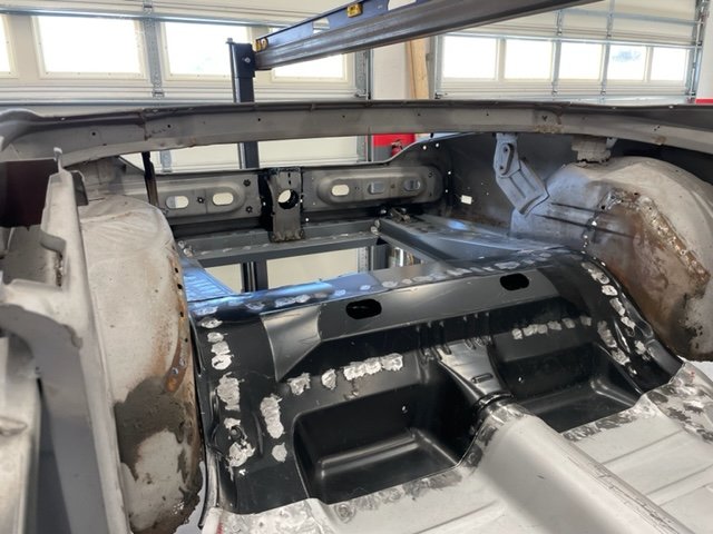

Thought it was time to get back on the car after taking time to enjoy the spring, summer & fall! I finally got started again in December on the RF frame rail, front T boxes, trunk transition, trunk floor parts, & got to install a new “shiny” Heidt’s front crossmember for the new suspension. [img]
I got the new firewall, rear aprons, lower radiator support crossover, and Mustang to Fear front aprons / frame stiffeners installed. Happy to be making some good progress. Getting closer to installing the new floor.
I’ve been making some more progress on the old girl. Got the floor in and welded, and the truck floors welded after setting in the new gas tank to make sure it all lined up before making that final commitment.

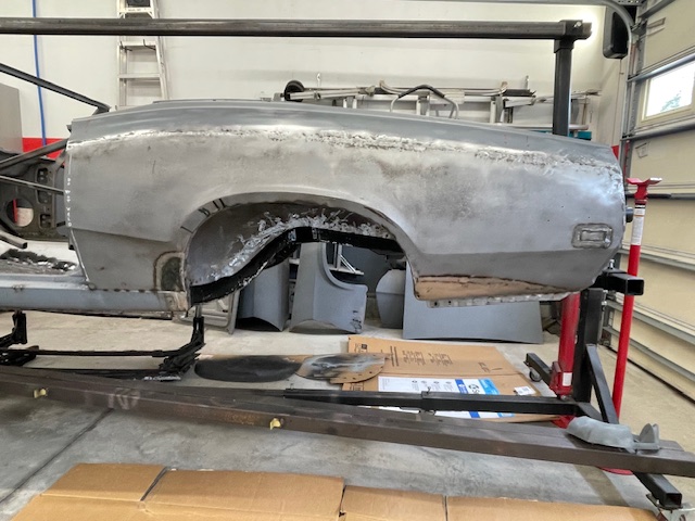

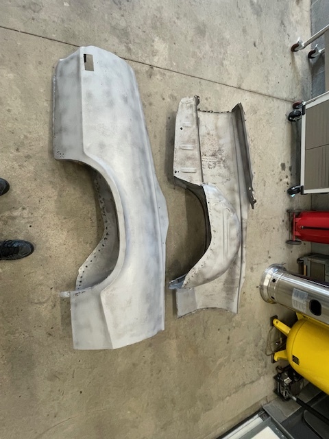

After a long break I’m finally back on the Cougar. Didn’t get much done winter 24’ as I’ve been waiting on Dynacorn to come out with the quarters and wheel houses, and I didn’t want to order the “crappy” ones that are available.
A couple of weeks ago, I stumbled over a set of 1970 quarters with full wheel houses for sale in Indiana, and my neighbor just happened to be in St. Louis, so he agreed to stop and pick them up for me and bring back to Va.

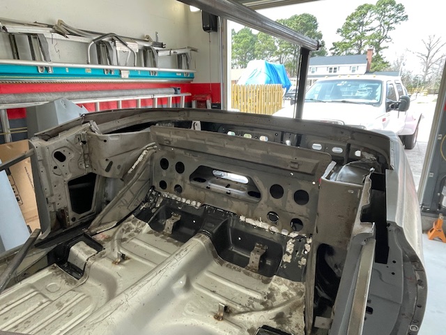

There are some differences in the 69/70 quarters as most of you are aware, but I’ve figured out a way to make them work. The rocker on the 69’ is about 5/8" longer than a 70’. I’ve sectioned that back to make the larger 70’ outer wheel well fit as the 69’ did, which in turn, enables the 70’ quarter to line up as well. The inner wheel house looks/fits exactly the same as a 69’, as the brackets for the backseat frame line up pretty darn close.

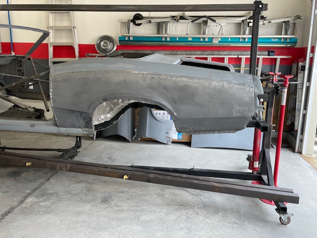

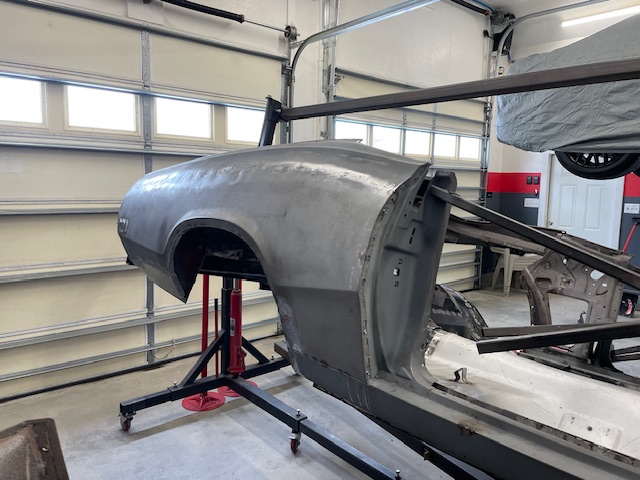

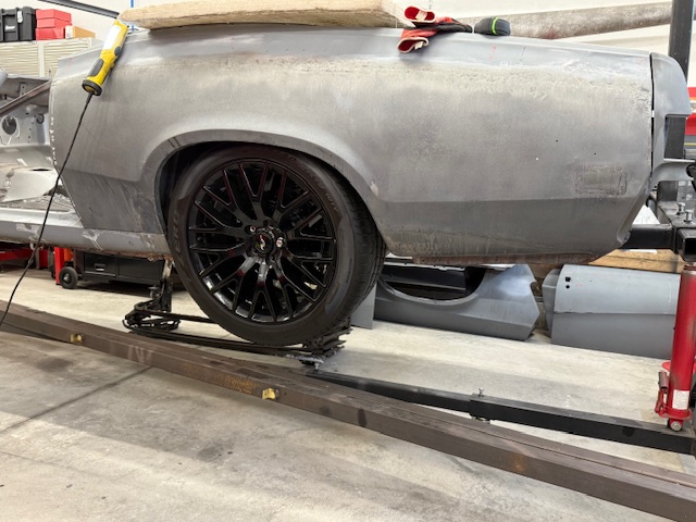

I have the 70’ quarters fitted to the 69’. I had to make a few alterations. The first was shortening the rocker about 5/8". The second was a mod to the 69’ NOS outer wheelhouse on the passenger side to fit that shortened rocker. The third is I had to come up with something to make the flat spot for the convertible top in lieu of the BFH method used by the factory. I decided to make a pocket for the top that follows the curve of the car. Maybe not the best way, but it should have enough room as I measured the old wheelhouses that were smashed down.

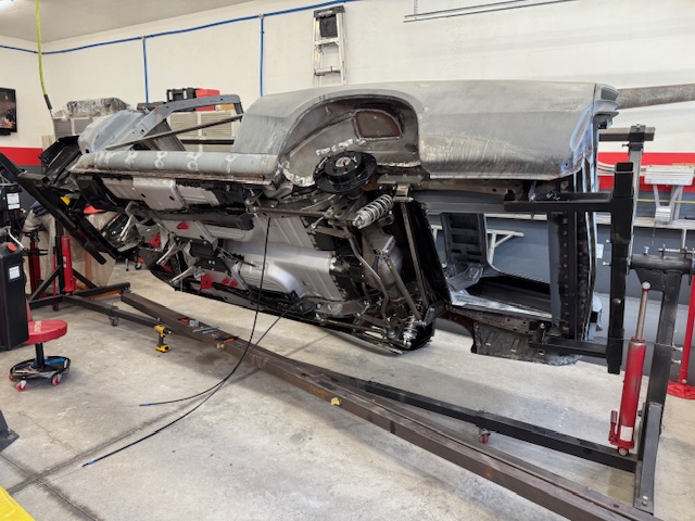

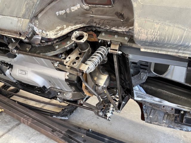

I got back on the cougar mid November. I’ve fitted the 4 link for the 2nd time of 3 so that I could install the brakes, bend / test fit the brake lines in order to weld the brake hose tabs on the rear axle before painting it, and mach up the Wilwood parking brake cables. The underside of the car is really close to being ready to epoxy prime, seam seal, and spray on the raptor liner.

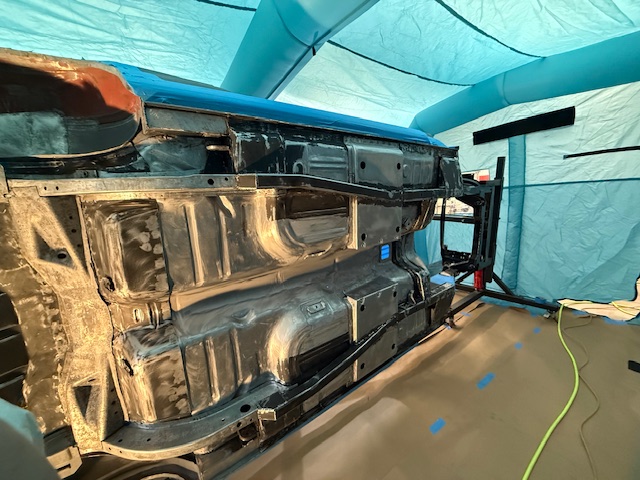

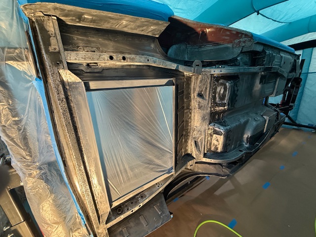

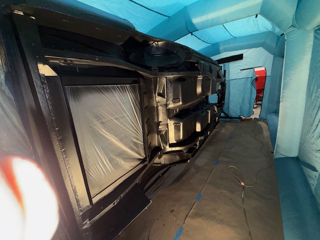

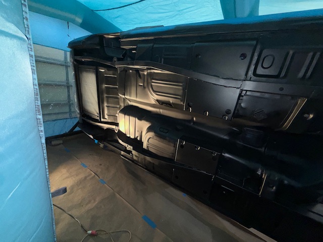

Got everything on the underside scuffed with 120 grit, cleaned, sprayed with Upol black epoxy primer, and then seamed sealed everything. Now ready for the Raptor liner.
I finished the Raptor liner and almost forgot to take some pics before starting to install the 4 link and rear axle. Although I have some splotchy areas, I think it turned out ok for my first try at spray on liner.
