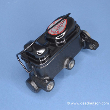

Glad to hear that - I just got one from them. Here is the one for the 70 models with the embossed lid rather than the sticker:
1969-72 Mustang & Shelby Master Cylinder with Cap | Dead Nuts On
The problem I’m having is with the booster. No idea what booster they put on but the two bolts on the booster are farther apart than the holes on any master I have seen that is for the 1970.
