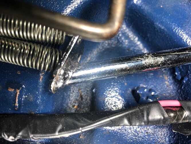

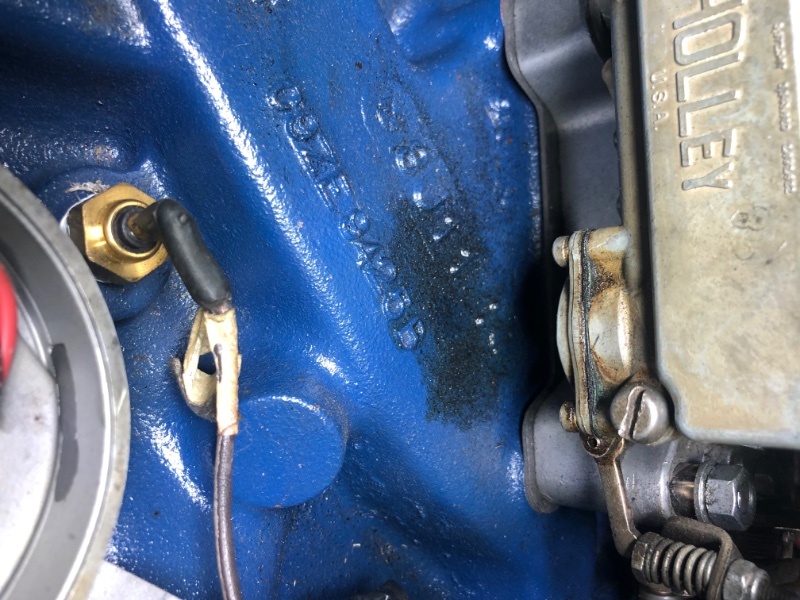

When I pulled off the air cleaner , I noticed this
Spot under the accelerator pump and around carb on manifold
I hope the non-Ford screws I see tacked the vacuum advance plate (that the Pertronix mounts on) to the plate below it. You need to do that when you convert a vacuum advance distributor to pure centrifugal. Make sure that plate can’t swivel at all - beyond the tiny play between gear and camshaft. It appears your guy knew that; that socket head screw seems to be disabling the plate’s pivot.
So this install looks correct
Is that plate the Pertronix is attached to anchored well in all dimensions?
My guess is the allen head bolt, as RB pointed out, is locking the plate. However, you could try to twist it with your fingers. The plate that the Pertronix is bolted to, should not move at all, if it is loose, you will know it as it will rotate around. Likely good
That accelerator pump sure doesn’t look like a rebuilt carb though! How long ago was it done? My guess is that you likely don’t get two good streams, and it could be adjusted incorrectly too.
