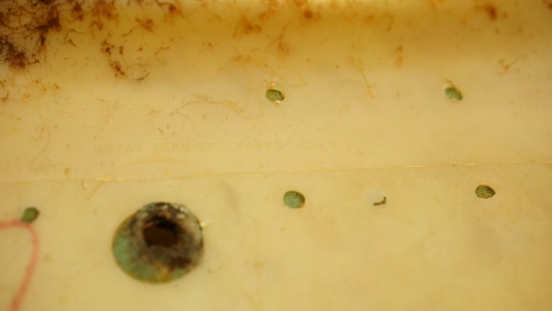

Nice repair work to your rear panels. I have my whole interior removed for a good cleaning before I restore a bunch of stuff. My rear interior panels say “NOTE: Service Parts Only.” It was very difficult to photograph but I gave it a shot. Both sides seem to be service replacements that happened at some point in the cars history. Just wanted to share and see if anyone had seen these before.
I’m thinking of swapping the interior to Black, and eventually change the top to black also. Haven’t pulled the trigger because of the door panels, afraid I will jack them up, or they will look flat and plain, with no “character”
I remember one of my panels having that that note on it as well. Cant remember which one however. I should look, I wonder if that was the difference in fitment between my two panels.

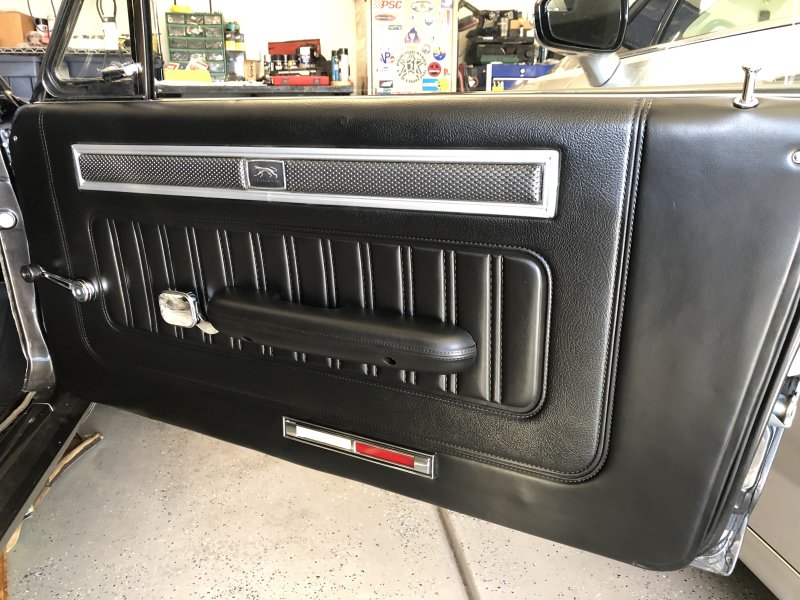

Speaking of fitment I finally got the driver side looking good too, It certainty was alot more of a headache getting it right then my first one but I did succeed and happy with the results. I just need to change the color and paint the basket weave, then install the sweep.
I have found stretching and gluing the edges in stages with an overnight cure has helped. I did the front edge and bottom one day, the rear section the next and finally the top on the third day. Having the previous section secure before moving on aided in getting everything tight. I did have to add some relief cuts to the vinyl in some areas to help stretch so dont be afraid to do that if you need do.
For as much time as I spent on that driver side panel I could have probably bought some new vinyl and wrapped the panels easier then reusing the original :mrgreen:
I think the door panel job was a bit easier actually, maybe not if I did not have to fight the driver panel. Painting the basket weave was the hardest part.

Here is the final result of fighting the driver side. Im not as satisfied as I was with the passenger side but it came out decent in the end. After the previous comment a about service parts labeling I checked my old parts and found the driver side to be a “service part only” And the passenger side to be original, maybe that had something to do with having to fight that side? Interested if anyone else notices that as well.
