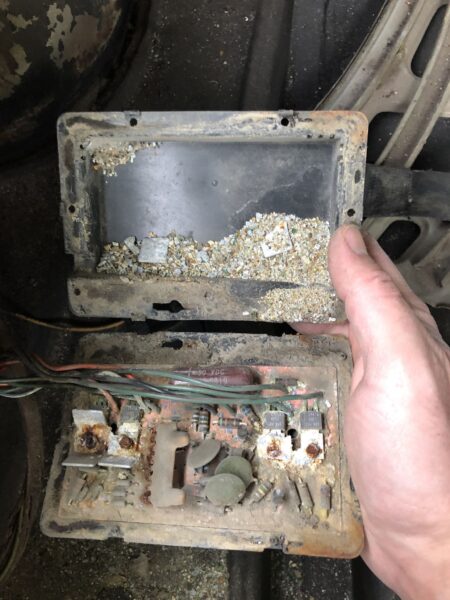

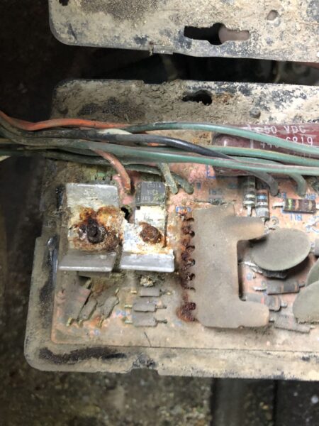

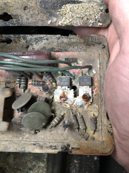

Tinkered with it a bit more, suddenly the left center joined the party as well? But inconsistently. I started wiggling wires to see if anything was loose, and in the process wiggled the sequential box. Stuff started pouring out of the box, so I popped it open to find…
I don’t know, can anybody spot anything wrong? :laughing:
Time for an upgrade.
You can reuse the black plastic case - after cleaning.
Hopefully, the red and black connectors can be separated and are not corroded.
If they are, replacements are available.
I cranked and yanked and pried on those connectors quite a bit and couldn’t get them to budge. I have some Weather Pack connectors lying around from another project I may use instead.
Unfortunately, Weather Pack connectors won’t match the original connectors as used on the original or upgraded sequential controller.
I had these pigtails made up to solve this problem:
Holy F! It’s a miracle any bulb anywhere did anything.
