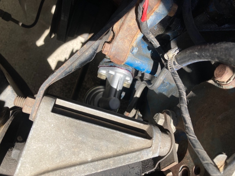

The fuel pump was quite the experience. I found whoever opened it up before didn’t put a gasket under it. It was just silicone. Now, there’s a real gasket.

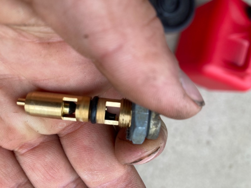

Apparently, last week when I took it apart, the fuel line was not properly lined up and bit off a chunk of the o-ring. I found an assorted o-ring kit in my dad’s old tool chest, and there was a winner in there. I threw it all back together, started the engine again, and I watched the carb like a hawk for about five minutes. It stayed dry.
Here is the chunk of o-ring that got bit off. It got stopped in the needle (is that the right term? I’m still familiarizing myself with all these new terms).

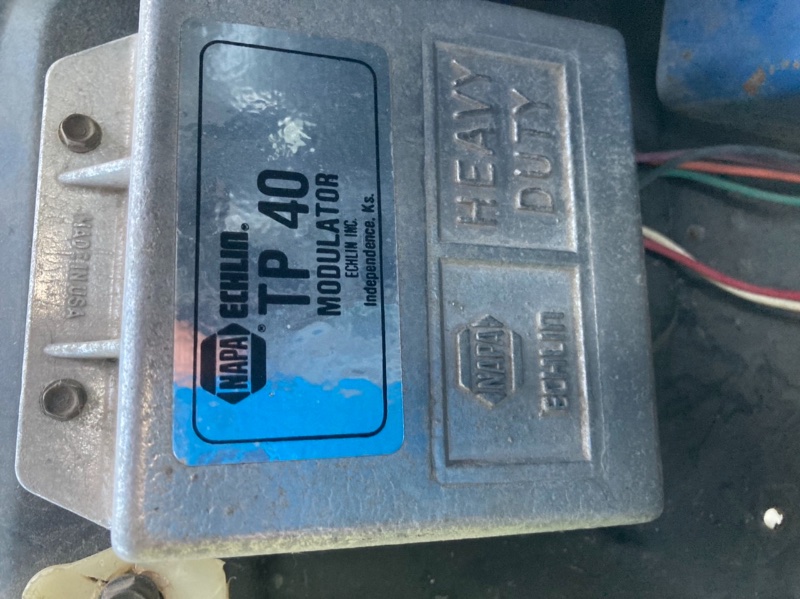

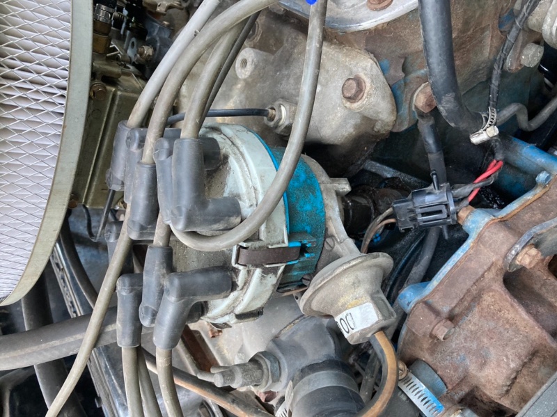

Here’s a few shots of the ignition modulator, distributor, and coil, too. I don’t know the specs of anything.
