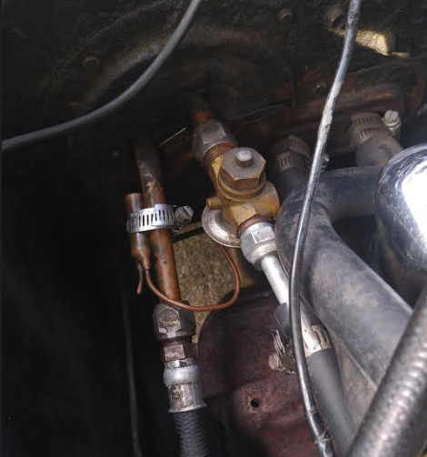

    3.I’m not sure if the bulb is attached correctly or not, but I think it is. I put it back in the position it was in when i got the car- clamped onto the evaporator outlet tube. I can take a picture and post it when I work on it next, which hopefully will be tonight.

Someone earlier asked about the tx valve and sensing bulb, this is as it was when I got the car and I put it back the same way
you need to wrap that entire thing with insulating tape

The lack of wrapping will affect the temperature sensed by the bulb and the operation of the expansion valve. I just can’t say how much it will affect it and whether or not you’ll be able to get it running properly without it.
I had the same thought, but honestly thought the temp of the bulb would be higher from engine heat, not shut the flow of refrigerant off and cause the evaporator to freeze up. I haven’t gotten that far, but it’s a good thought to keep in mind for when I put a full charge in it. I will probably go ahead and order some of that wrap now.
