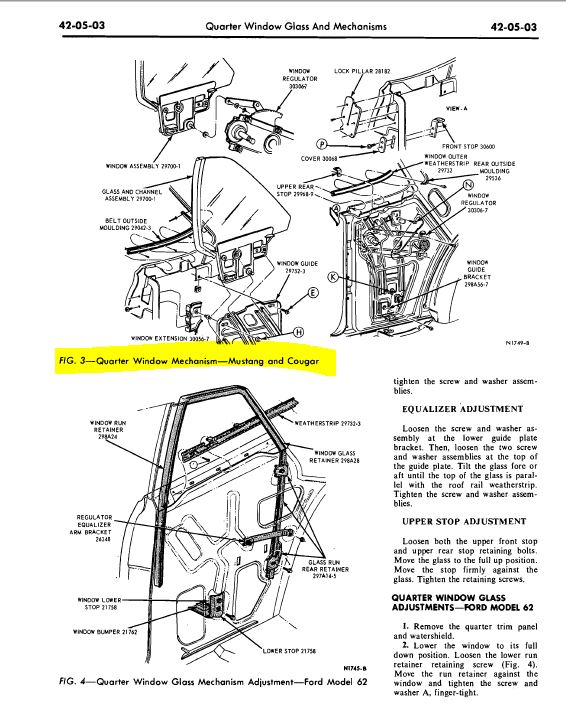

Hello All,
My passenger rear quarter window will not roll up/down. I have the Manual and no issues pulling out the rear seat and taking the panel off…but what should I be looking for/adjusting? Seems like it is “off its track”???
Thanks in advance. I really appreciate all the help on here…invaluable!
Joe V.
Capture
Most likely old lube is now causing the issue. In trying to force the window up or down the regulator arm(s) are now bent. Common issue.
Best to remove everything.
Clean 3 channels & nylon glides VERY good. Inspect regulator. repair/replace.
