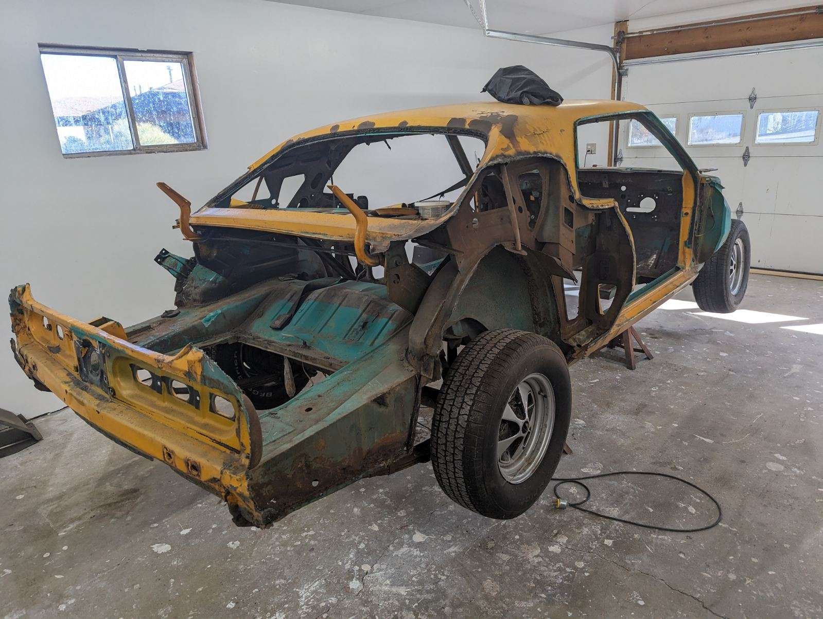

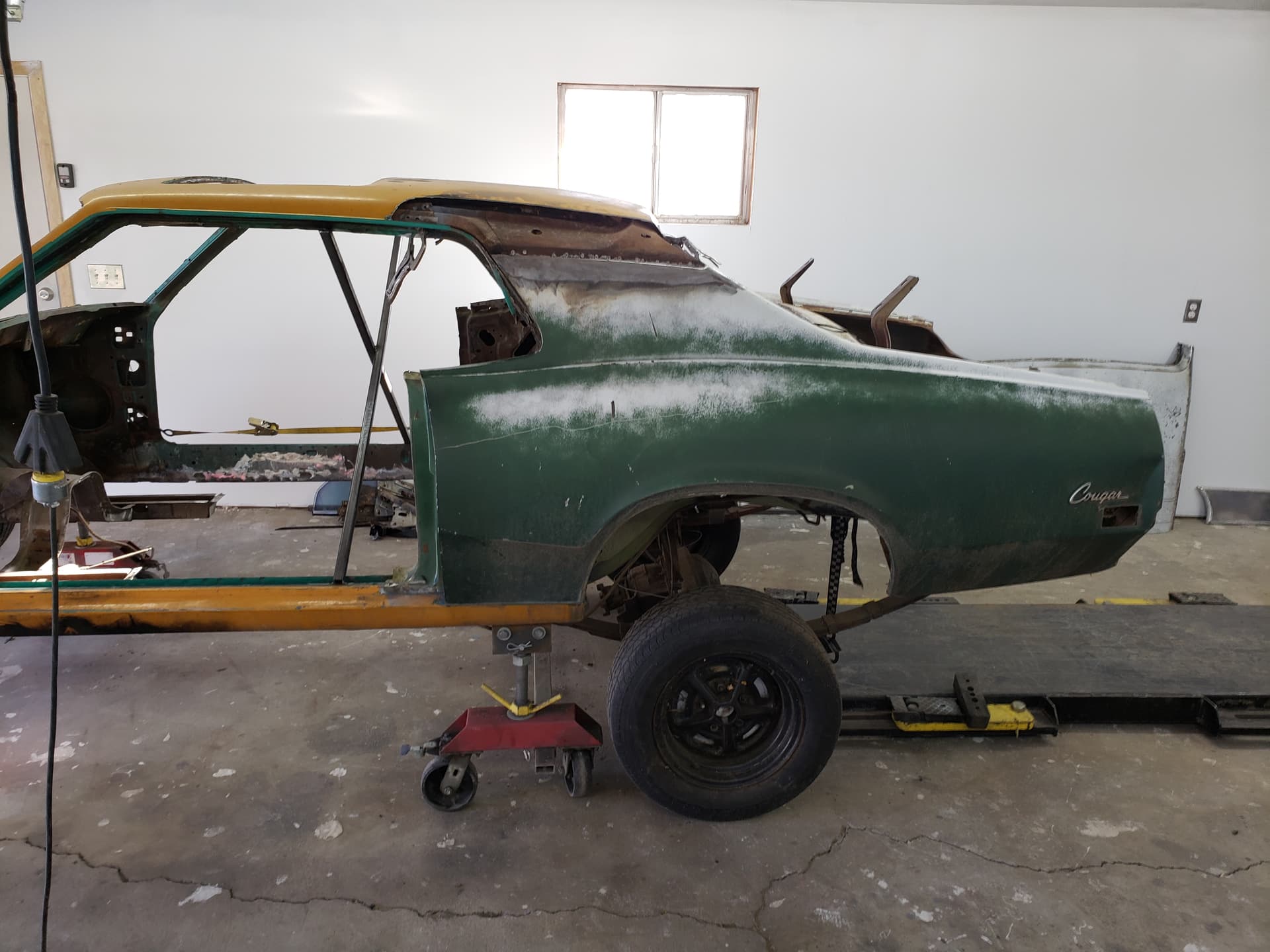

Latest pics of the “tear down”…
I’m not doing this work, a very talented guy is. Next is frame rack & media blasters. The the dissection of the donor cat starts.

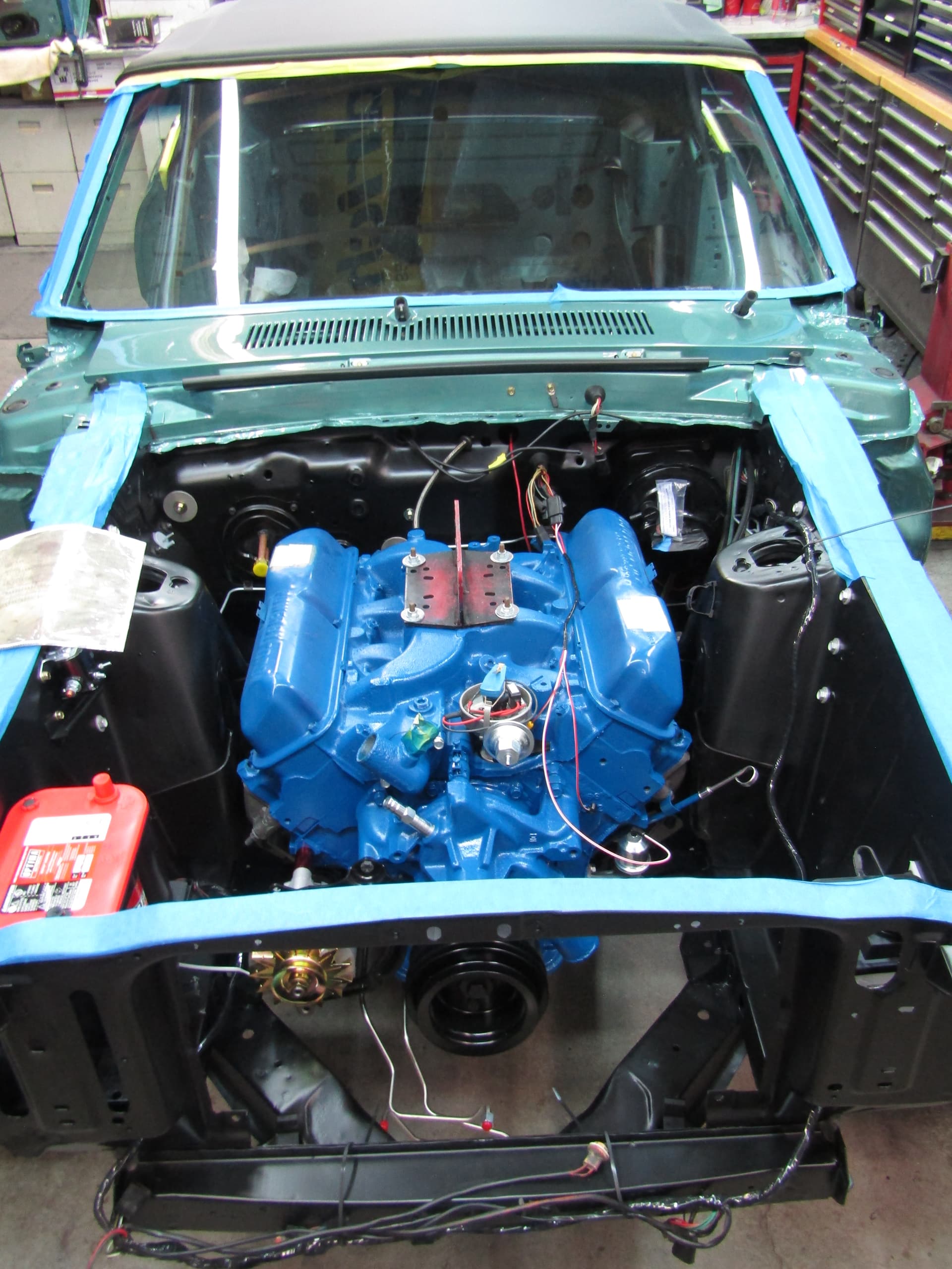

In the mean time
The 69 XR-7 Q code is coming together,

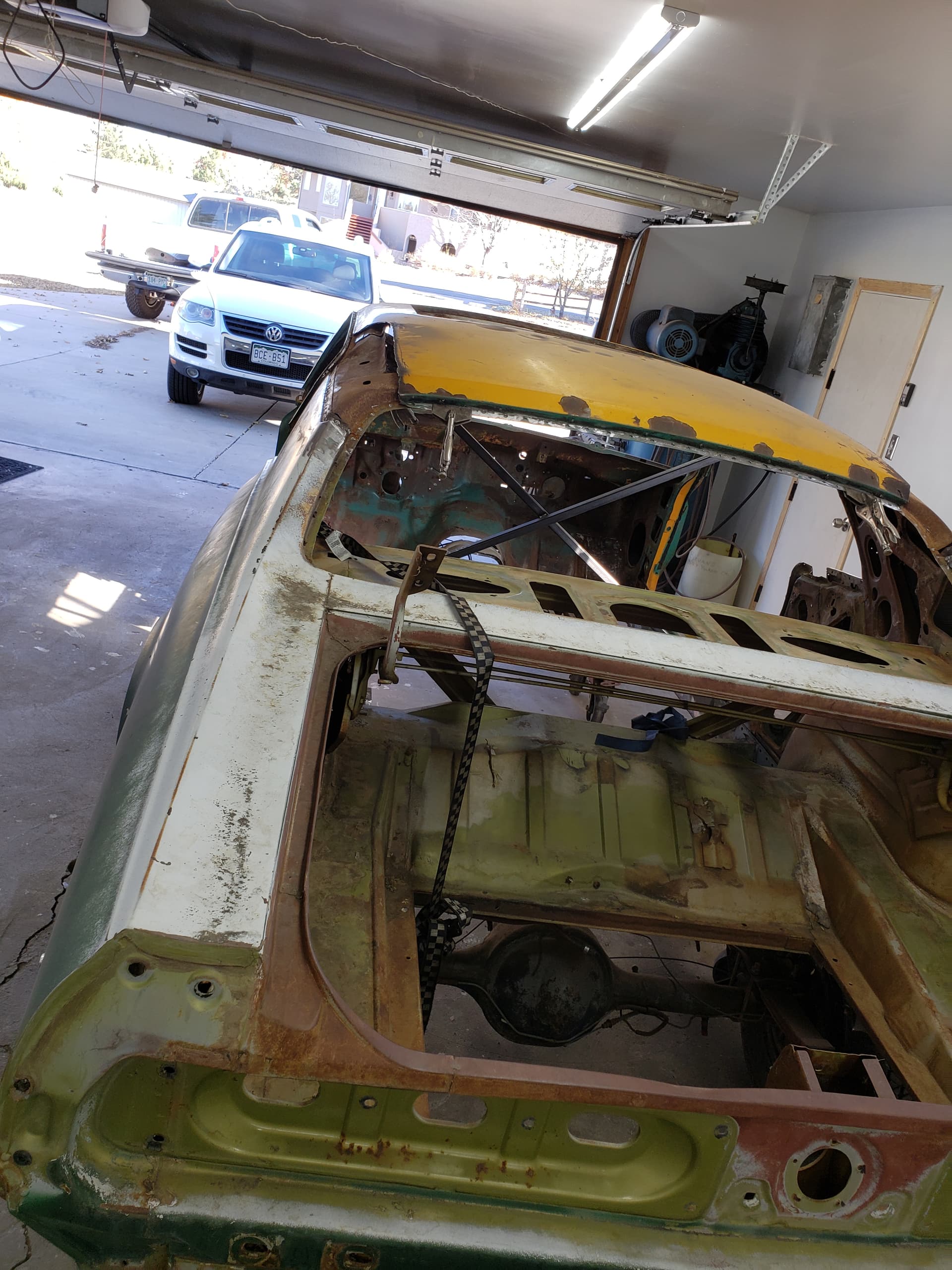

Ok, So here’s whats left, I deliver shell Monday to be dissected…

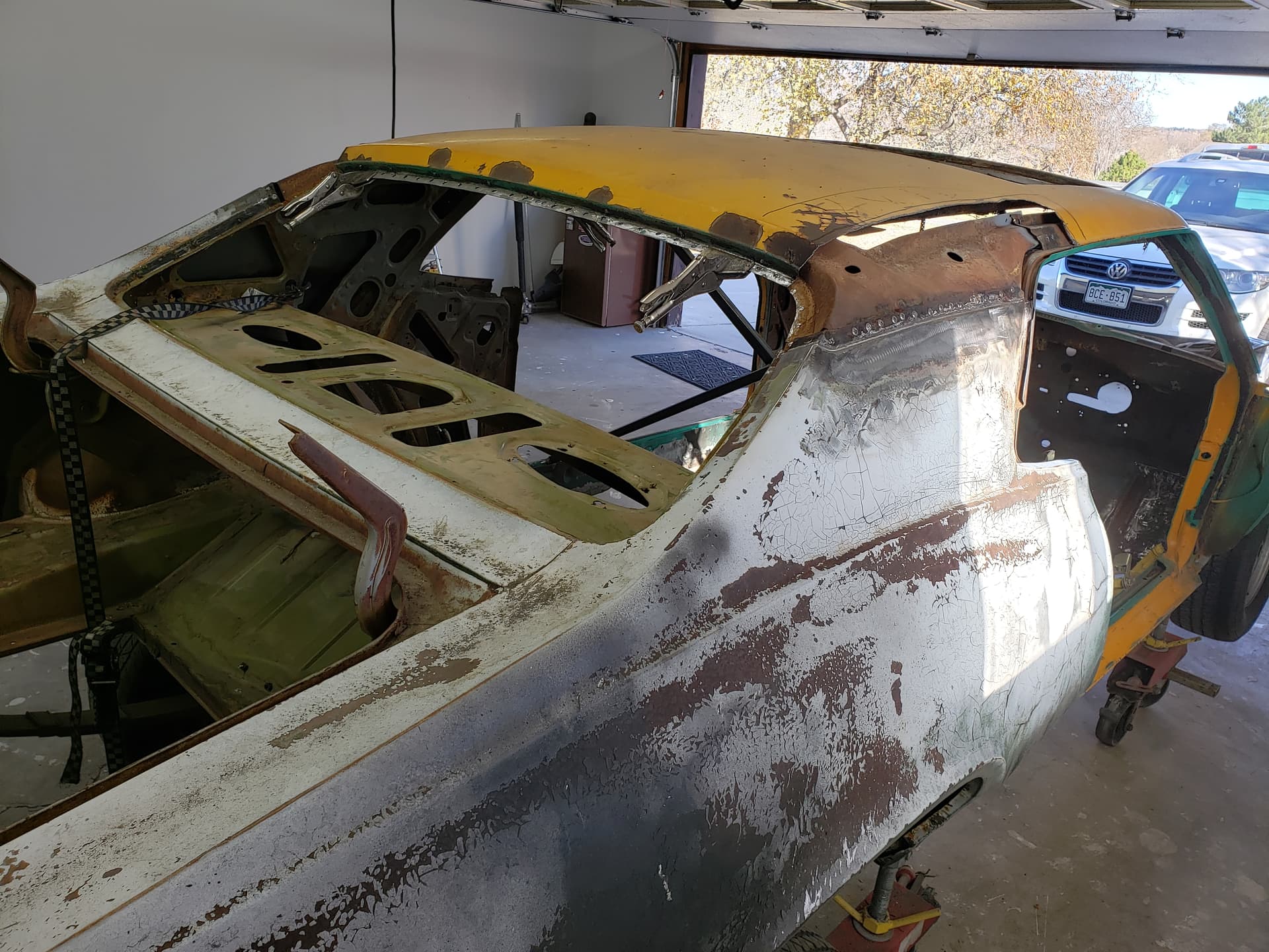

Getting back on the posted topic… I just went to see the car Sunday. Back half is now fitted to car. I took doors & hinges to ensure fit. Should be going to blasters in a few weeks. Pics soon.

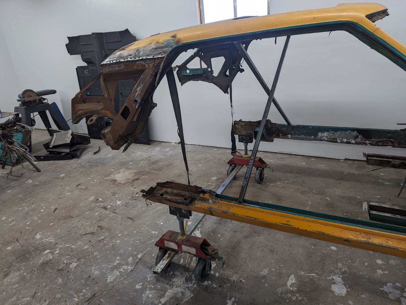

Moving right along. My '69 Eliminator needs a similar amount of medal work on the rear but I opted to save the original rear frame rails/lower window panel/quarter structure and the staggered shock brace. Otherwise, this is certainly the more efficient method as I had to drill out hundreds of spot welds
Only the 4 speed cats got the staggered shock ( which is avail in reproduction. Contact me) The 428 & Boss cats got it, but not the 351’s even if they are 4 speed. They did get the rear sway bar though.
This Cat was left outside way too long sadly…
The owners did NOT want a rebody, This was the fathers Cat, and son & brother are doing this Cat.
