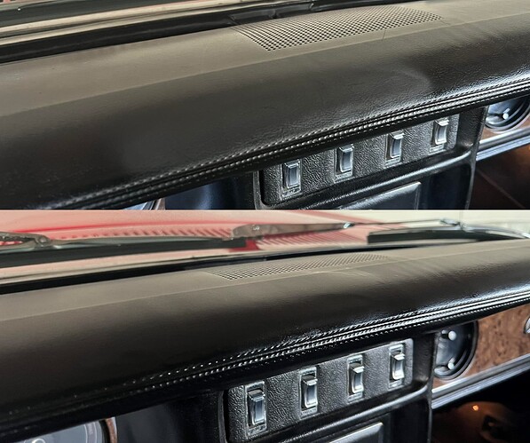

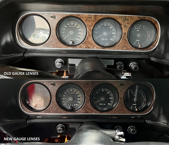

Thanks to all of you for your advice and experiences. Helped out tremendously. It turned out to be a VERY long weekend but well worth it (and actually not as bad as I thought it would be!):
- Changed out the gauge lenses…what a difference!
- Added new white/yellow LEDs and red diffusers (prior were Green LEDs with no diffusers). Goes great with my red exterior.
- Connected the door speakers.
- Painted the dash pad.
- While the dash was off changed out the signal flasher…tail lights work great now (previously left side was blinking as one/not sequential and the right was sequential but super fast):

To me it appears a lot less “harsh”.
Well, the green that were in there were just pure LEDs…not sure why there were no diffusers but that definitely helps…they were really bright…
That looks great! The new lenses really freshen it up!

I’m glad the white/yellow LEDs have the spectral content to work with the red diffusers. They look much better than the undiffused green. How well does your dimmer work?
The interior is looking really nice. What did you use to restore the sheen to your burled woodgrain?
Thanks man. As far as dimming, there is not much there. I think there are other Hi-Po lights (Elite or Elite II?) that have better dimming functionality.
I did nothing to the woodgrain actually (the difference in the darkness in the pic is just the lighting). I got the car about a year ago so someone really took care of it and it is original or they replaced everything…I lucked out! I am planning on doing some light sanding and got an Aluminum paint marker to clean up the trim parts on it (and the steering wheel hub).
