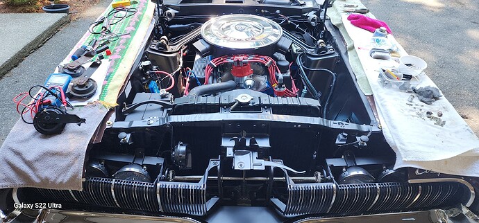

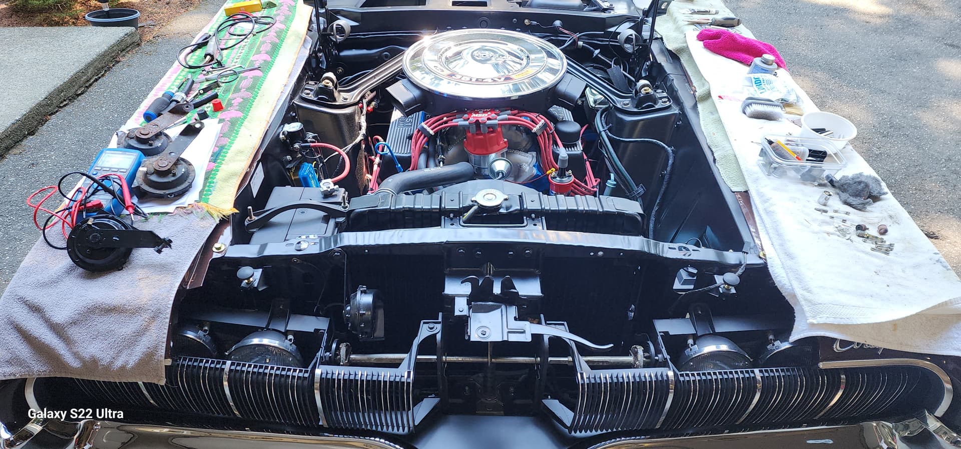

I’m restoring my 70 that i’ve had since1981. It was last driven in 2007 and the storage location was damp causing much corrosion. Its been a 4yr process and most every mechanical and electrical part has been serviced or replaced. I’ve just put the lower dash in and now hooking up all the electrical to look for gremlins. Fixing the corroded ignition switch has eliminated many
of the problems. I’ve just replaced the rim blow switch in the steering wheel as it gave up a ghost thirty years ago. I have full battery voltage at the horns and a good ground. The exterior of the original horns were thoroughly cleaned and repaited but they produce no sound. I removed four horns from two other convertibles that have been sitting just as long. I’ve cleaned the contacts and the grounding area and still none of these horns work. Do I have 6 bad horns or am I missing something simple.

The update is successful. I soaked all the horns in rust converter overnight. I flushed them the next day with simple green cleaner then blew them out with air. Then I gave each of them a good solid rap with the hammer where the bracket mounts to the actual horn. The 2 originals started working.The other four did not. Probably because they sat at least five years longer than the originals. Thanks for all your suggestions and quick replies
