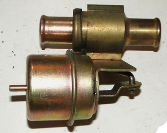

You should have a valve in the heater hose under the hood up against the firewall(usually gold colored) to shutoff the flow of hot water to the core. If there you need to check the vacuum going to it from the blend door valve. Usually with only air coming out of the defrost the vacuum system is not working. A long time Ford mechanic said the system was designed if the vacuum failed the default was to defrost to keep windows clear.
I do have the valve. I had it wire-tied closed before, like if vacuum was pulling. I cut the zip tie and it didn’t make a difference. I did notice both heater hoses were hot; not sure if the valve was functioning correctly if the hose behind it would have any heat in it or not?

Last night I started the car, the engine hadn’t been ran for the day so no heat in it. I turned the A/C on and it was colder than the night before because the engine wasn’t putting off any heat yet. I was thinking of pinching off one of the heater core feed hoses, but didn’t want to pinch the wrong one and risk damaging the core. I am going to order a new water control valve that goes inline to one of the heater lines. I thought about looping one of the hoses back, but didn’t want to mess with spilling coolant, topping off and then doing it again in a few days when the new water control valve comes in.

I ordered a replacement water control valve. Someone put it on the hose that comes out of the core and goes to the water pump. I read somewhere online that it goes in the heater hose that comes off of the intake manifold. To me it makes more sense to go in the line off the intake manifold. Can someone tell me which is correct?

A little late to this A/C thread, and for what it’s worth ( to future readers / searches that might want ) to see what the hot water shut-off valve ( stamped C9AA-18495-D / p/n’s C9AZ or D1AZ-18495-B ) looks like:
No problem on being late to the thread; I appreciate your reply.
Not sure if you saw in my previous posts or not but I did install a new hot water valve in the heater inlet hose.
