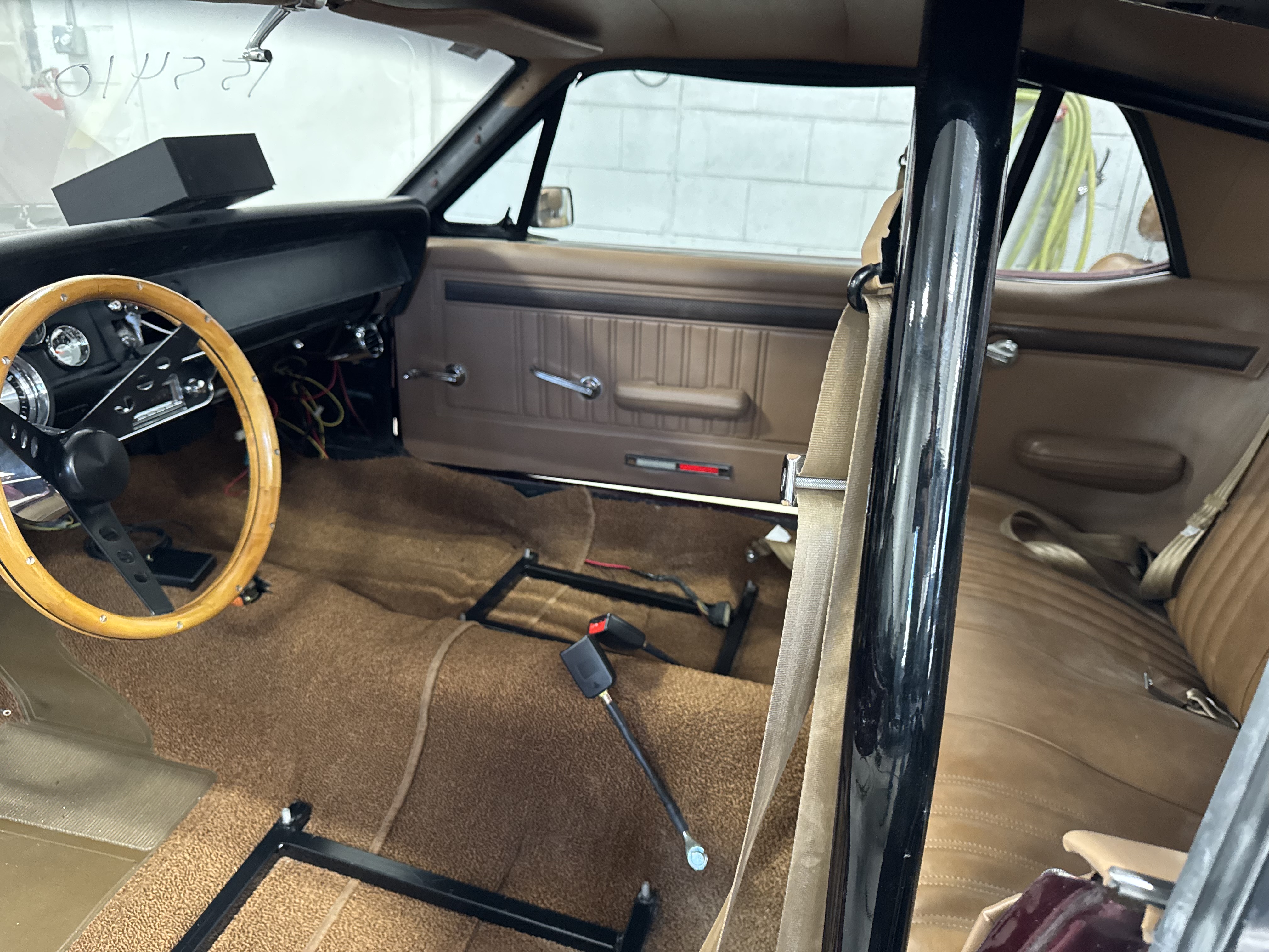

I used a roll bar with braces to the rear wheel houses. Part of the reason is I installed a pair of 2018 Mustang seats with lumbar, and when the test fittings for the upper mount were being done, determined that attaching on the roof brace, belt would dig into my neck, so the roll bar mounting was/is the solution. I don’t have a great image of it, but including one.
Best
Ron
PS, both my Daughter in law and sister in law have ridden in the back seat. No issues with the ingress or egress. Really glad to have the power seats!
Where did you source the roll bar? That’s exactly the kind of thing I was looking for.
Summit, part # Competition Engineering CEE-3039 roll bar hoop.
Braces AAF-ALL22642
Seat belts from SeatBeltsPlus.com
