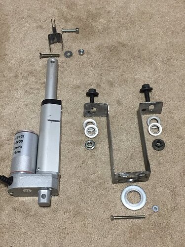

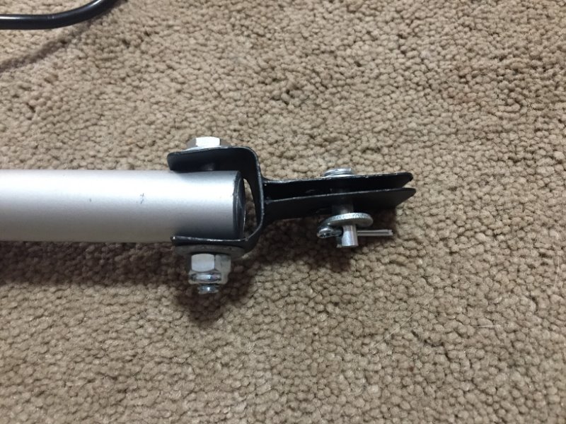

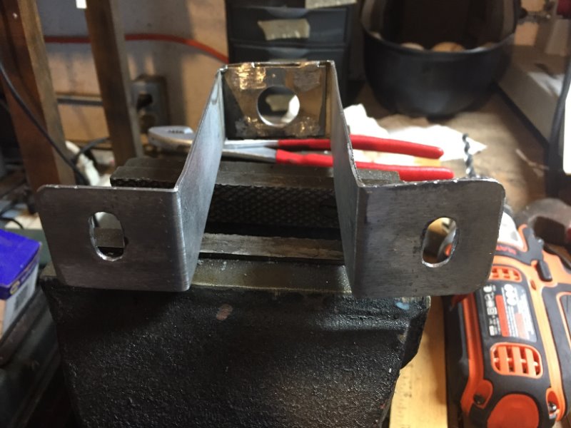

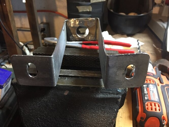

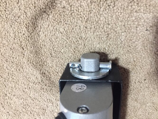

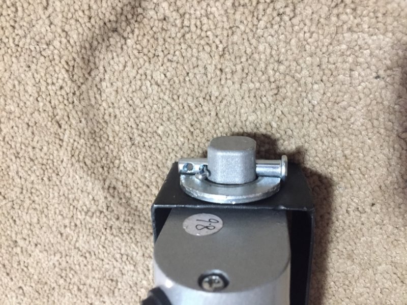

To get it working 100% I had to modify the bottom mounting bracket by elongating the screw holes. This allowed for me to move the actuator back toward the radiator so it would have a slightly different angle as it pulls. That and adding 1/4" spacers to the lower bracket, so it moved the actuator down a bit. In reality I could just make the bracket longer by that 1/4" but this was easier.
I picked up some dowels and cotter pins and will be replacing the bolts with those.
I’ll paint the brackets and should be able to install it this weekend.
If you wanted it to be more secure you could add to the bracket to catch the lower A/C condenser bolt, but I don’t feel that is really necessary.

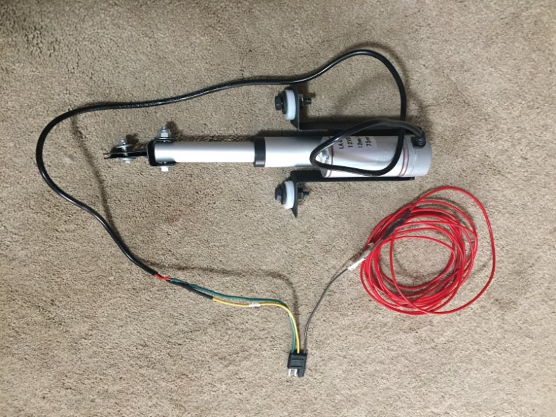

Below are some additional pictures.

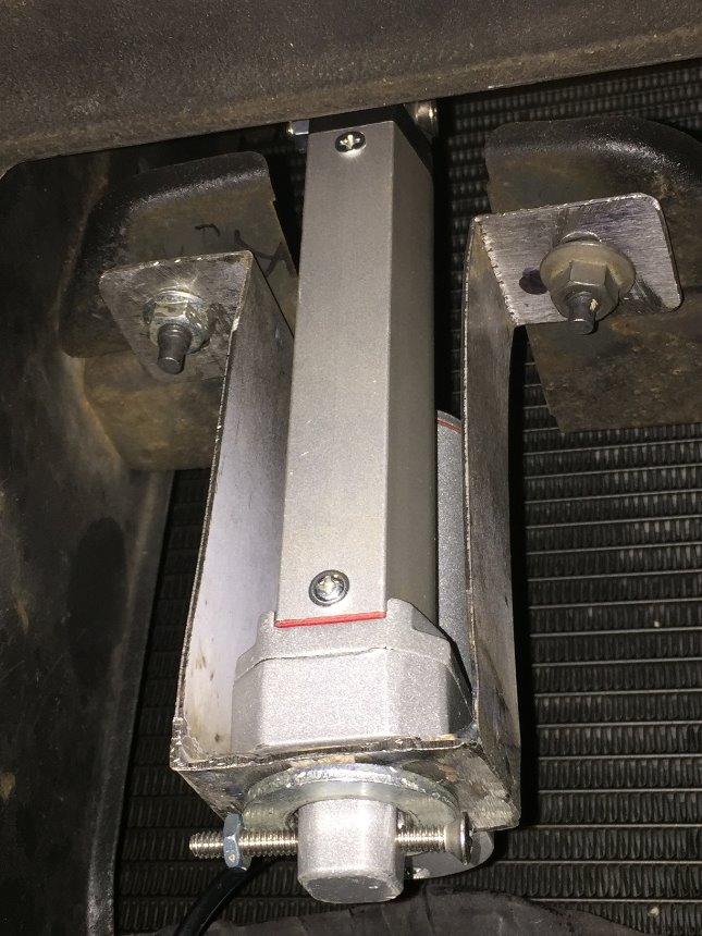

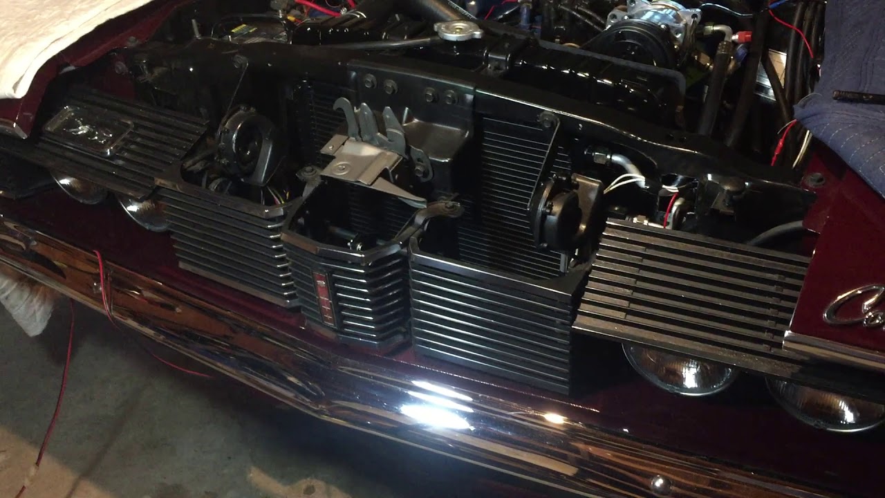

Well, it’s all done and installed in the car. :thumbup: :dance:
Here’s a YouTube video of it working when the lights are turned on and off.

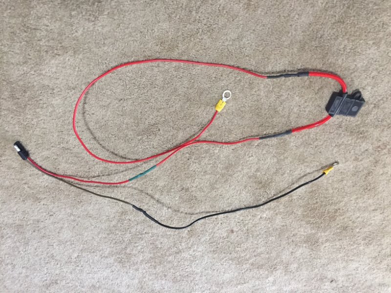

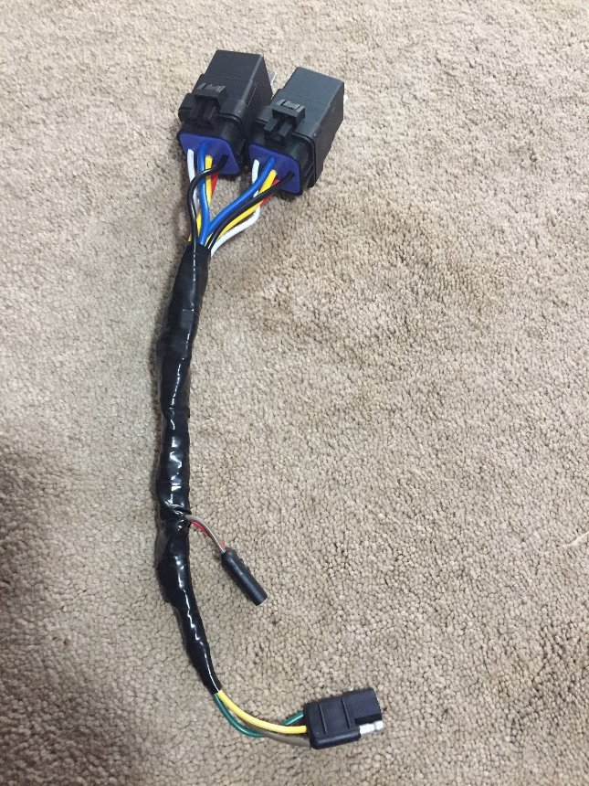

Wired the switch signal to the center wire of the floor mounted “brights” switch.
Attached the +12V to the starter solenoid input and ground was picked up on the chassis next to the radiator (battery side), that is also where I installed the relay harness.
I’m very happy with the results.
With that said, I did not remove any vacuum lines or the reserve tank, I just plugged up the two vacuum lines that use to go to the vacuum actuator.
I want to be able to revert to the original setup if things don’t workout or if some future owner wanted to revert the car to the original setup.

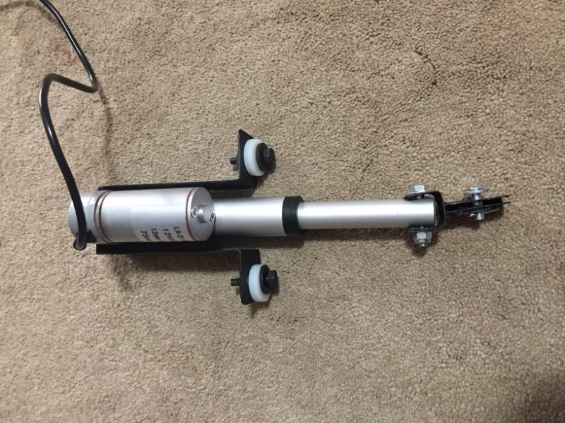

Here are some final pictures of the assembly…
