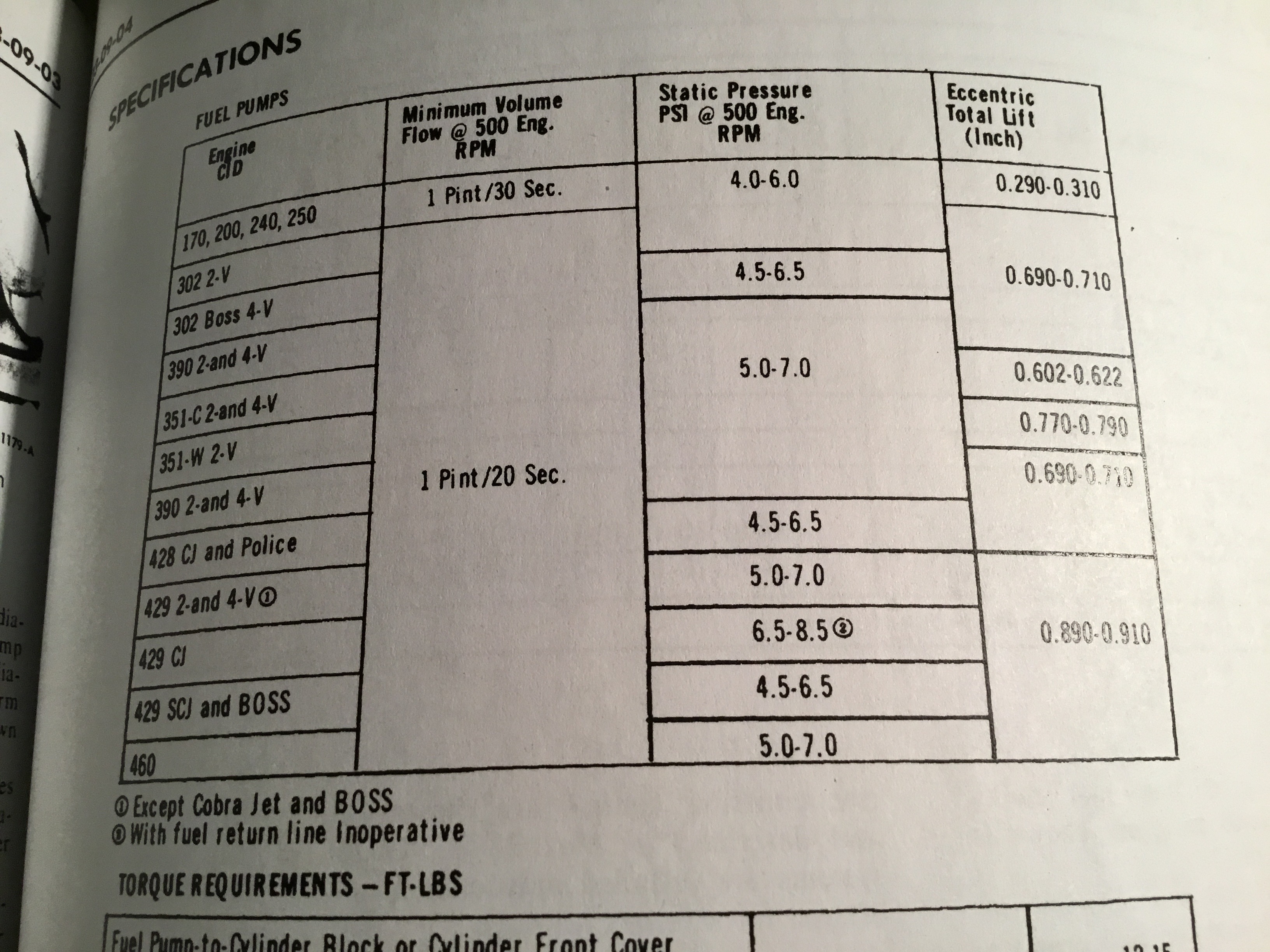

If you are seeing 12 psi fuel pressure, that’s your problem. Maybe those pumps all come from a common factory in China that has lost the recipe. Inmanlanier’s sugestion of pressure regulator might be the best solution.
Here are fuel pump specs from the 70 shop manual.
Thanks. I am going to pick up some extra fuel line to give room to install a regulator and the pressure gauge (will need to loop around). It is a shame and dangerous that mechanical pumps are putting out 12-15# when Spec’d at 4-6#. Good to have a regulator but shouldn’t need it. I will let you know how it goes with next test.
