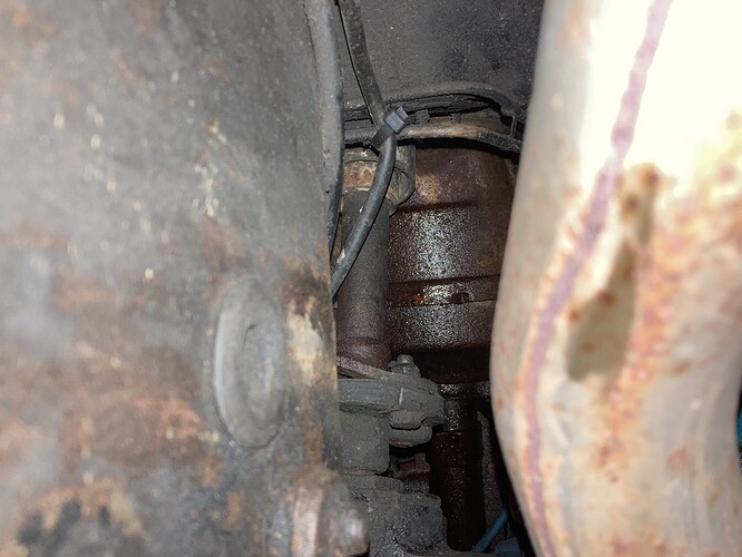

Permit me to up this thread.
I have a brake idiot light that stays on… I come to realize reading you guys that it might have something to do with this distribution block, however I still have brakes though the pedal is very very soft. might need to check that.
Also, I can see some fluid underneath the brake booster, might need to change both this and the master cylinder ?
