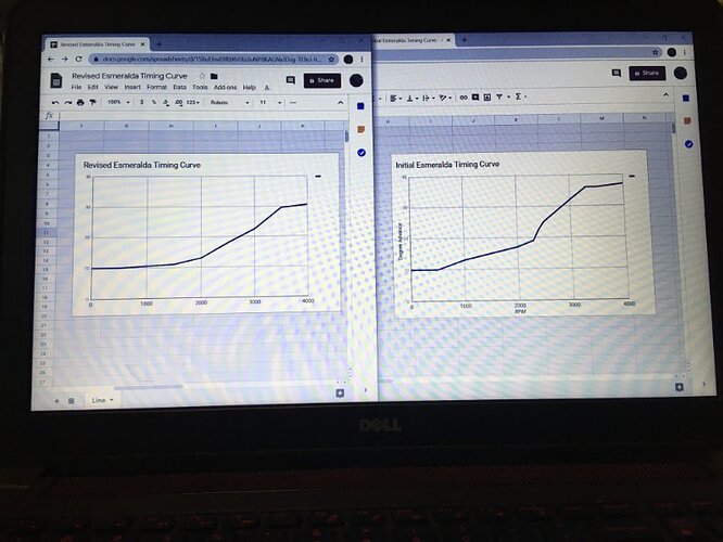

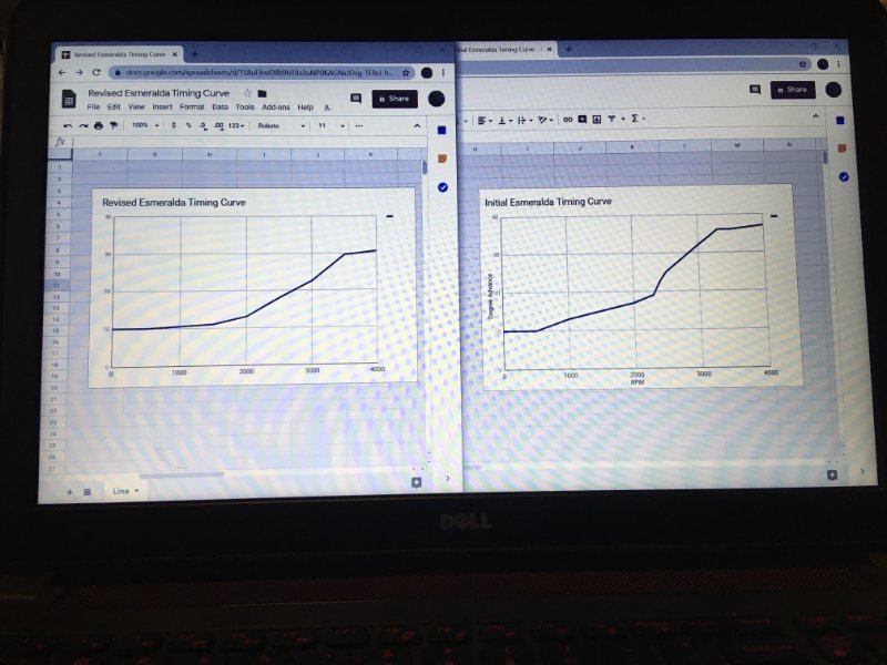

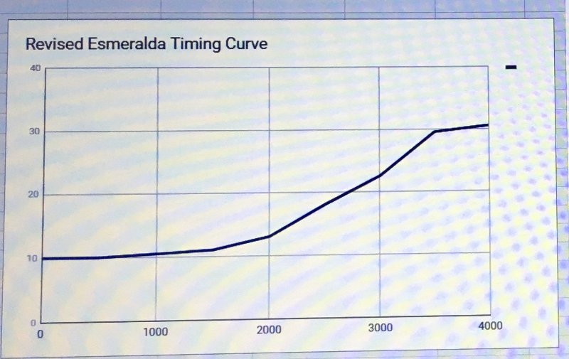

Here’s the curve before and after adjustments.
I believe we need to just get a better distributor.

Your screen shots are hard to read, but from what I can see the distributor is set at 10 degrees initial and 38 degrees total. That would probably work fine with good 1960’s mid - grade 95 octane gasoline. Unfortunately you are stuck with 92 octane.
What you need is an adjustable vacuum advance from Summit racing so that you can continue to run 10 degrees advance on initial, but limit the total to perhaps 34 - 35 degrees.
Also, the centrifugal advance is doing too much. There is a second position that limits centrifugal advance. You need to disassemble the distributor to make the swap, or use two of the heavier centrifugal springs to get the desired results.
