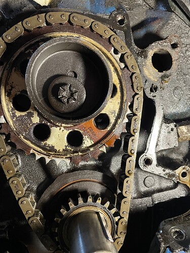

Dodged a bullet-Original Nylon Timing Gear
I knew I had some slack, but no idea it was this bad, or that the set was probably original to the motor!

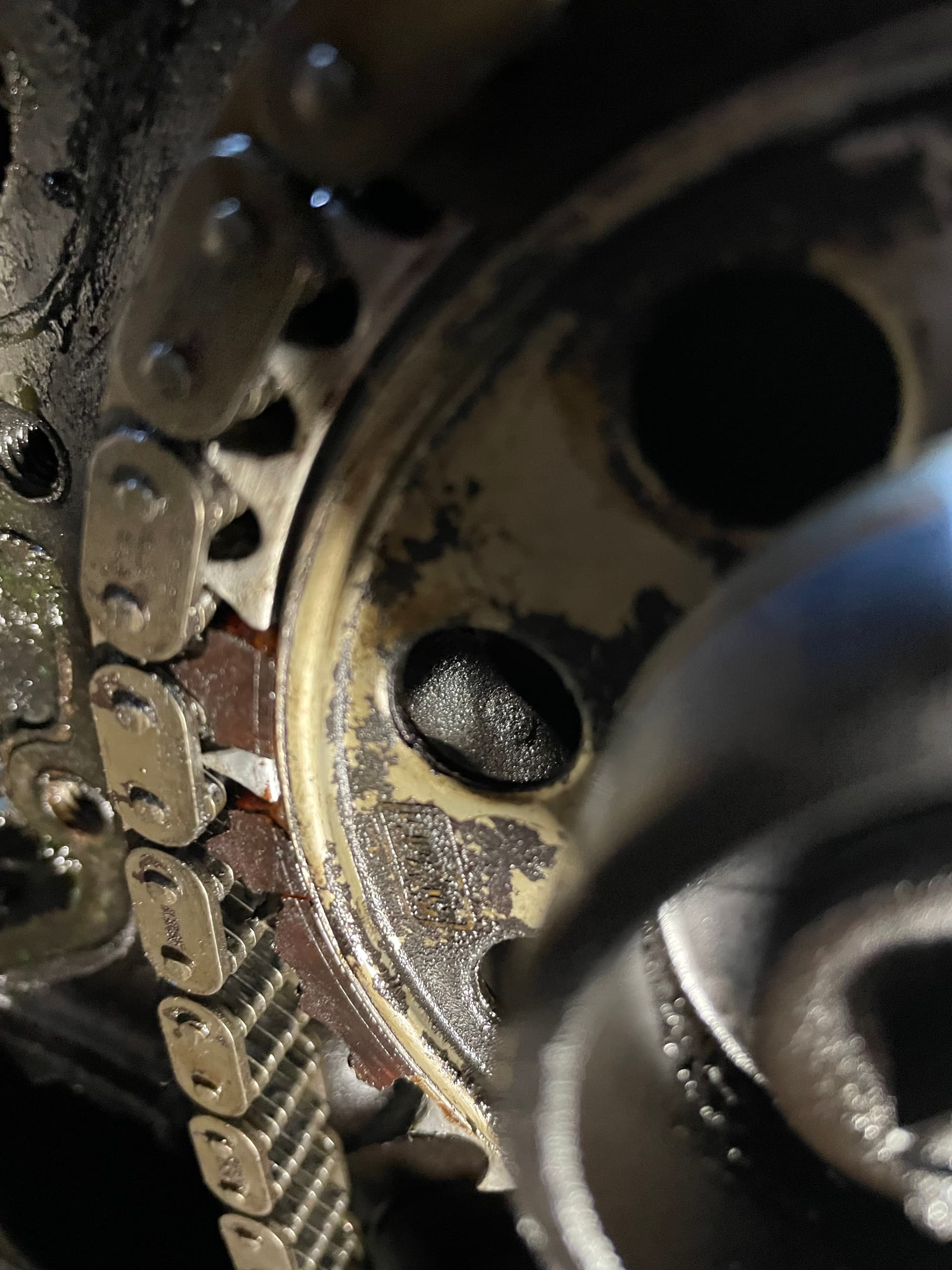

Getting ready to do just that to an engine never opened before…has about 15 degrees of crank movement before the cam moves
Yikes. Definitely time. Hah, I amused myself there…sorry.

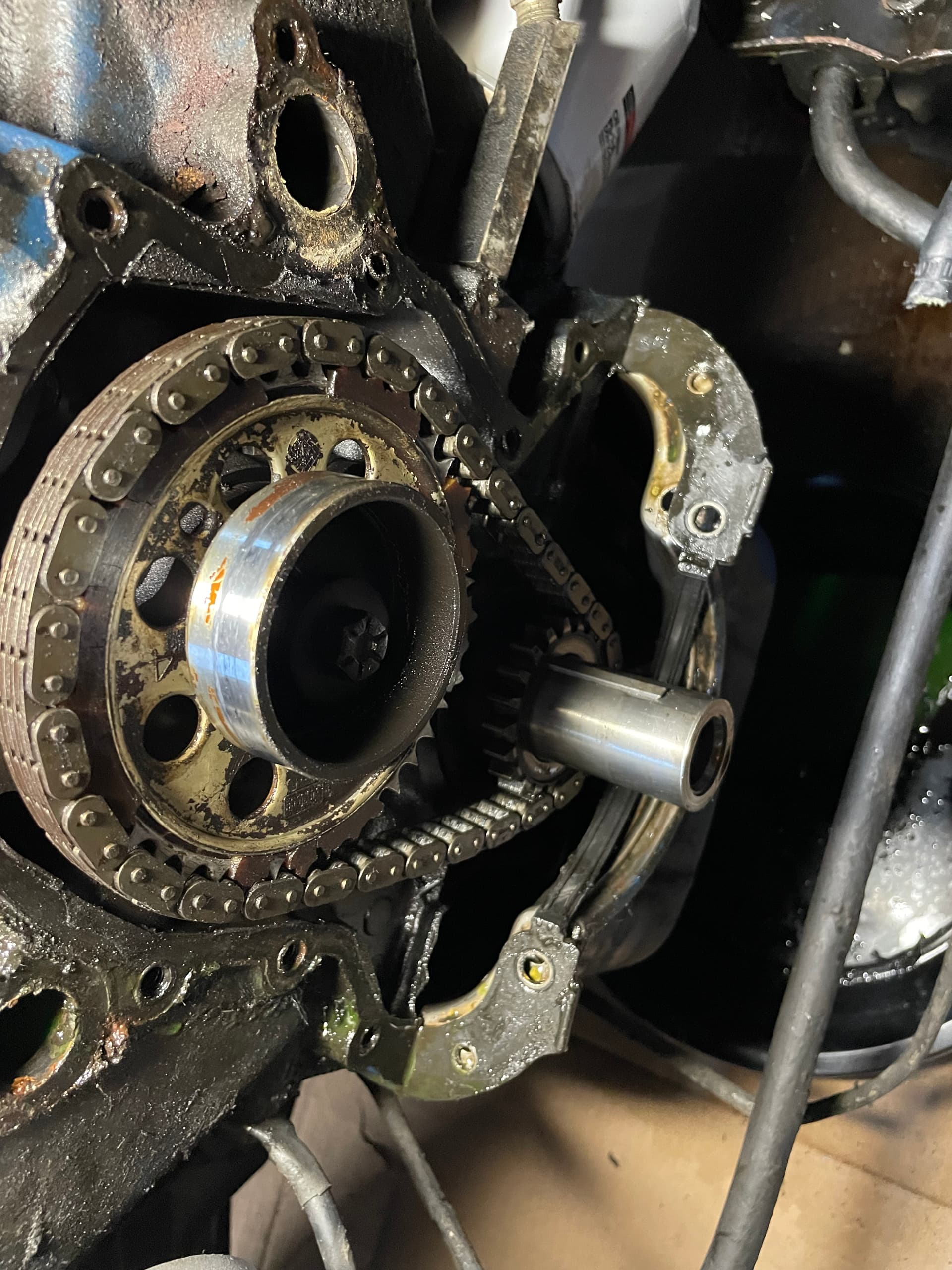

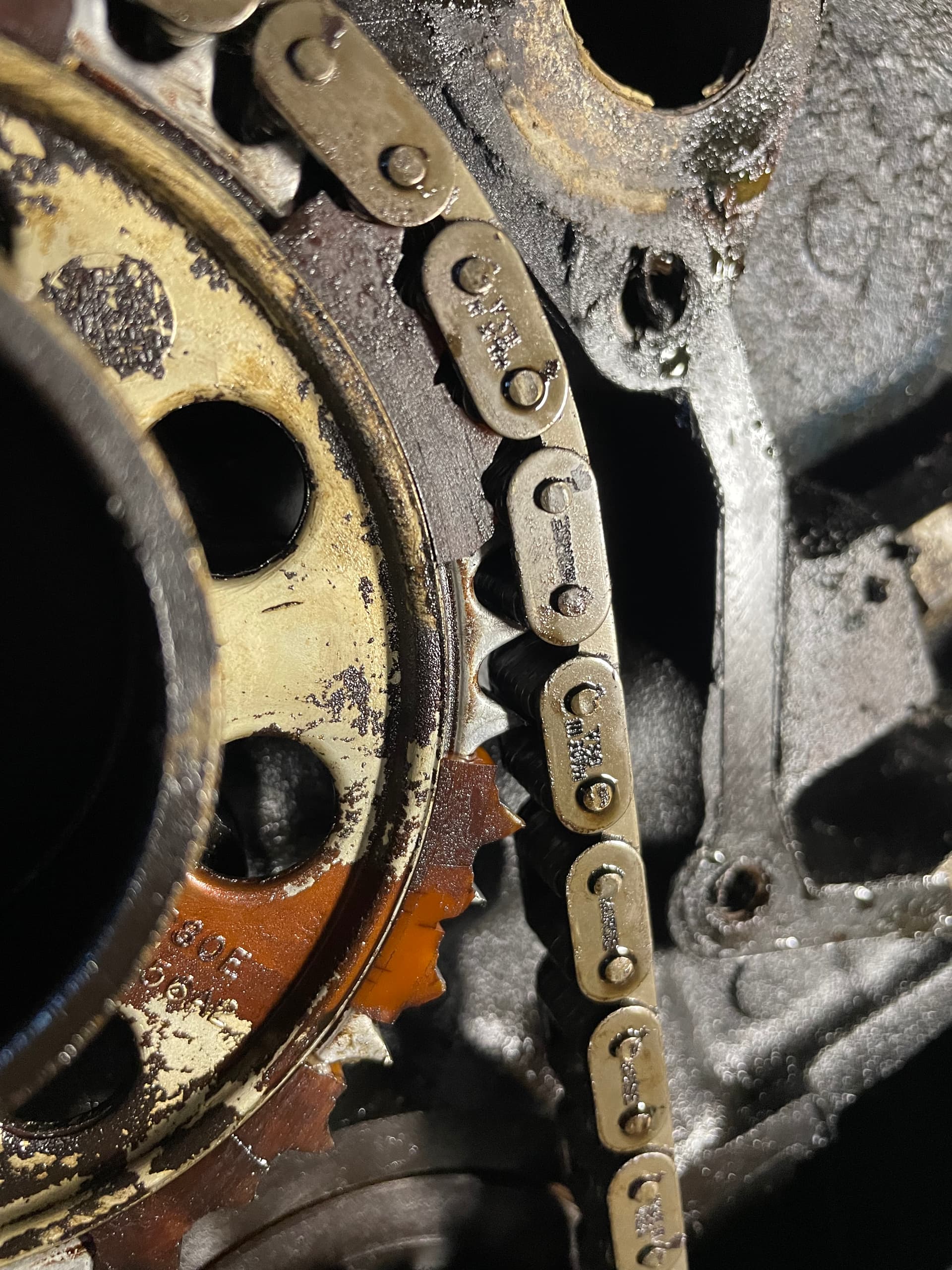

I had read that it was a valid test to check slack through the fuel pump opening, and did so when I bought the car back in 2021 and was replacing a leaky pump. From the pictures you can see that the driver side of the chain is under stress and it is the passenger side that is slack, so I was lulled into putting it off. I really do feel lucky it didn’t come apart when I was “exercising” the engine on backroads or the highway.

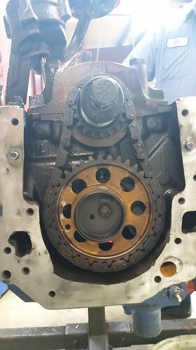

I fell victim to the same slack test, and was surprised how loose the chain really was when the engine was opened up. But my phenolic timing gear looked like new compared to yours.
Now you have to take the oil pan off & clean the teeth out of the oil pickup. Its easier to buy a new one than to try and clean out the old one.
The pan leaks as does the rear main, so they were already on my list. I hadn’t thought about the pickup mesh, so thank you for that tip.
