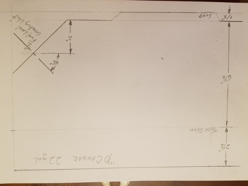

First the geometry of the fuel tank (repro) was represented on a drawing and it was used to map out sender location, range of motion, and pickup positions to establish some of the limits of the several available fuel sensor/pickups (see list below).

Jayco59,
Here is my mapping of the 1970 22 gallon tank. I don’t know if the '69 is the same.
Upside down but usable.
Looks OK to me
Thanks “70XR7Tom”. My tank seems to be an 18 gallon tank, but the shape is similar.
The dimensions are probably different, since it’s 4 gallons smaller.
Upside down is perfect, that’s how I see the tank when I’m under the car! ![]()
Jay
