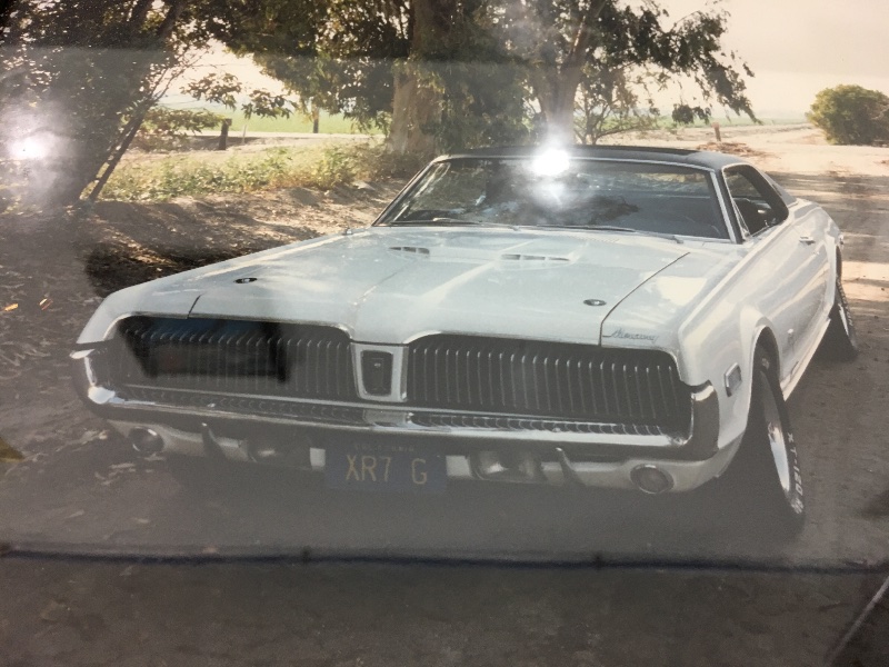

Funny you should say that. My first G that I restored some 35 years ago I also put the barrel type hood locks on mine
I remember that car
I bet you do Chris!!! Did you ever end up replacing the hood pins or find a side view mirror?

Zogman-never did replace the hood pins-they worked fine - just drove it and enjoyed it before we parted ways.
