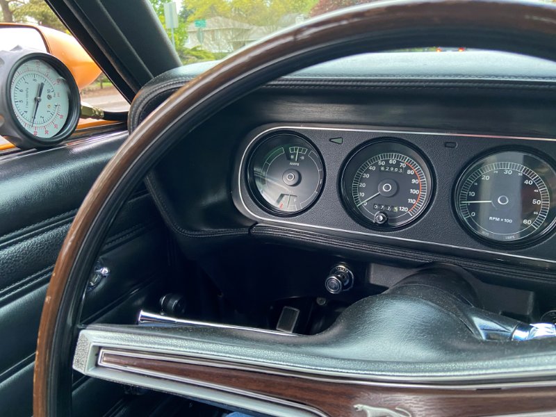

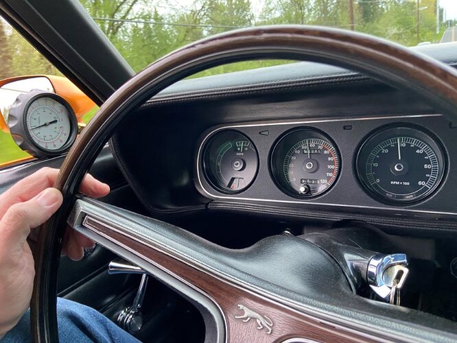

Ok, got my mechanical gauge on the car and did some testing / driving.
Cold, idle / 1200rpm, pressure was about 67#
Warm, idle / 600rpm, pressure was about 45-50#
Warm, 2500-3000rpm, pressure was about 68-72#
Seems like the mechanical gauge pretty closely matches what my dash gauge was indicating for my original sending unit after I changed the oil & filter. (That cheap replacement sending unit moved, but was reading very high all the time, which tells me it’s trash).
So, is 75# or so at high RPM something I need to worry about? That seems to put my dash gauge up close to - and maybe just inside - the high box (where it never used to go).

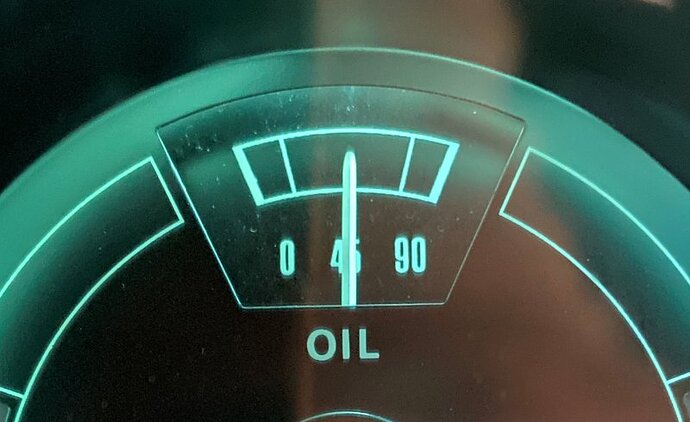

Got my meter tester from Bill last night and did a check of the oil pressure meter. Seems pretty ok to me!
Max is just under the max line, min is just above the min line, and mid is right in the middle.

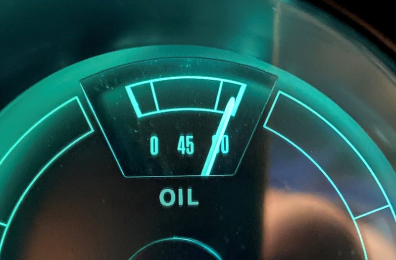

Looking back to your first picture it looks like you were possibly hitting 80 or above
It sure does. Yet the mechanical gauge never went above 72# which would be the very lower edge of the high box. Seems smart to run both gauges for awhile as you are planning. I’ve sure been watching my oil pressure guage a lot closer now.

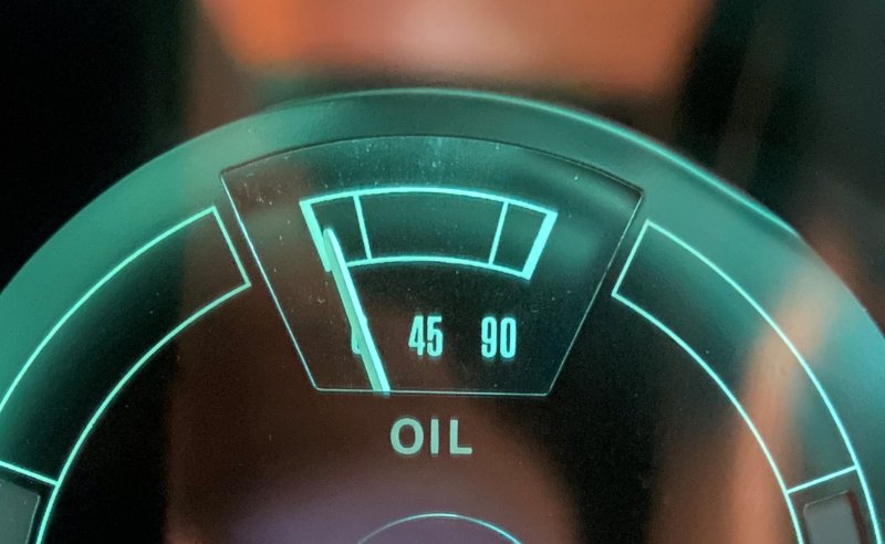

First parts store unit pegged to the high end immediately.
NOS Ford Sending unit never moved off the low peg.
