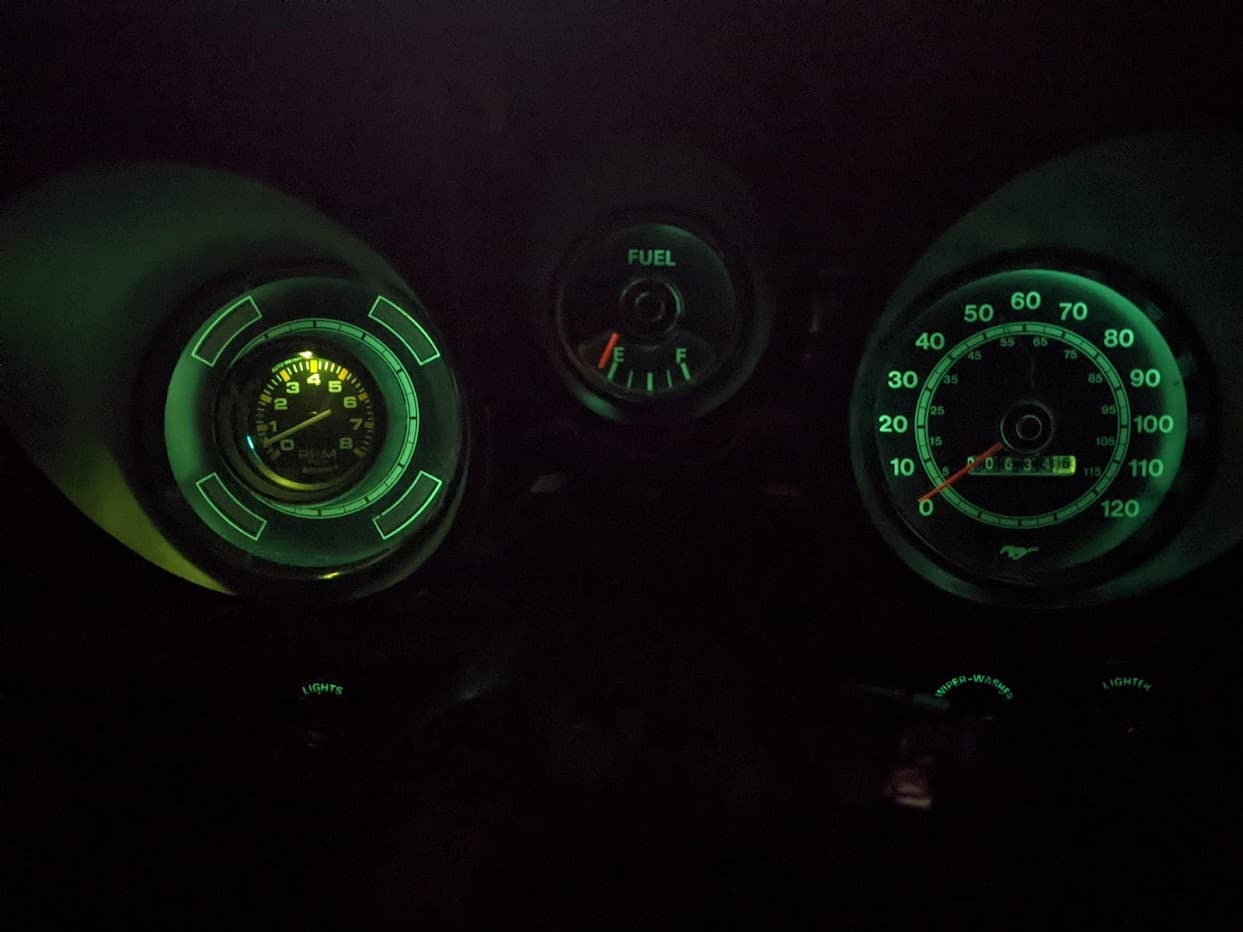

I used gloss white spray paint when I refurbished the gauges on my cars. Replace the melted diffusers and install new bulbs. Pic is from my Mustang. My Cougar’s gauges are lit from the front.
