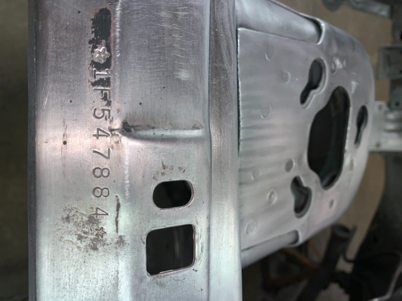

The vin stamps on the shock towers will tell all…
On a 71-73 car it’s easy to change the dash vin tag since it’s just part of the dash pad/not riveted to the body.
I assume a true body in white may not be stamped. You need to remove the front fenders to access the vin, although sometimes you can read it from underneath.
Also a real 429 body shell will be set up for staggered shocks. I am currently restoring a 71 429CJ xr7.

Yes, that will definitely be one of the “clues” I was going to look for. If the story is true, it will be factory spot welded shock towers without a factory VIN stamp. The Marti-report shows this car (that VIN) was originally ordered with the GT competition suspension which I think would have come with staggered shocks. So, if it was not body swapped, I think it still should have the staggered shocks.

Bodies in white do have VIN stamps but they are not like the original VIN stamp. Body in white VIN’s are just a number. No information will be on the Marti Report for options so you may have a real problem.
If the unit body is really from a Body in White then the VIN won’t match the title. That would make ownership illegal or at least very questionable for purposes of operating or licensing. I would want to nail down that question before investing any time or money.
Nah. It has been titled and registered since new. Many Mustangs no longer have their original aprons or apron VIN stamps. I’m not worried about it at all. Also, it is my understanding that BIW cars come without VIN’s, titles or COM’s.
