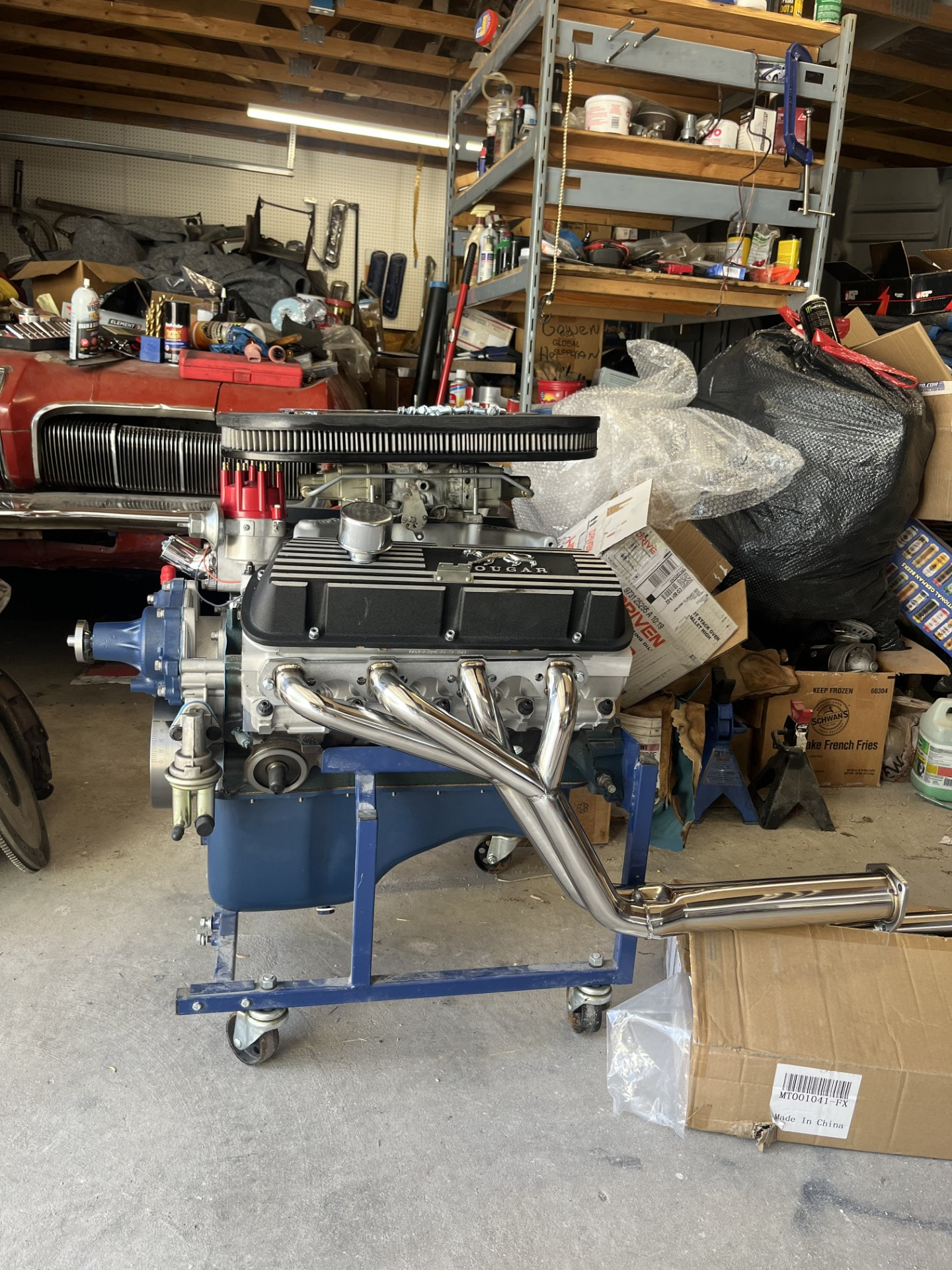

Excellent! Thanks for posting this! I’m not opposed to not changing everything that goes with the upgrade, and this would help the car “look” original. The engine going in, has flowtek heads, and a Comp cam, at .500/.500, with a 3.55 rear gear. This sounds like the best of all worlds.
