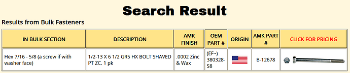

Looking through the MPC for the front eyebolt ( 380328-S ) I found it is the same hardware # from 1967 through 1972. Here is that bolt from AMK:
according to AMK it’s 6 1/2 " and $ 8.00 each.

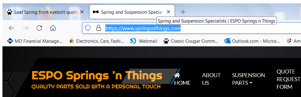

What is ESPO?
Is it this ? https://www.springsnthings.com/
5-1/2 inch bolt is correct starting in 1968.

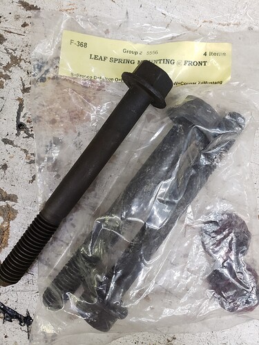

To add to this. Ive found a flange bolt was used in 69 & 70. In pic the orig is on the left with a pointed end, possibly to aid installation. AMK
offer something close,tad shorter, no pointed tip AMK# F-368
