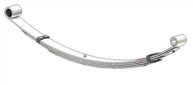

So I’m trying to find a replacement for my stock leaf springs on my 68 cougar GT;
I’ve seen a set on RockAuto rated at 670lbs .. 4 leafs, free arc 9 1/4; 85 lbs/inch .. Is that a good candidate for a big block car? I have no clue.
I obviously thought about WCCC but it’s over a 1000 bucks with shipping..
I’ve seen a set on summit aswell but they seem too weak.
Any advice would be greatly appreciated!
Look up 66-311 .A local US company supplies them. Are they US made?

Ive used these for many restorations, suspension replacements & have them on all my Cats, 67 XR-7, 2 - 69 XR-7 convets, the “restomod” track cat, and the 70 428 CJ 4 speed (now 5 speed). Correct ride height, no rough ride & and no sag.
I always try & find best product & price for the group!
The new ones will be disappointing. My experience is they will either be too high or too low. If your springs are not rusty you should take your car to a spring shop. Have the rear leaf springs rebuilt and re - arched to your desired ride height.
I can back Bill on this one. I have a set of GS 66-311’s, and they appear to be dimensionally correct ‘improved handling’ springs for 67-70 Cougars. I can’t speak for 1971+, but the 120 lb/in spring rate is a big improvement over the ~85lb stock spring.
Mostly people use the SRI spring codes. 66-271 is tmk the correct SRI code for 69-70 improved handling 120#, 1.2” pack thickness springs. 66-251 should be the correct 1968 GT spring - the leafs are a little thicker (.32 vs .30), and the spring rate a little higher. I found GT springs a bit harsh for street.
Take care on the link and part code. GS have been showing ‘no stock’ for a while. I would just call GS. I thought these were made in Kansas City, but cannot be certain. Alternatively you can try ESPO or EATON or Stengel Bros. ESPO makes the WCCC springs.

So now I know the correct kind of leafs I need. I hope GS can have more in stock soon. I’ll keep an eye on these!
I’ll for re-arching them aswell, they don’t look too bad even for 58 years old springs
Just a bit of caution there. Once you remove the springs & the rubber isolators, you will most likely find rust has eaten away at the spring where the rubber isolators lived. Trying to rearch them is not a good idea.Thats why I strongly suggest buying new instead of rearching. Its getting toughter to find any shops that will do things like in the past.
