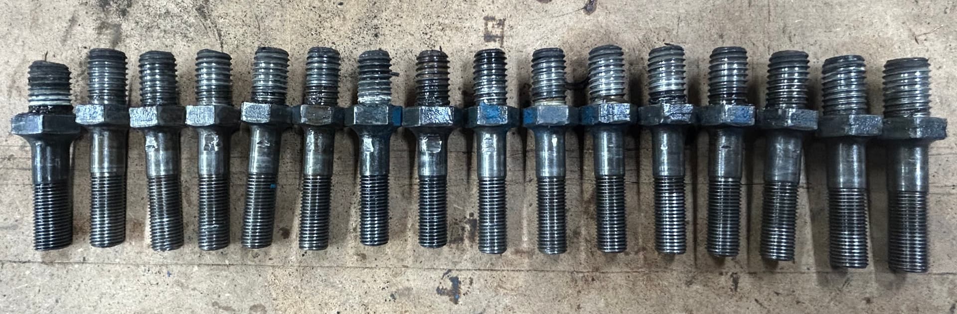

Now I find poor rocker arm alignment
The studs are screwed in so guide plates are probably in the future
Or bent push rods maybe?

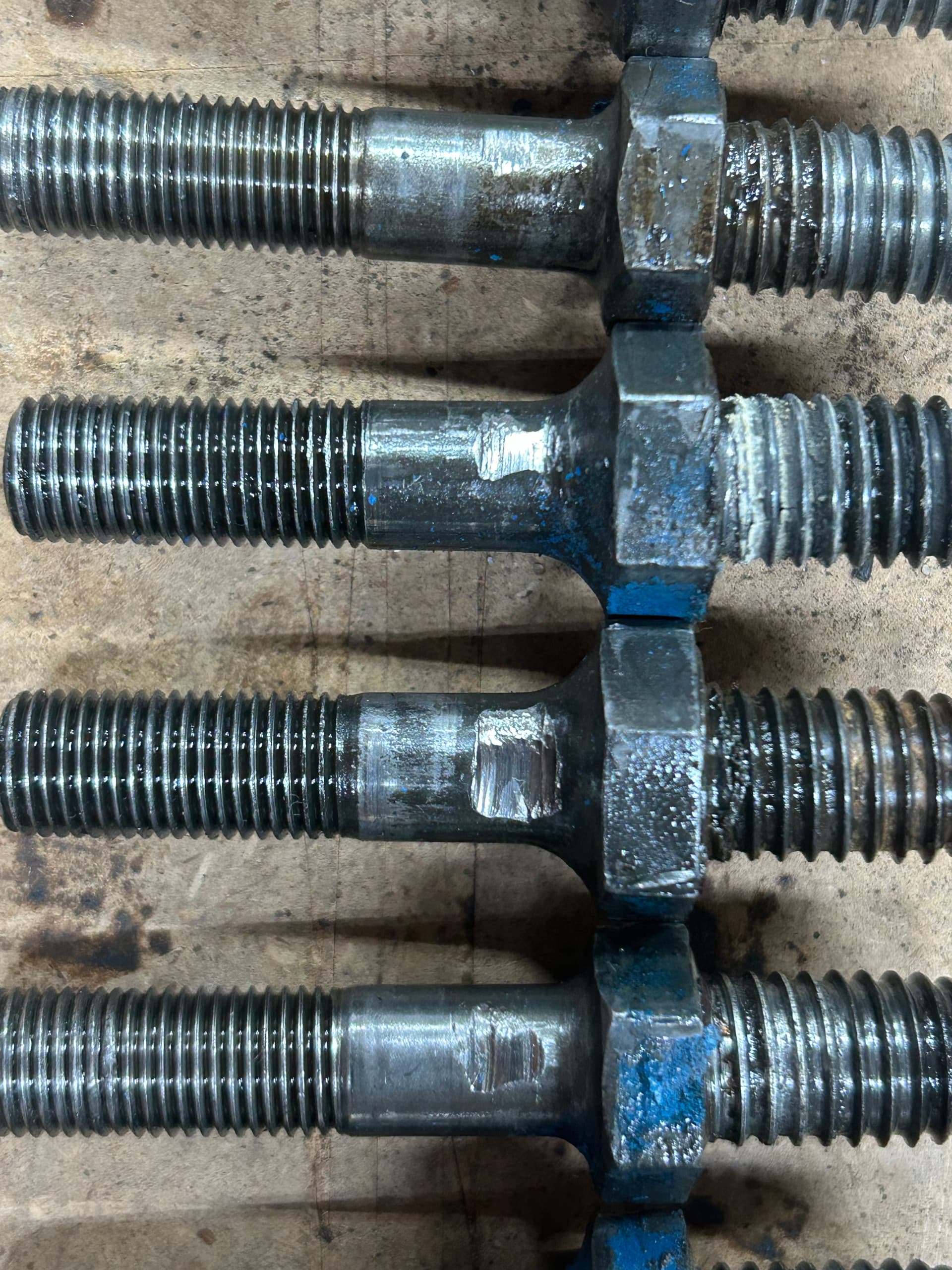

Well this doesn’t look good
Funny wear pattern inside the rocker
And then it gets worse. The fulcrum has worn a deep groove in the stud.
So new steel roller top rockers and studs wit a set of guide plates is on order
Was it the use of non rail style rockers in a rail rocker type head?
Not this time. The heads are 64 casting and modified with screw in studs. Rockers look original and no rails. I can see some wear in the guide slots.

It makes sense now and seems that there was too much clearance on some of the rockers with the smaller diameter studs. Likely it never had full lift on those valves compared to the others. I wonder if there is another engine out there with the other studs that were ment for this engine.

If that were me I’d mock the studs and rockers up again and measure the pushrod length. Also double check the stud location. I had one machine shop drill some cleveland heads wrong angle and make a huge mess. Also had a 283 that was drilled something like .050 too far outboard and chewed the studs like that.
