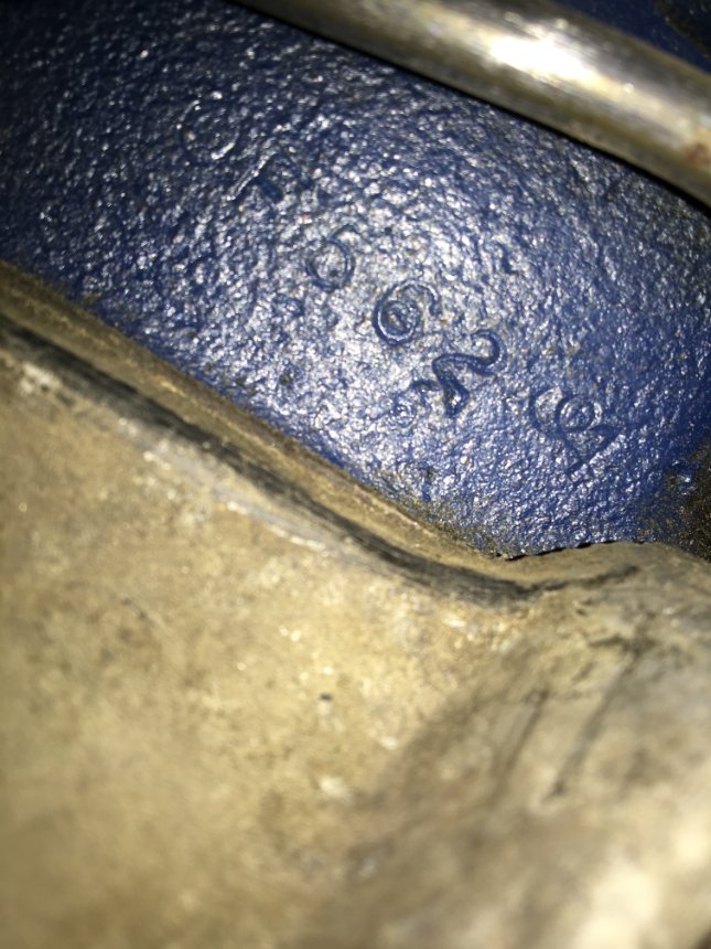

On the back of the block just below the head on the Drivers side. Here is a picture of my 351C.

Dennis, it IS possible to view the engine VIN stamp with the engine installed. Try using a mirror tool, or even sticking your phone back behind the driver’s head and snapping some random pics, or taking a short video. It’s not easy, but can be done.
This one I spotted with a mirror and then used my phone to get a good shot of it ~ plus I had to do some cleaning of the area. I had many garbage shots before I got this keeper.

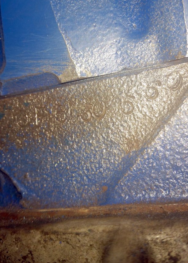

Mine is also a 70 M code, and had a weak stamp. I had to move the transmission vacuum line and the kickdown rod to get my phone down there. Still didn’t see it until I wire brushed the area with lacquer thinner. Thanks to everyone here for helping me find it!

While you are crawling around your '70 M-code / Cleveland engine, take a look at the front passenger side of the block on the machined area next to the timing cover. There you should find the engine assembly date stamp. This can be an easier option than pulling the starter to view the block casting date and can be useful when trying to determine what parts are original to your engine (original parts will typically have date codes approximately 4 weeks earlier than the assembly date of the engine).

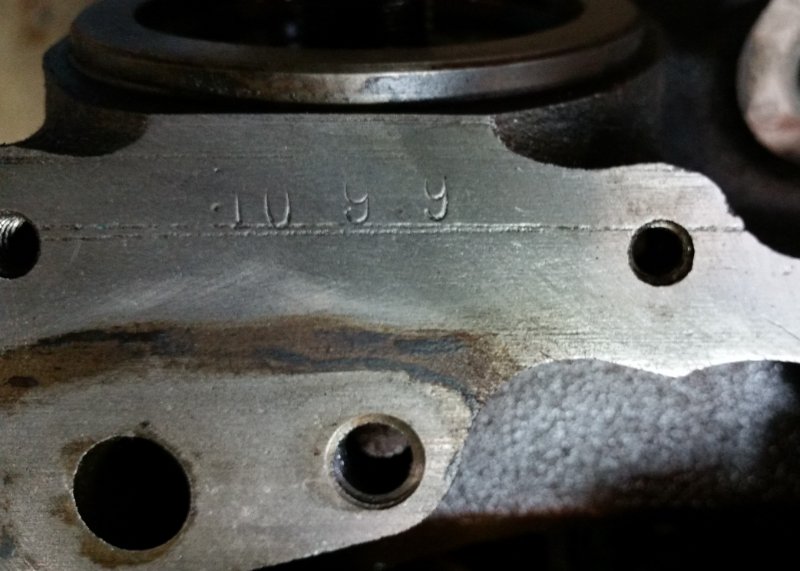

Yes, and there is also a machine date stamp under the oil pan gasket.

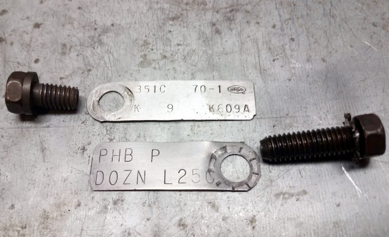

On my car, the dates all fit together like this:
Intake manifold casting 9J20 = Sep 20. 1969
Oil pan bottom stamp 9 24 69 = Sep 24, 1969
Head casting 9K2/9K8 = Oct 2/Oct 8, 1969
Block casting 9K7 = Oct 7, 1969
Oil pan block stamp 10 9 9 = Oct 9, 1969 machining date (which agrees with the K 9 date on the engine tag)
Front timing cover block stamp 9L21 M = Nov 21, 1969 engine assembly date, M code
Transmission tag L25C = Nov 25, 1969 assembly date
Like Mike says, most other original engine components are dated in Oct and Nov 1969
