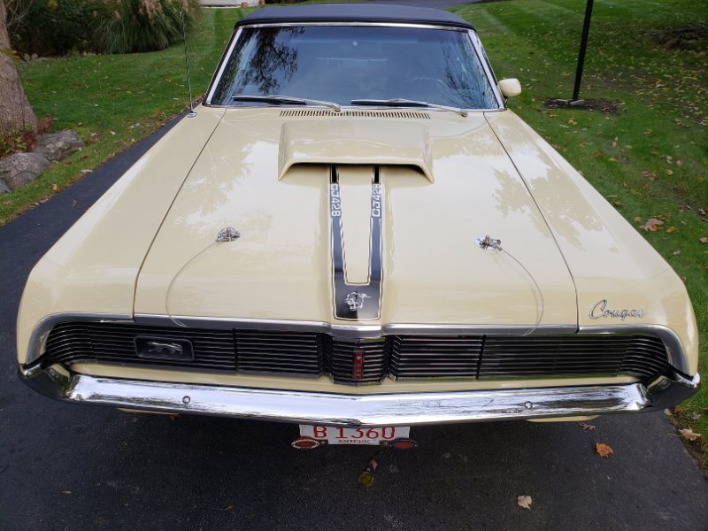

So it’s a month later and what has gone on? Well I started cutting in the dark green and I do like the way it looks! I finally got my Marti report and it is a lot rarer than I expected. I knew it was one of 504 Ram Air cars made that year (and yet Hemi Cuda’s are more desirable!) Out of the 100K production in 1969 it was 1 of 3 that had the 428 Automatic, Light Ivy Yellow with the Dark Ivy Gold interior. Yes, I do hate the pale yellow color however some of my Cougar neighbors (you know who you are) have convinced me that the heinous color is not as bad as I feel it is and that it’s rarity makes it worth keeping that awful color. As I stated earlier, how many of the 3 built are still left, so on that I will keep the original color. If nothing else painting will be a lot easier! Next time I will post updates on what mechanically I have been doing over the last month besides vacillating over the color.

Can’t say enough how I would NEVER have picked that color combo. None the less other “Cougar Aficionados” have pointed out it is most likely the last of that combo left and I should keep it the way it was especially considering that I have the build sheet, buck tag and Marti report. Believe me it is not a decision I have made lightly. I will keep everyone posted as to my progress, It’s a long winter and I need to keep occupied!

So I got the car back from the painter and it looks great. Now it’s at the mechanic for; steering issues, an exhaust leak and a few other minor issues (yea 30 years ago I would have done it all myself). As I understand the paint has to cure for 6 weeks and then I can get the vinyl top installed, should have some pics soon!
