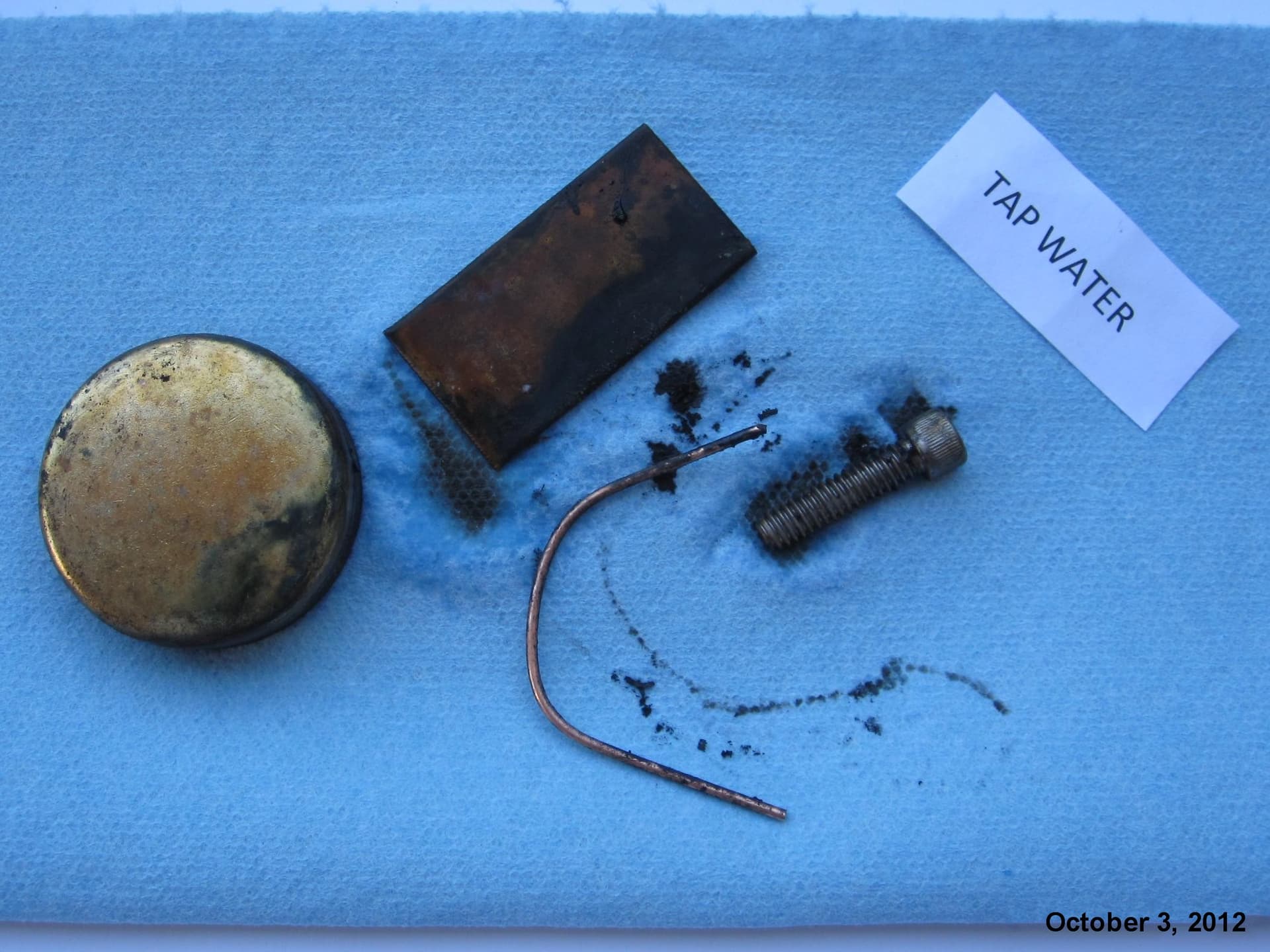

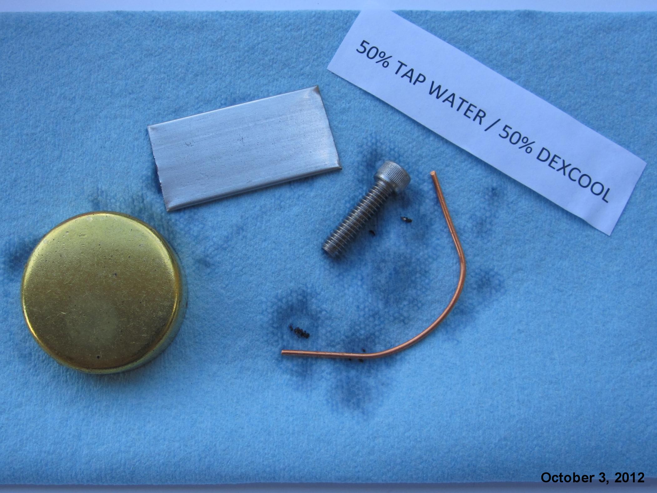

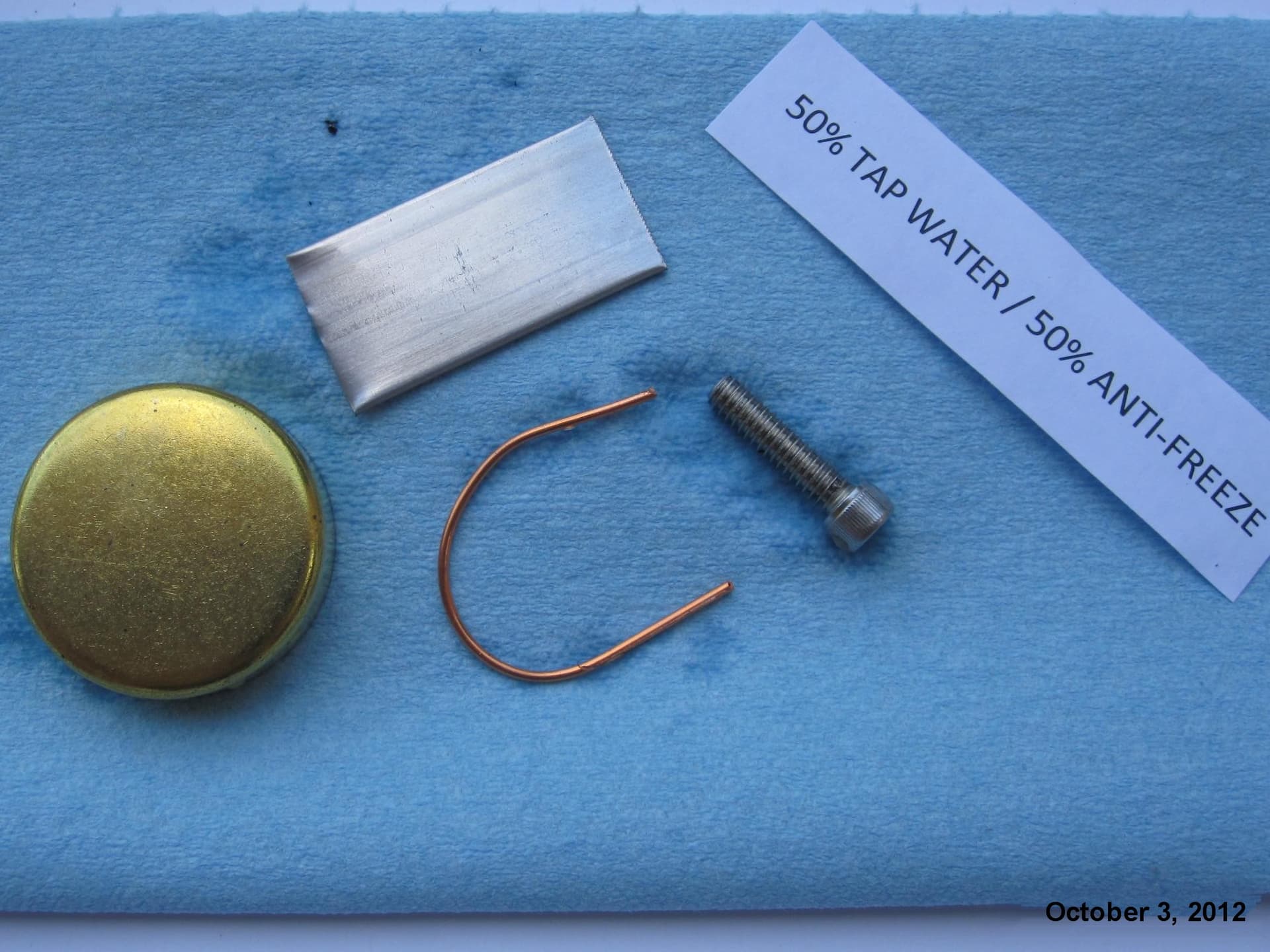

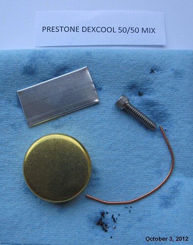

Ron Davis Racing Products builds very high end very effective aluminum radiators for race cars. Several years ago Ron hired Tony Candela to do the research into problems with galvanic corrosion in his radiators. This was a long tern study to see what worked.
While they did do measurements of voltage and many other factors one of the easy to understand tests was simple. Put samples of aluminum, steel, brass and copper in different solutions of coolant in sealed glass jars and then see what you had a year later.
The first is straight tap water. Not good.

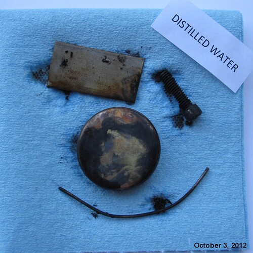

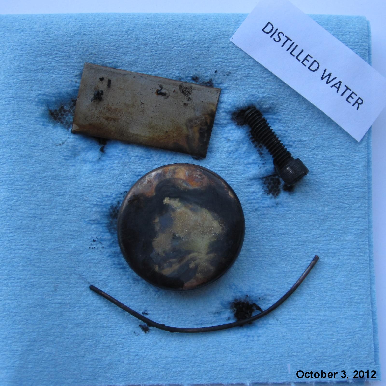

Distilled water seems even worse.

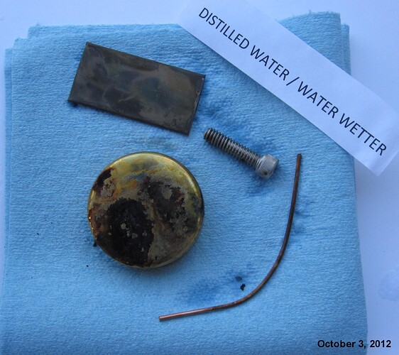

Adding Water Wetter did not help.
Then Prestone Green mixed with tap water
Dexcool Red with tap water

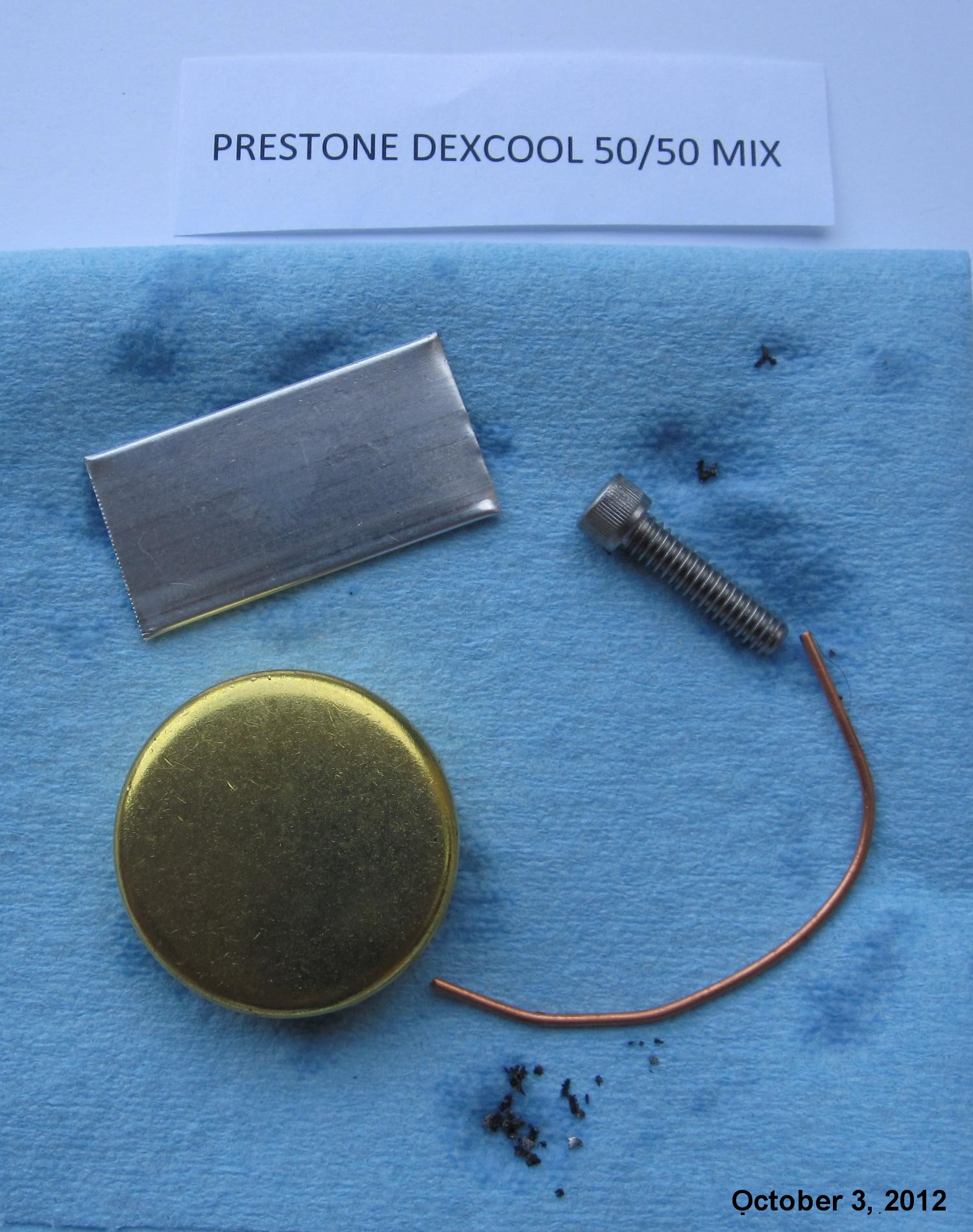

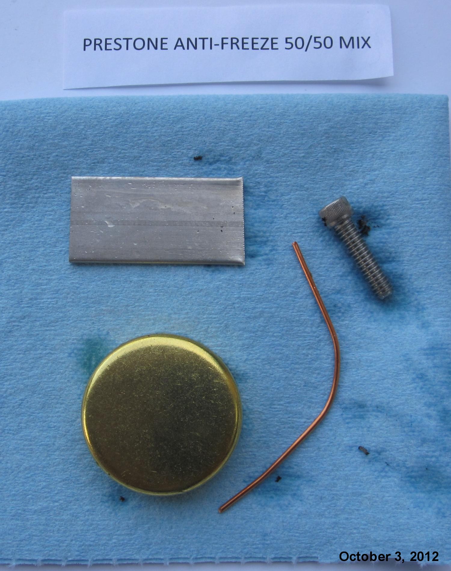

Since the make up of tap water varies greatly from location to location they wanted to see how premix would compare. From the testing this produced the best results. The thinking was that the water is actually a very specific blend and definitely not distilled water.
Prestone green premix
Dexcool red premix
