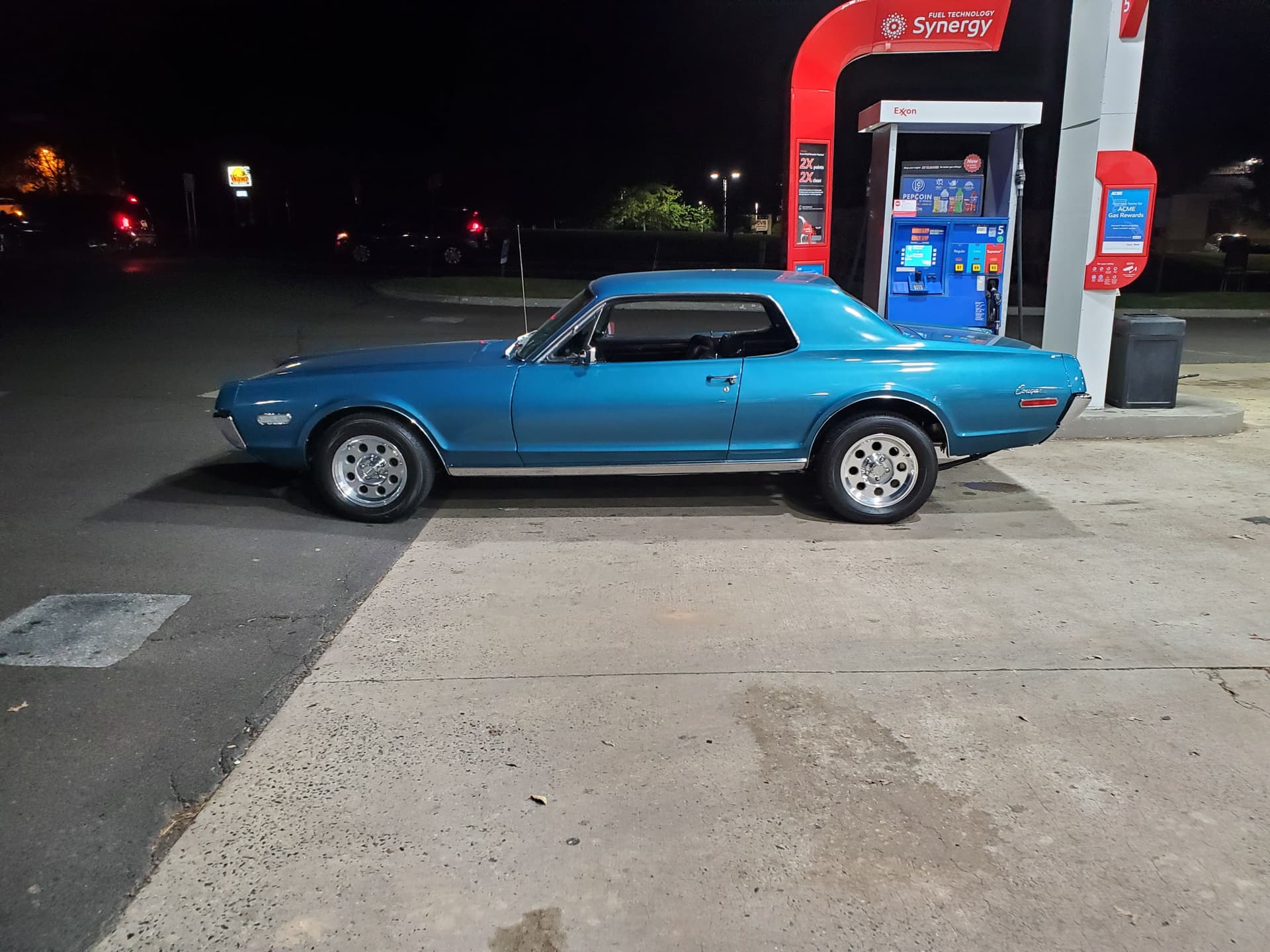

Sorry I’m so late replying, but I would advise against buying the ESPO springs with the 1" lift. Here’s the result on my 68. The 1" lift was way too high and I ended up installing lowering blocks to get the car back to sitting level. For reference, the front has the common aftermarket “600” coil springs.
Thanks for the reply MFC133. Your car looks awesome. I purchased coil springs with a one inch drop from WCCC. Would you still suggest going with the 1” lift on the rear leaf springs? Will that level out the car or put the rear end to high? Does that make sense?

I’d go with stock height leaf springs, no lift. In the above picture my car has the 1" drop in the front and 1" lift in the rear and you can see it sits way too high.

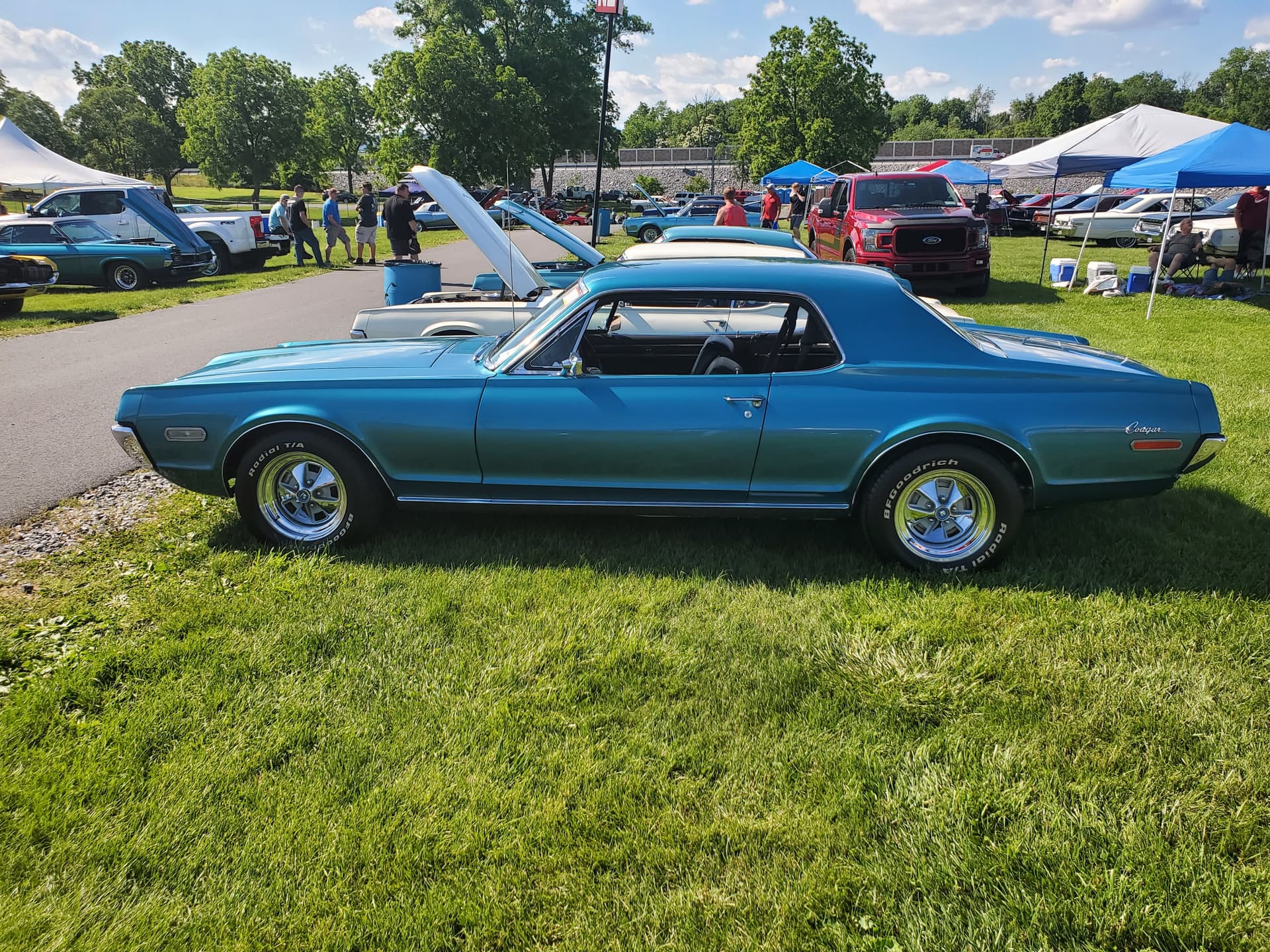

Here’s another pic of the car after I put 1" lowering blocks on to try and level it back out.

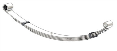

This is the “imporved handling” It fits on all 67 -70 Cougars and will not change the original height.

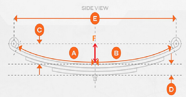

Bill, thanks for posting the link for the rear springs, the timing is perfect- Is there a measurement of free arc for leafs that might gauge the wear, or condition? I bought a pair of rear leafs for my 70 a few years ago that were supposed to be ‘new’ but now I don’t remember the details about them.

Woodsnake : Have a look at the image of a leaf spring that I’ve posted. Which measurement is it that you require ? Perhaps this diagram might help readers to determine what is meant by the ‘free arc’ that you need. ( I’ve added one additional ‘measure’ that being “F” - perhaps that’s the ‘free arc’ that you are speaking of ? )
GAH, the “F” measurement is what I was looking for. I was thinking I could measure that distance and get some clue if the spring was worn out or not.
Correct me if I’m wrong, but aren’t C and F the same?
