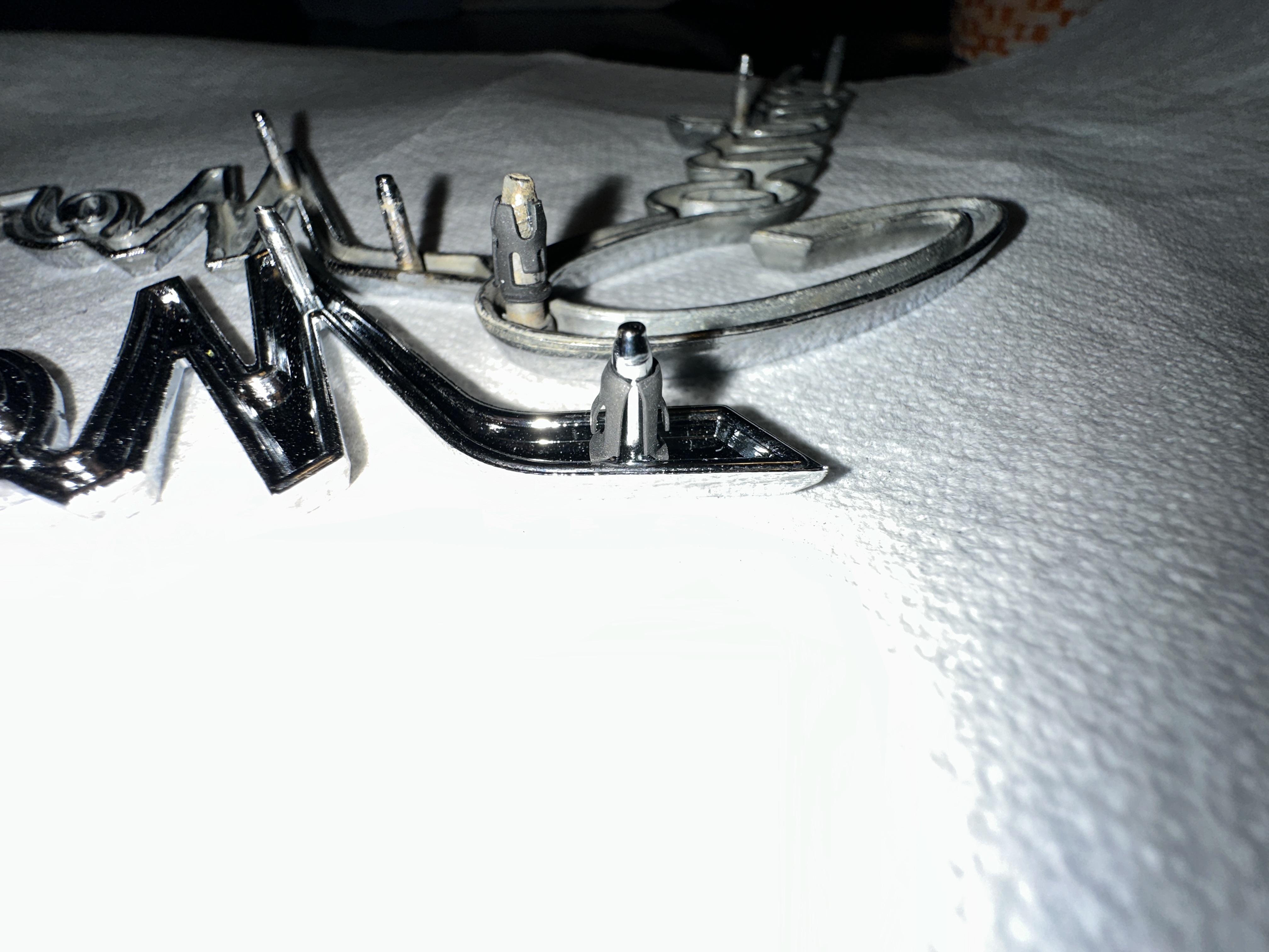

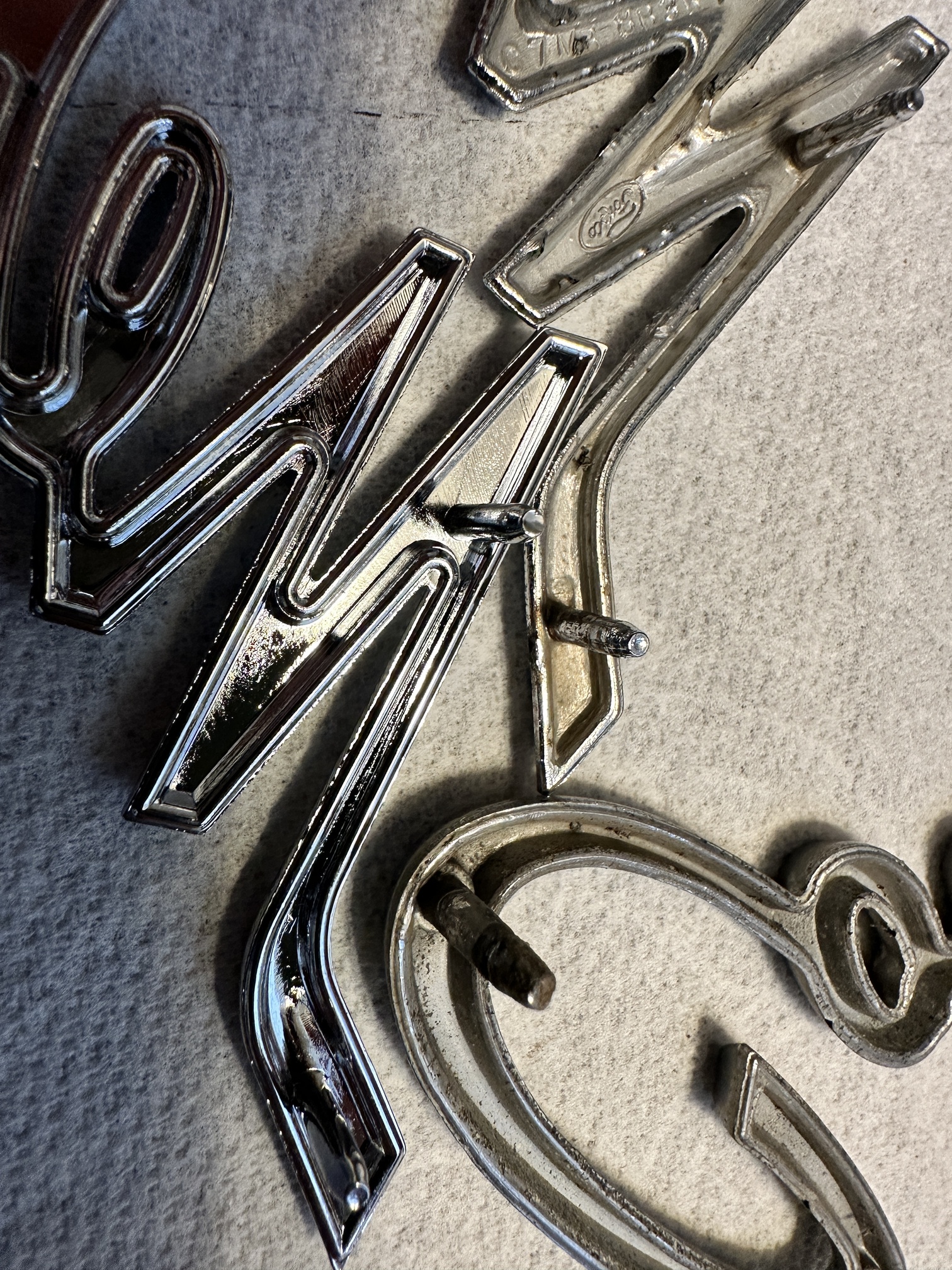

Here you are seeing the old Mercury Script (top), new mercury script (bottom left) and the Cougar quarter panel script (right) for comparison.
The mercury script studs, new and old,are the same diameter. The cougar script is wider.

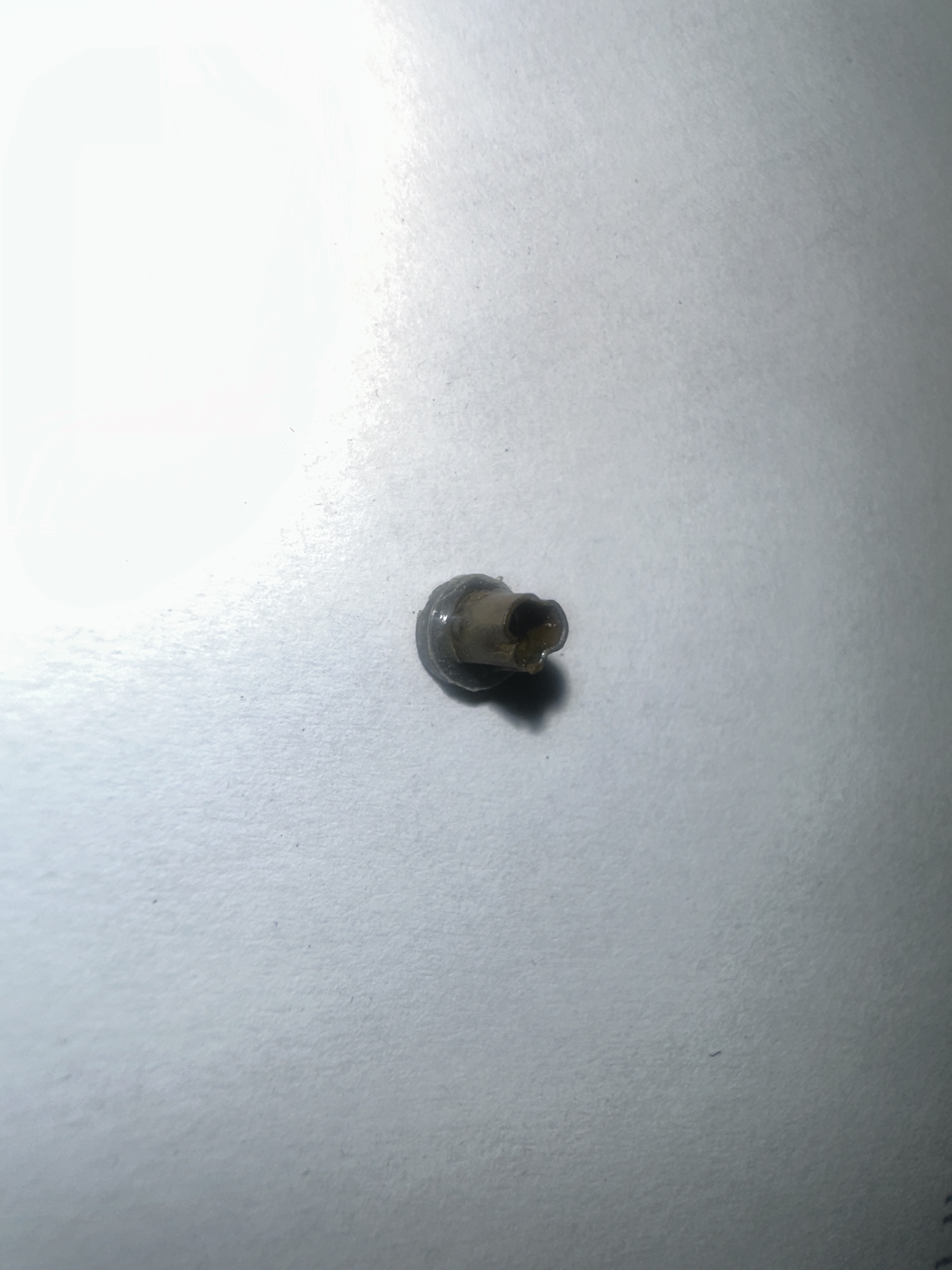

Here is an image with the barrel nut on the Cougar and Mercury script. You can hopefully see that the barrel nut grips onto the cougar script stud but can slip easily up and down the mercury stud. Finding it hard to believe that this will keep the stud in place even when installed.
Maybe I’m missing something? Are there different size barrel nuts?
Ended up finding another bag of emblem mounting nuts I had ordered from NPD in my stash. They worked perfectly and had the little rubber grommet too
Looks like you have your fix. But the barrel nuts will squeeze together when pressed into the holes in your panels closing the gaps. However then don’t look like the ones I recall using in the past.
The barrel nuts come in two sizes. When you remove the old emblem it’s very likely that the original barrel nuts will stay in the holes. It’s best to reuse them unless they are rusty.
Barrel nuts squeeze down when you insert them into the holes. You can’t judge the fit until they are inserted.

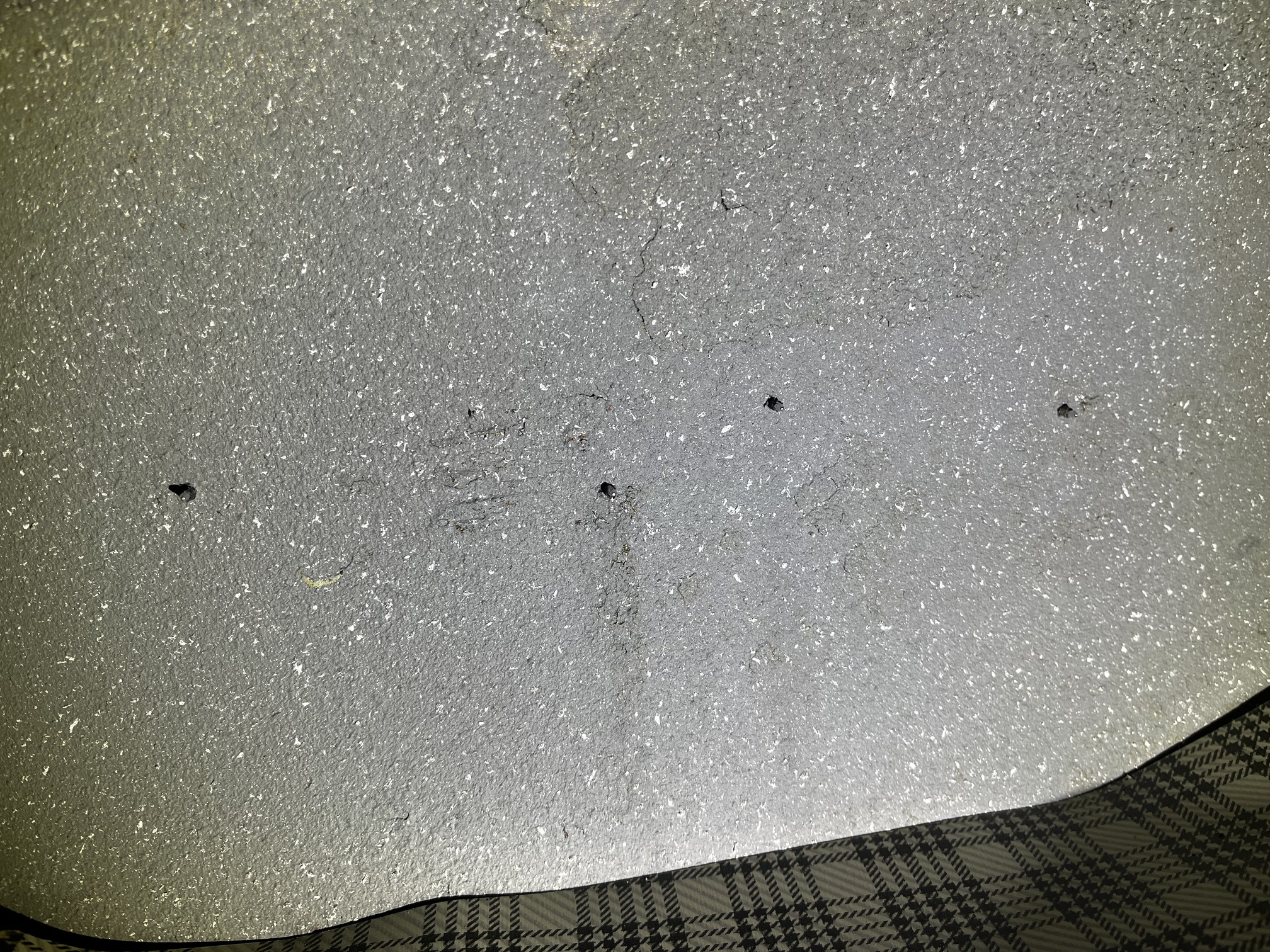

Thanks all, yea I’m sure there are different sizes of barrel nuts at this point. I had the wrong ones initially as there was no chance I could have even pushed those into the 1/8 holes in the deck lid before without drilling out larger holes. I’m going to order some barrel nuts again from WCCC with my next order just to confirm. I’m sure what they have on there is correct.

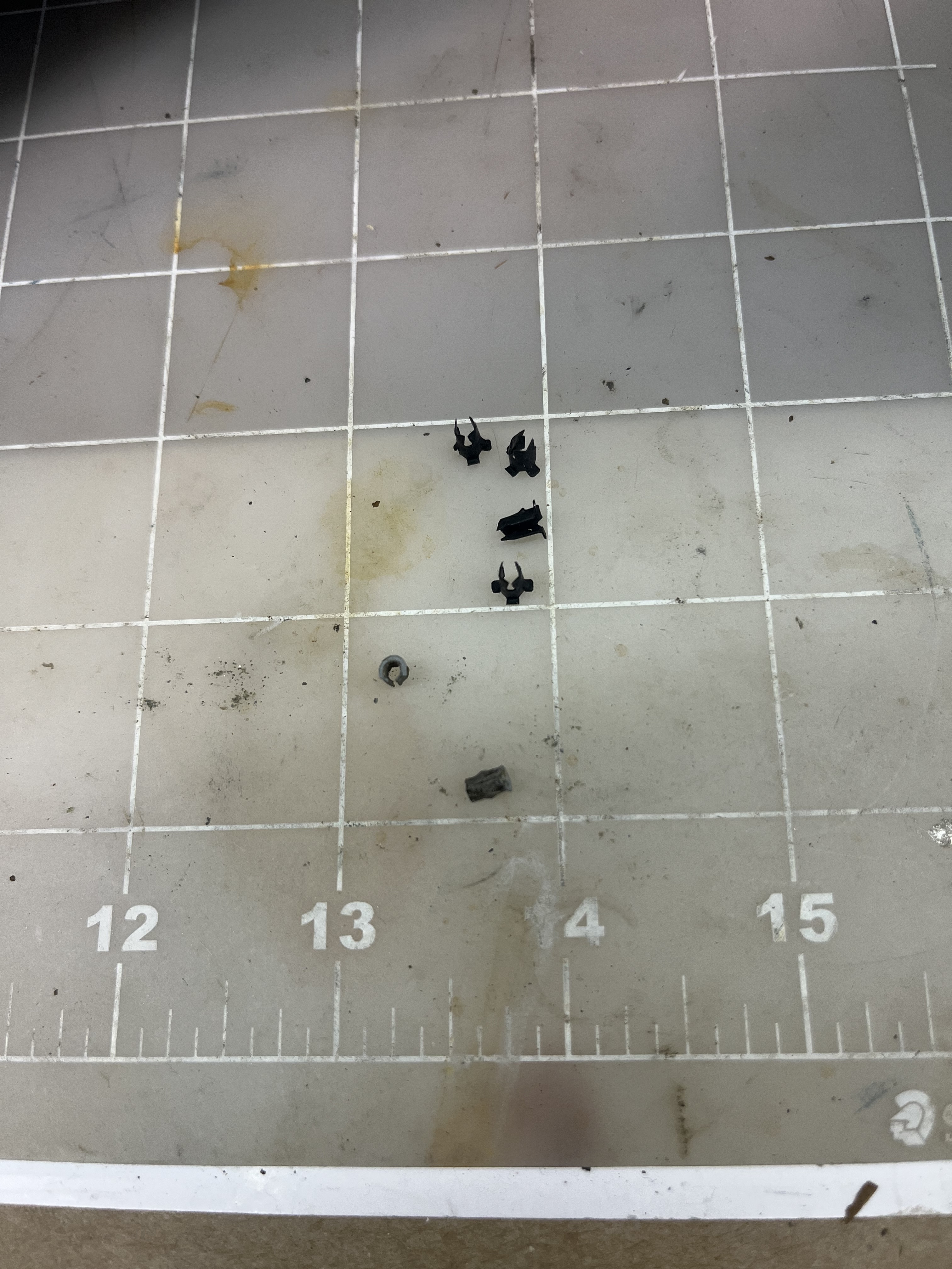

Guys, I’m even more stoked that I read this. I went back to do it right and noticed I was missing a repo barrel nut because I installed them incorrectly.
Looked and couldn’t find anything but 3 original barrel nuts in the trunk.
One of them worked perfectly. Now have two spares and my quarter emblems are much more secure. Thanks to all.
