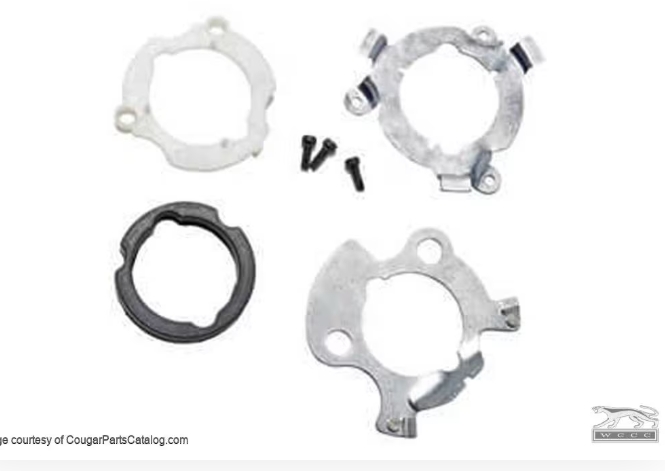

Turn Signal Cancelling Cam - Fixed Column - Used ~ 1967 - 1969 Mercury Cougar / 1967 - 1969 Ford Mustang ( 1967 Mercury Cougar, 1968 Mercury Cougar, 1969 Mercury Cougar, 1967 Ford Mustang, 1968 Ford Mustang, 1969 Ford Mustang ) at West Coast Classic Cougar :: The Definitive 1967 - 1973 Mercury Cougar Parts Source
I don’t know what the wheel comes with, but you may need a turn signal cancel cam as well.
Mike
Hi thanks, i haven’t opened it up again yet but i believe that is there because i had to put some taller pegs on it last year with this aftermarket wood wheel to get the signals to cancel on turns. if needed though i see ebay has all those parts. thanks again.

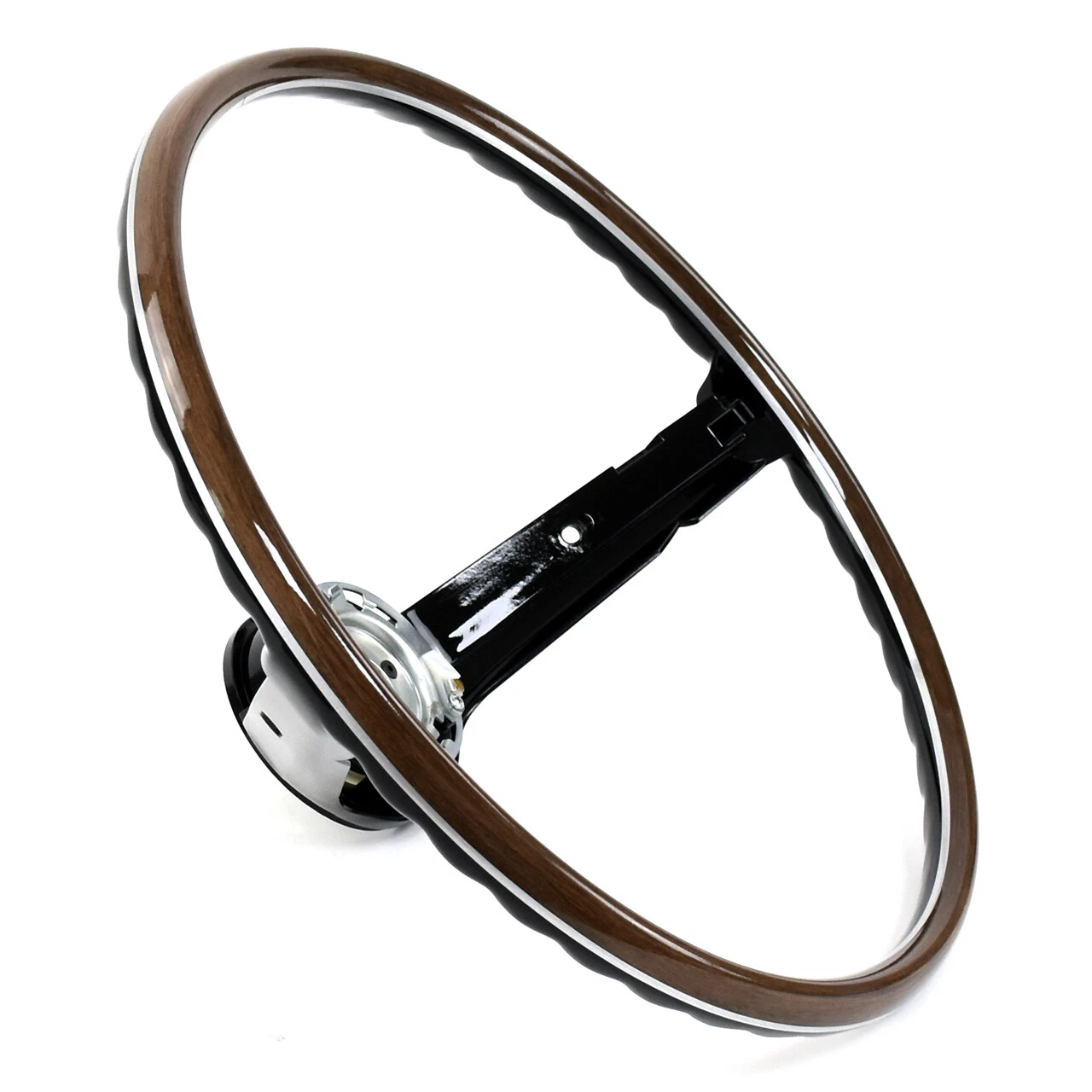

I’ve done the reproduction steering wheel on several cars in my opinion the wheel is made correctly then the chinese guy assembles it with hardware that is too long so it shorts out the horn and causes the breaker which is in the headlamp switch to blow. I solved the problem by getting shorter screws from the hardware store.
Thank you Royce for the info, I’ll keep that in mind while im working on this and be sure to check that out.
This is the repro ‘68 steering wheel I bought, I believe designed & made by APC?? Anyway I love how it looks and with stainless steel bands instead of the old mylar with it’s issues. With this full steering wheel restoration and Bill’s new dash panels installed, it will be so transforming for the worst parts of my interior. Thanks again.
I don’t know the builder, the ones I bought were from Best in Show and WCCC. Both of them appeared to be the same and all of them appeared to have too long hardware.
