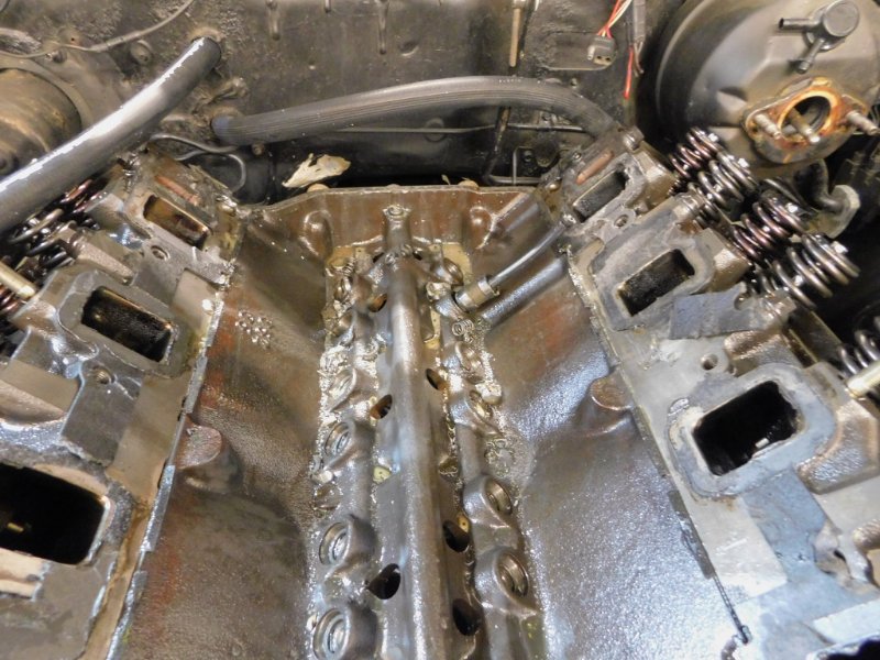

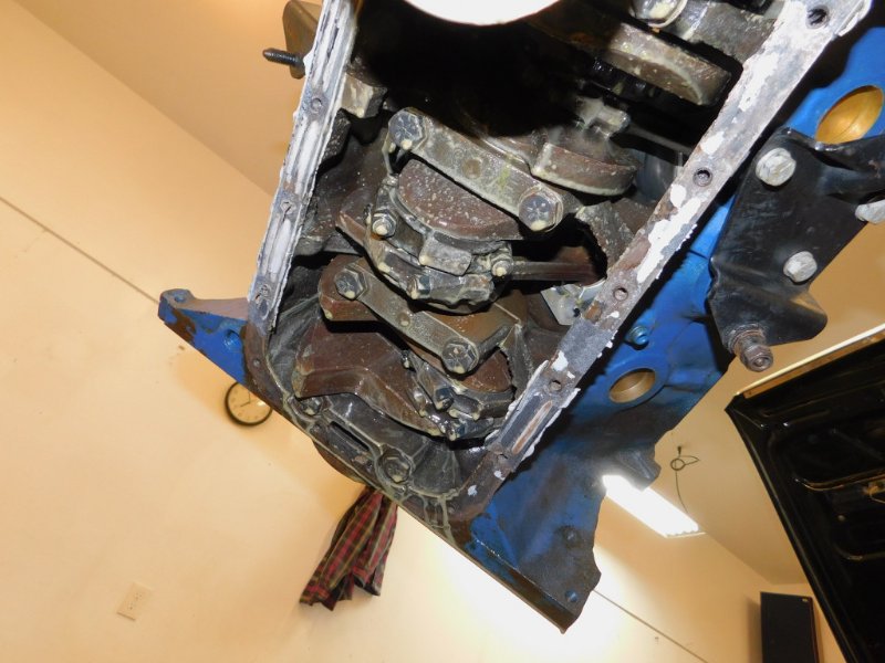

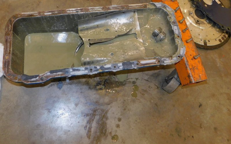

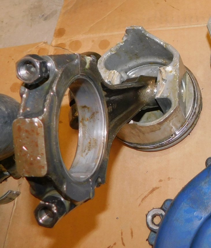

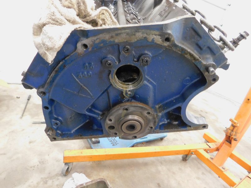

I recently removed a 428 from a Mustang that had similar damage. His engine grenaded on the freeway at around 2900 RPM / 65 MPH in fourth gear. He said there was a slight tapping noise at first, then the engine gradually lost power and finally locked up when the camshaft broke in 5 pieces and stopped the crankshaft, which resulted in the block being broken.
In the case of the 428 I worked on it appeared that a lifter circlip fell out which allowed the lifter guts to eventually fall out - probably the tapping noise. One pushrod then fell into the lifter galley. The loose lifter parts got crunched up by the crankshaft eventually leading to bigger and bigger pieces of cast iron bouncing around inside. All of this probably took 15 seconds.
We had Charles Eller of Arlington build a new 428 for us. We used a stroker assembly from Barry Robotnic so the engine was 462 CI when done. A new (std bore but had to go .030" to clean up) block cost around $1200. The rest of the parts and labor came to almost $10K for the whole job.
Will probably need some help sourcing parts and people to help since you’re relatively close to me and know a lot more about this than I do if you’re willing. What are your thoughts on this particular carnage?
Always glad to help. I would suggest that you have someone like Charles Eller tear it down and make a report. No idea just looking at your pictures what started the catastrophe. I am going to be in Dallas next week.
