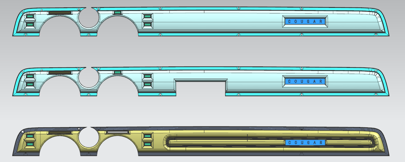

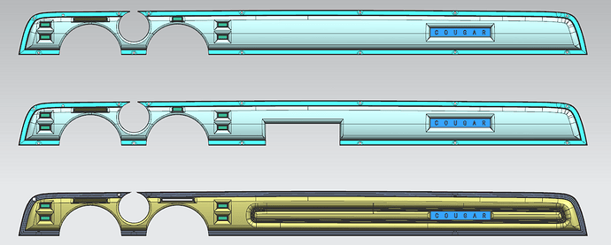

The image I posted is a little confusing. The dash bezel, the base that the instruments and face pad attach to is done. What this is about is the face pad or fascia itself. Here are a couple of updated images that that show more clearly what it is that I am working on.
The complete dash fascia panel kit will include quite a bit. The panel, the aluminum trim that surrounds the panel, the lenses and trim for turn signals, High Beam, Belts, Brakes, and the trim and insert for the wiper switch. The trim will be different to accommodate 67 and 68 styles and also AC, no AC.
The fascia it self will be injection molded plastic, it will have the same shape and texture as the original but it wont crack and shrink and de-laminate the way the originals do. They will be painted the nine different colors to “match” the originals. You may have noticed two things: the existing pads are all faded, and they don’t match anything else exactly. We are going to match to the color of the original vinyl where it was covered by the trim.
Note: the trim under the AC opening should be continuous, and will be in production. In these images it was left out to show the fascia is open at the bottom like the original parts.

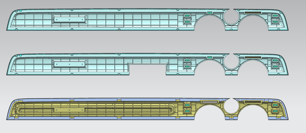

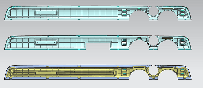

The back side is pretty cool. This is all done to make the panel strong and to get the plastic to flow without knit marks and other issues.

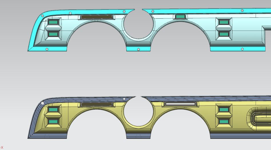

A little more detail on the lens locations. Nothing here is for color for final detail.

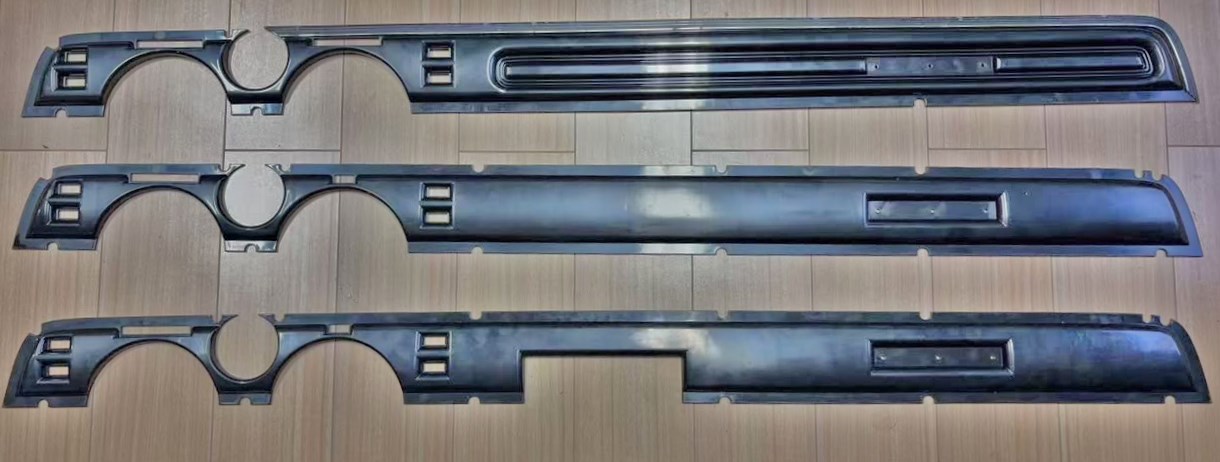

Okay, hold your horses but this picture came in last night. These are first article samples. Basically it just shows that we can get these out of the mold and that the flow is working. This is not as close to being done as it looks.
If you look closely you will see the first piece of ‘68 aluminum trim is in place. That curve is a very hard thing to do.
