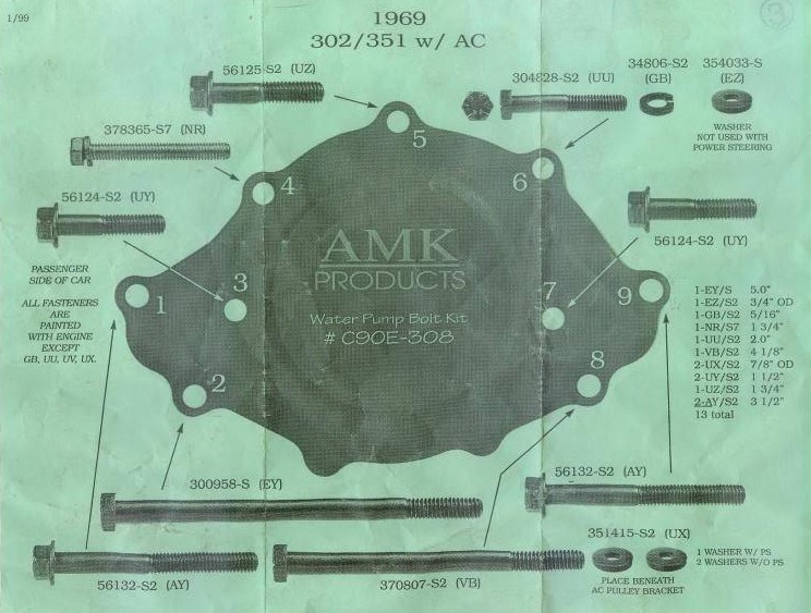

I’m going with the 69 but am having an issue identifying the correct bolts for the timing chain cover and water pump. I bought the complete engine bolt kit from WCCC. In looking in the manual I really couldn’t figure out the bolts. Any help here? Thanks,
I found the AMK diagram invaluable. I only had about half the original fasteners. I ended up getting the full AMK kit from WCCC.
