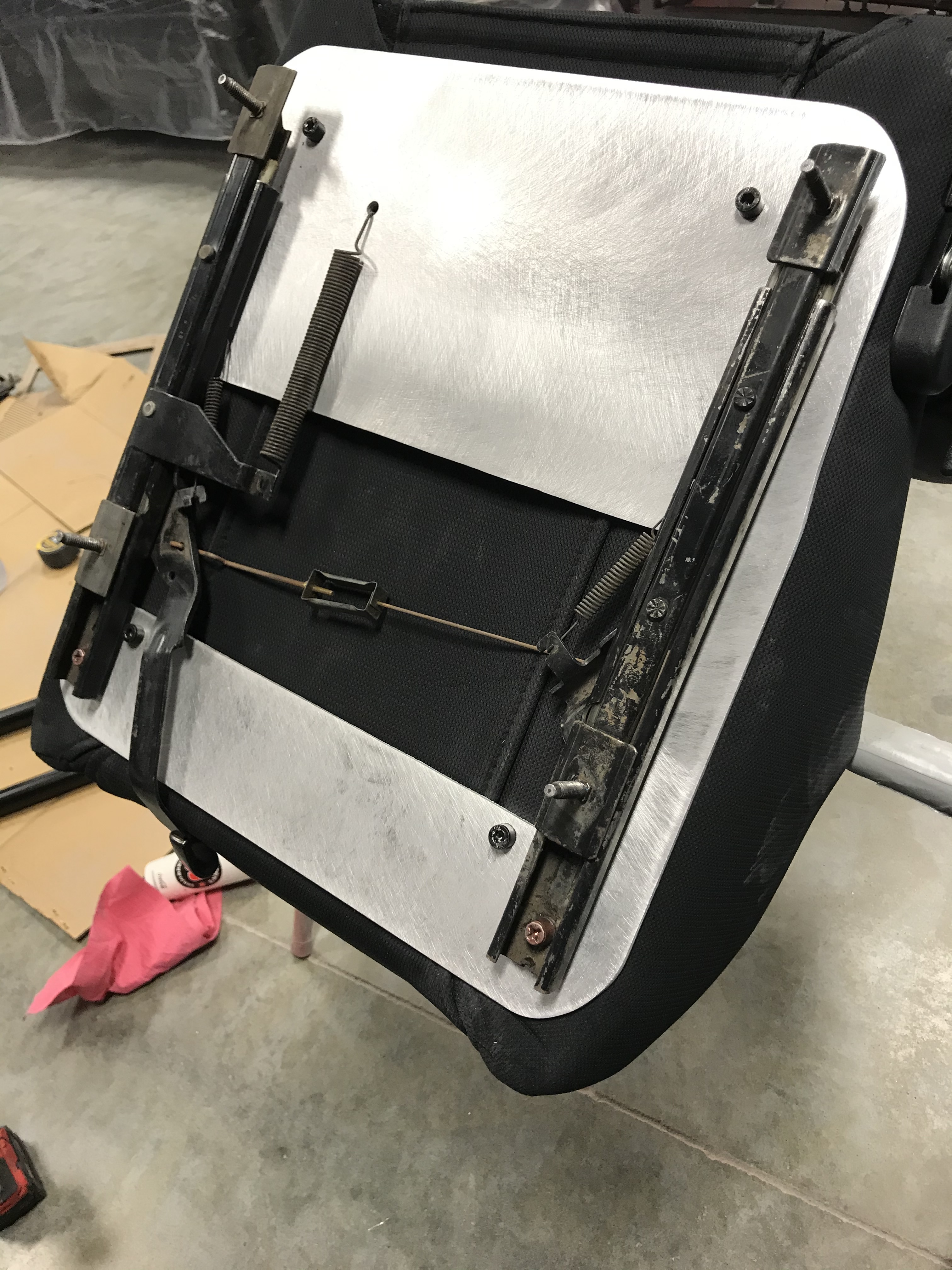

Late 90s honda prelude…narrow, flat mounting,removable headrest,pass seat goes foeward when back ie moved foreward.
Had 1/4 steel plate cut to a q shape that allowed the honda seats ro mount on the ford pattern
Bolted in with stock hardware

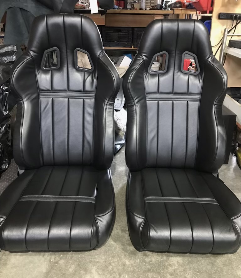

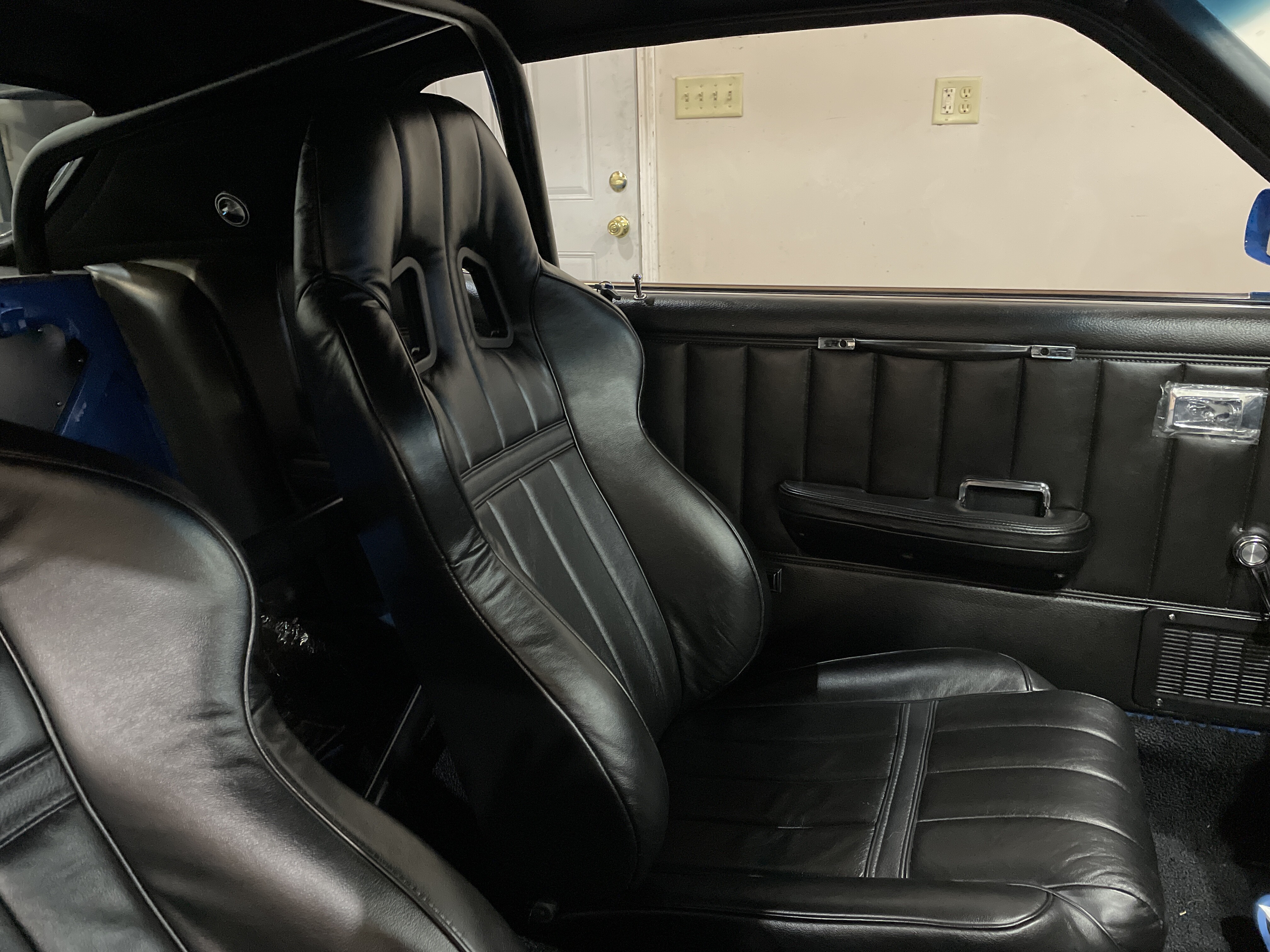

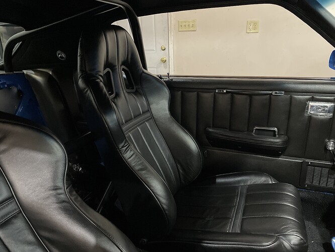

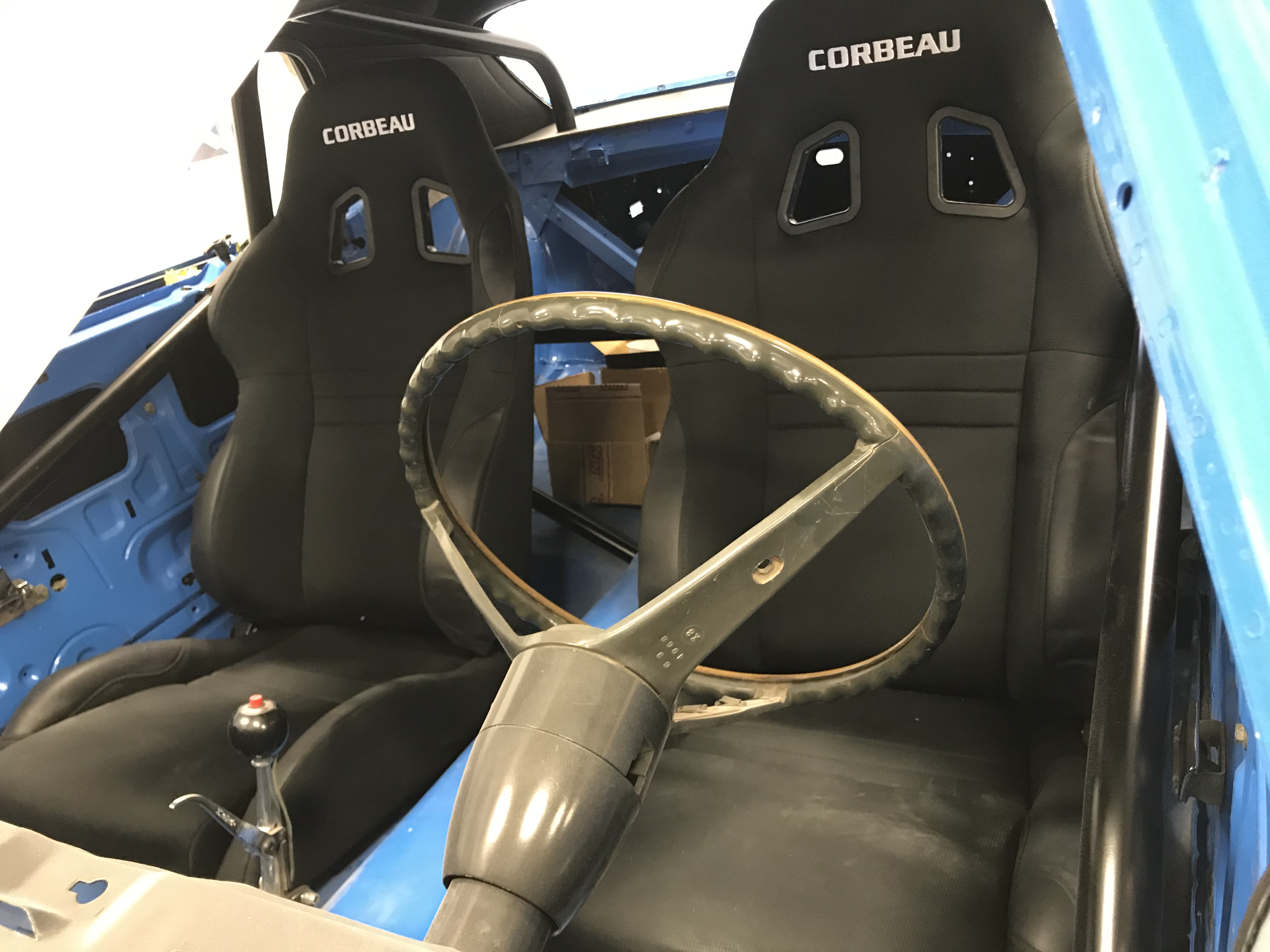

Corbeau seats, recovered in leather in the style of Cougar upholstery
I cut the seat risers down 1 1/2 inches
