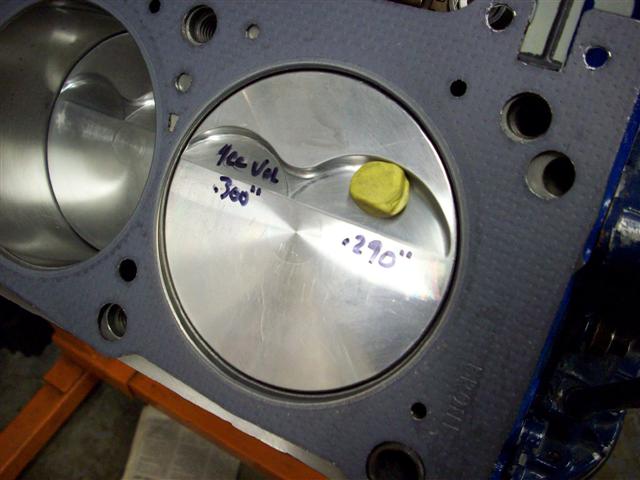

How to you waste time and money? Let me count the ways that I lost time and money doing this to a 351W in my car…while not gaining more than a tenth of a second at the drag strip…
*Lower compression 2V pistons: Work better with garbage gas. No HP increase.

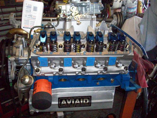

One of the BEST SBF’s I ever built was a 331 stroker out of a 5L block. Got roller lifters out of the deal, used flat top pistons along with Ford Racing alloy heads Y303 series, and ended up with a 10,3:1 or so CR. The alloy heads will allow you to run higher compression than cast iron as the alloy heads shed heat like crazy! You can use a 351W Performer to pretty much duplicate the performance of the stock cast iron intake with carb spacer ,which was one of the BEST stock jobs Ford ever did!!! Old magazine articles mention that aftermarket intakes did very little to improve performance over the stock version and that the Ford engineers had done their homework!!!
Out of my little 331 with the biggest cam in the FRP book, about a 512 lift or so, (with 1.7? ratio rockers for a little more lift!) and the wider overlap (12 degrees) gave it a very smooth stately idle that purred…but screamed when you hit the go pedal!!! Some 2.25 (3" tall) Flowmasters would work fantastic with this setup.
I ended up with over 300HP at the rear wheels in the car I had it in!!! That meant about 400HP at the crank. With a manual trans, this was a crazy good combo! I also had a smaller 580 Holley carb (newer series…hah…ten or so years back!) that once jetted on a dyno tune, was fantastic!!! Probably the only carb I have ever had work so well when the secondaries kicked in!!!

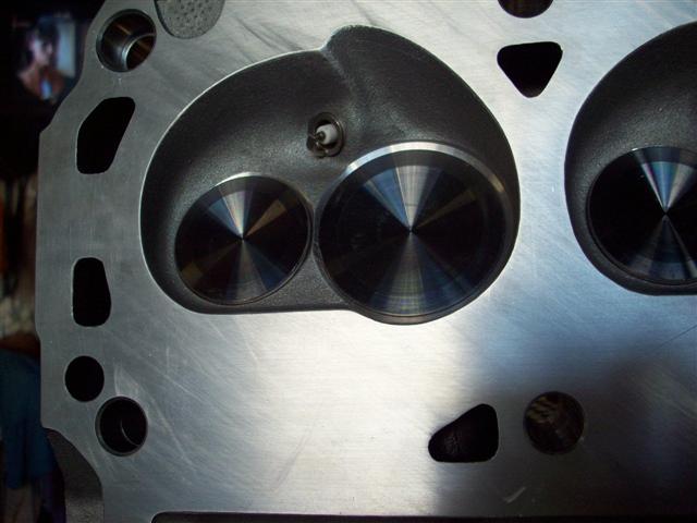

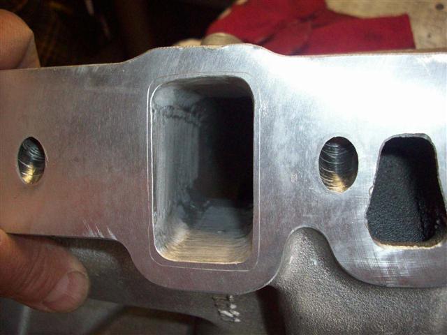

I port matched the Ford alloy heads to the intake gaskets and then to the intake but only the first 1/2" or so into the manifold. Just need the ports to line up so no turbulence. Do NOT polish the runners smooth. That would dork up cold and warm running as you need the tiny bumps to mix up the air/fuel mixture a bit! All out racing needs the butt smooth polish job…not on the street!
Did similar to the exhaust, matching head ports to the header ports and gasket. Only enuf material to smooth entry/exit to neighboring device…ie header or manifold.

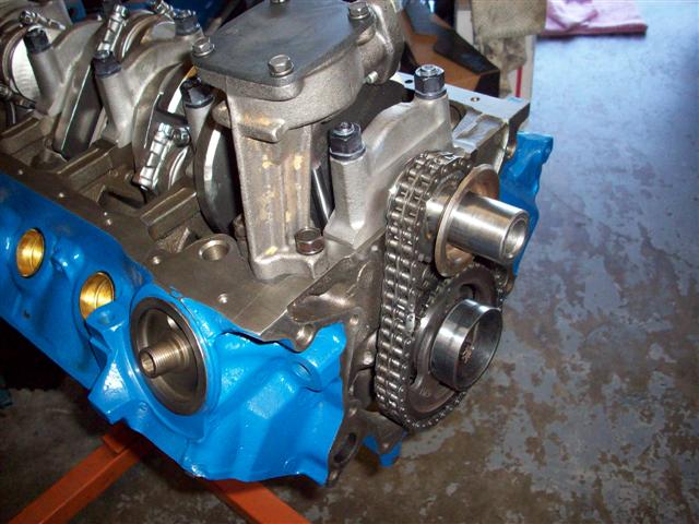

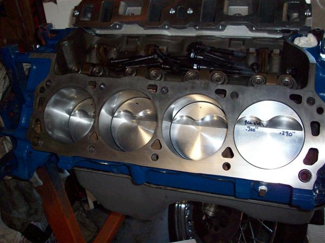

Some pics for you!
Steve

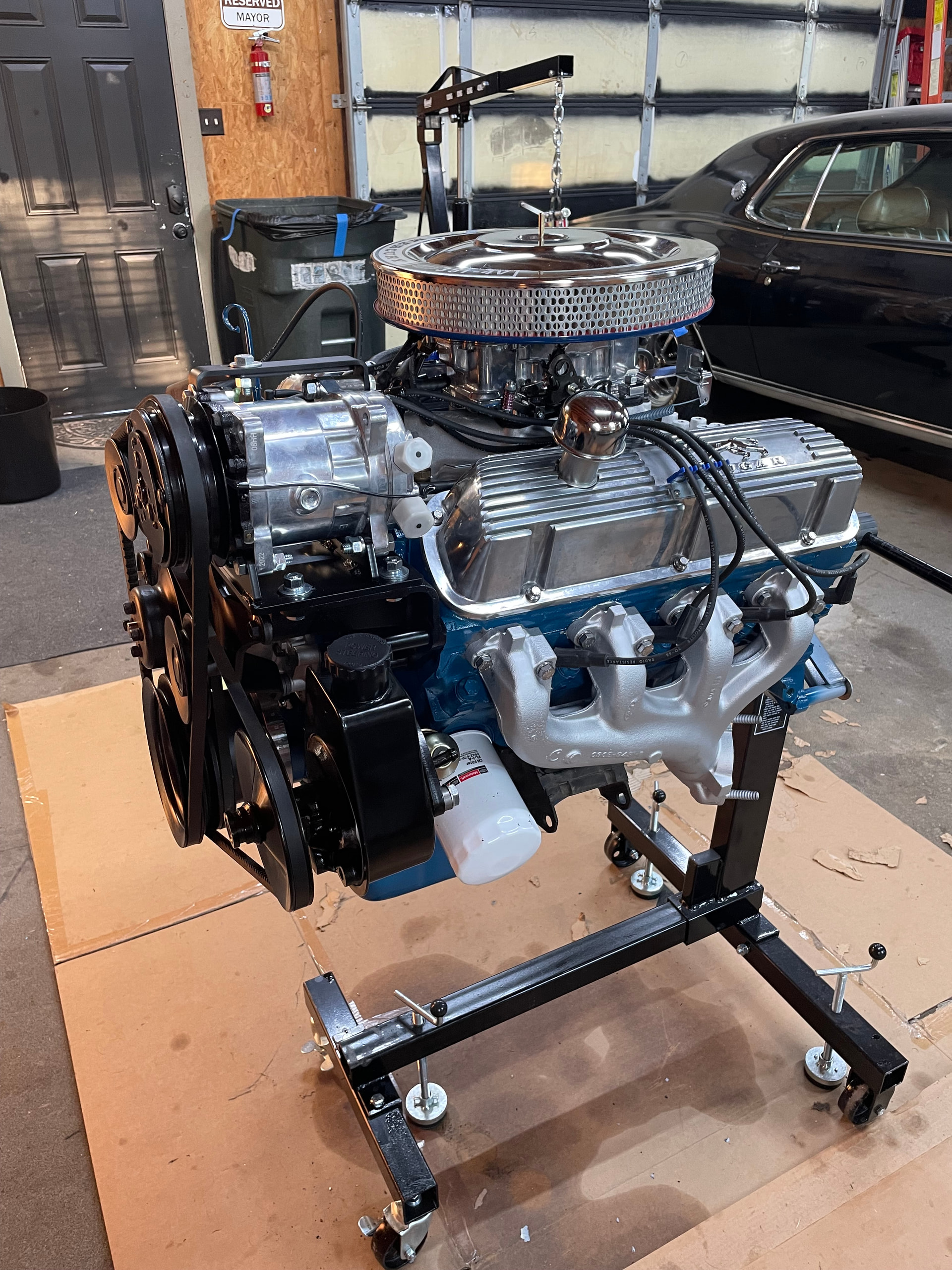

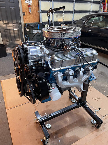

These are the previously mentioned Doug d669y on a 351w

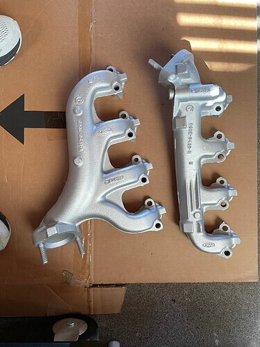

Stock 351w manifolds flow very well. I had mine ceramic coated by a local shop for under $300 and the results are stunning IMO.
