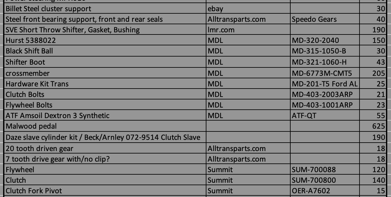

I got a 28oz flywheel on summit as well as a stock mustang 10.5" clutch.

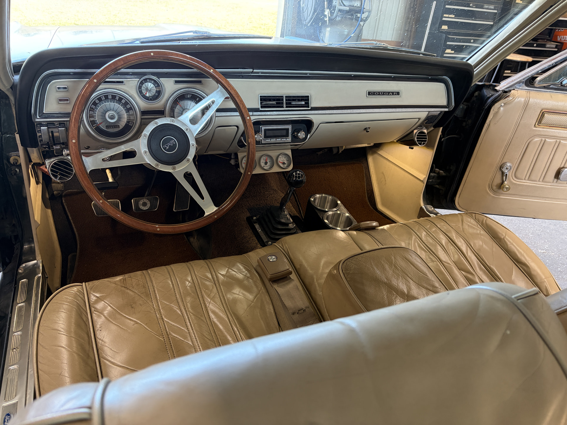

Also the T5 Swap was the second best upgrade I added to my car, right behind cupholders lol.
Here is the flywheel I bought.
Here is the clutch I bought.
Here are some of the parts I bought with part numbers.
Looks great! Thanks for list, it’s definitely going to come in handy so I appreciate it. Sounds like I should go through with it.

Here’s the writeup on the C4 to T5 swap I did on my 68 302: Sprucing up a '68 Cougar - #124 by mfc133
