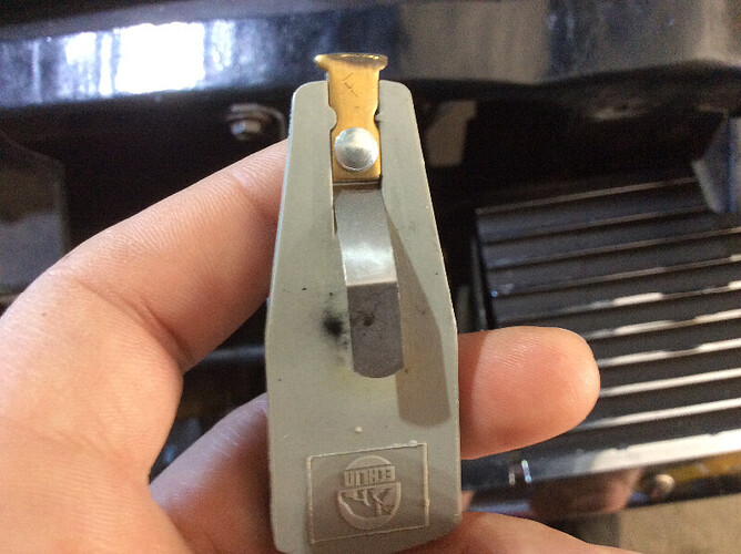

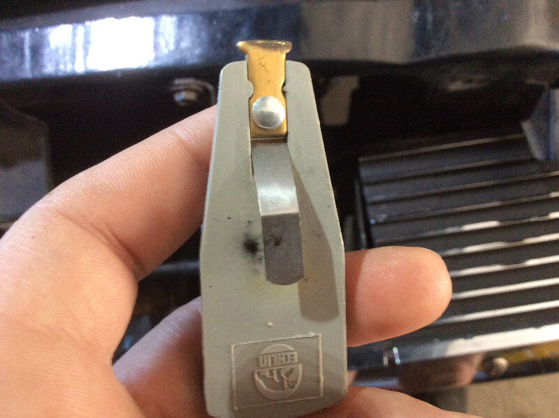

You’re right of course Bill. I’m just so frustrated at this point…I’ve been chasing this miss forever it feels like. Pics below…
One end of the rotor is burned off. See how the tip is no longer symetrical? That needs to be replaced.
Yes, I see…well something is going on inside the cap as you alluded to earlier, because that rotor is not even a month old.

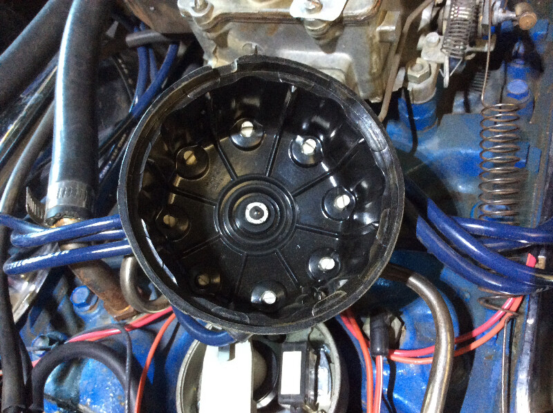

Ouch! These new parts are some times not great but that is terrible. Be sure the cap is dropping all the way down on the distributor, all the way around, and the screw is in the little window for alignment.
I have spent some time examining the issue and have concluded that there is indeed an issue with the cap seating. Plan to proceed carefully and with a new premium cap and rotor. Professional consultation is also nearby and available.

Well I am cautiously optimistic that my ignition problem is solved. Whilst re-gapping my plugs back to .032, I took the opportunity to measure the resistance of each plug wire (which I was told by the previous owner were new…), and I discovered a faulty lead on the #8 cylinder. Repaired it with a new terminal and also replaced the (new…?) distributor cap with a premium unit as again, I discovered that the old unit had a seating problem. A new rotor to complement it and…(fingers crossed…) success!
