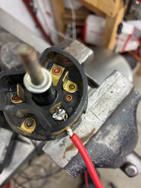

I recently added a switched 12V power to supply the Pertronix in my brothers 1967 Cougar. I drilled a hole in the ignition switch and then added a wire by soldering. The car runs great with the new Pertronix.
