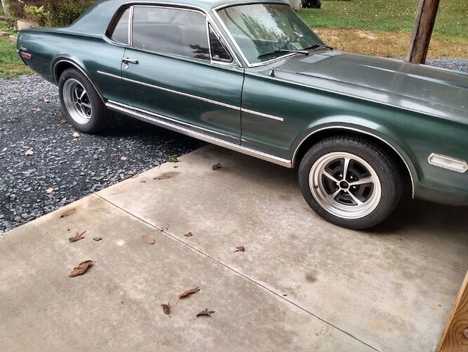

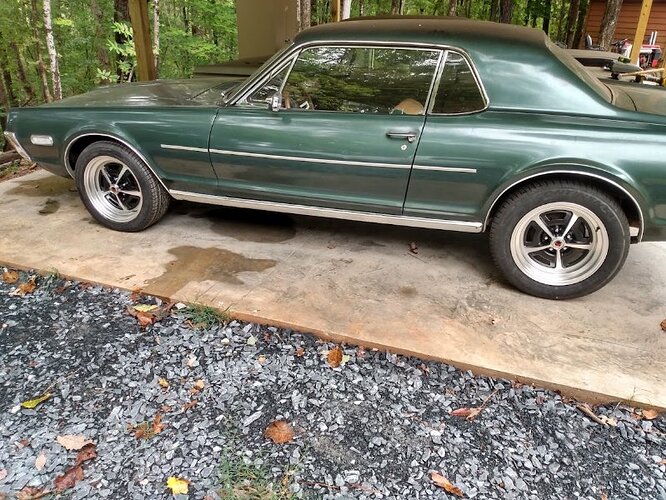

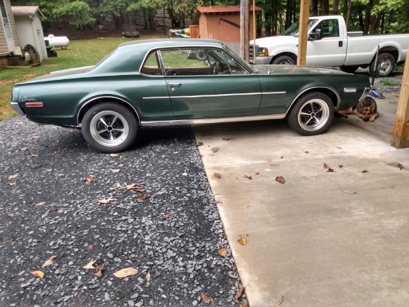

We just installed a set of Legendary Wheels Magnum 500’s on our 1968 Cougar. We went with a 17"x7" on the front and 17"x8" on the rear. The fronts have a 4.25" backspacing and the rears are 4.75". I decided on Continental Extremecontact DWS 06 tires and went with a 225/50/17 (OAL Dia 25.9")for the front and a 235/55/17 (OAL Dia 27.2") on the rear.
The only mods are clipping a 1/2 a coil off the stock springs, Opentracker roller spring perches and a 1" Shelby drop on the front. I am debating a 1" lowering block for the rear.
I have new wheel lip moldings to install and need to come up with a better center cap insert.
Nice looking cat. And the wheels look good.
Jealous… :mrgreen:
Wheels, and the car, look great!
I think you should lower the rear end. I’m no fan of the jacked up rear end look. Didn’t like it in the 70’s and 80’s and still don’t like it now.
Yep lower the rear to match the front.
Keep in mind cougars have a unique block in the rear and you will most likely have to build your own unless you switch to all mustang spring plates etc.

I really appreciate all of the replies. I was really concerned with the 17’s looking cartoonish, but with the sidewall, I think that they work. After some deliberation we have decided to add the 1" drop to the rear. I didn’t know about the unique Cougar leaf spring block, but will take a look. I have a full machine shop and can whip up what I need.

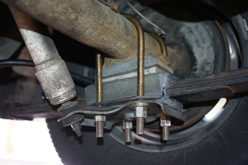

I pulled the Cougar specific leaf spring mount off my car when I replaced my rear springs at the advice of the spring maker, Flexform. It’s a steel or cast iron and rubber mounting clamp that wraps around the spring.

Here’s what I did for the purpose of altering pinion angle. Shims, like a block, will raise the axle/lower the vehicle. I am going with Cal Tracs over the winter and will need a revised solution accordingly.
