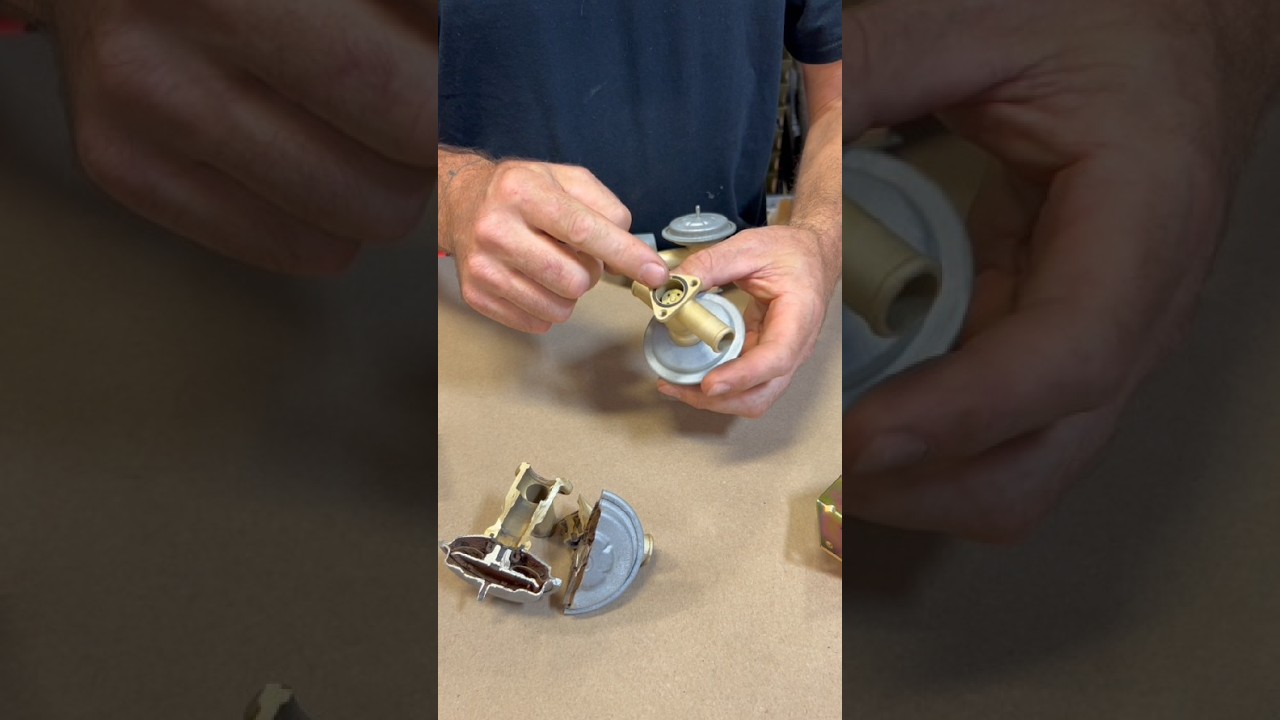

Often the valve is bad because the O-ring is failed and the bracket is rusted. What I have found is that some of these can be fixed by making a gasket from a Kleenex box. Not all of them, but some.
