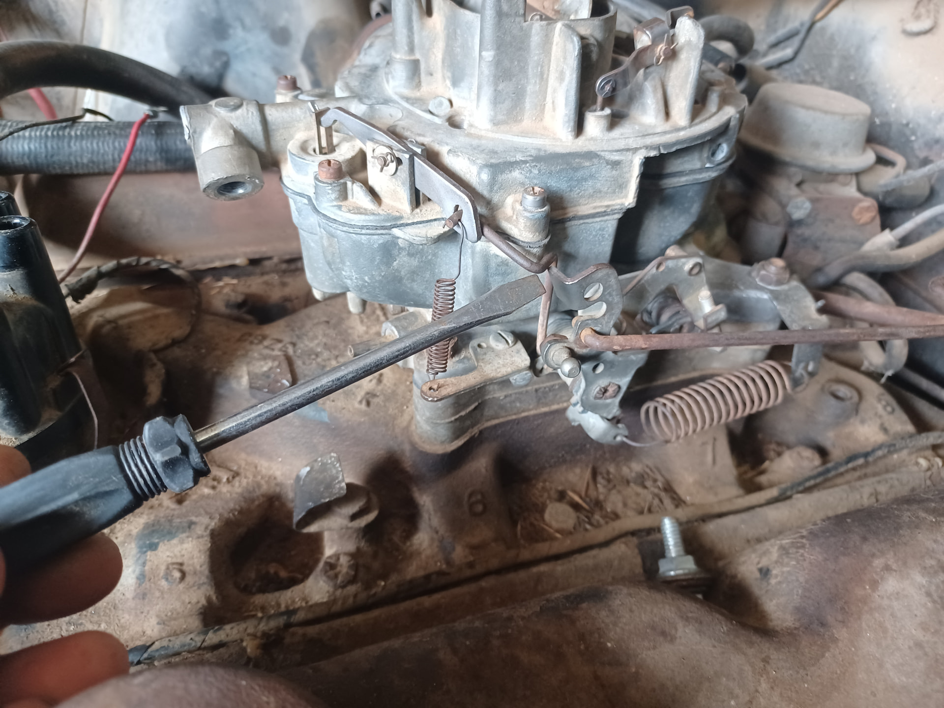

Hello, everybody.I have a nineteen sixty seven mercury cougar xr seven. It’s in very rough condition supposedly only has 77000 miles.I would not doubt if it’s actually one hundred seventy seven or two hundred seventy seven thousand. I rebuilt the carburetor first time I’ve ever rebuilt one, and I’m not sure I got the linkages on correctly for the throttle. It appears the I guess idle or throttle screw, just hinges back-and-forth without anywhere to actually rest or be effective.. Does anyone have a photo of a properly set up throttle linkage and could share that of a auto light forty three hundred four barrel. Thanks I appreciate the help.

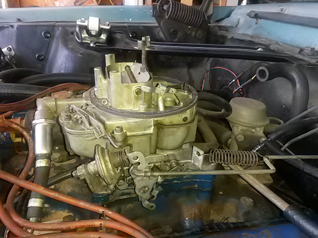

Here is a pic of my 67 with a 289 and automatic transmission. If yours is an automatic, you are missing the dashpot and the carburetor dashpot mounting bracket that the linkage rests against. WCCC shows that they have the bracket in stock and a used dashpot as well.

Originally the car was a manual. Sadly someone auto swapped it. Still has the clutch pedal lol
I can see I am missing that diaphragm thingy on the front. Thanks again

Here is a post by GregWilkerson Autolite 4300 Dashpot - #2 by catlover that shows the picture below describing the differences between the 67 and 68 4300 dashpots and their respective mounting brackets.

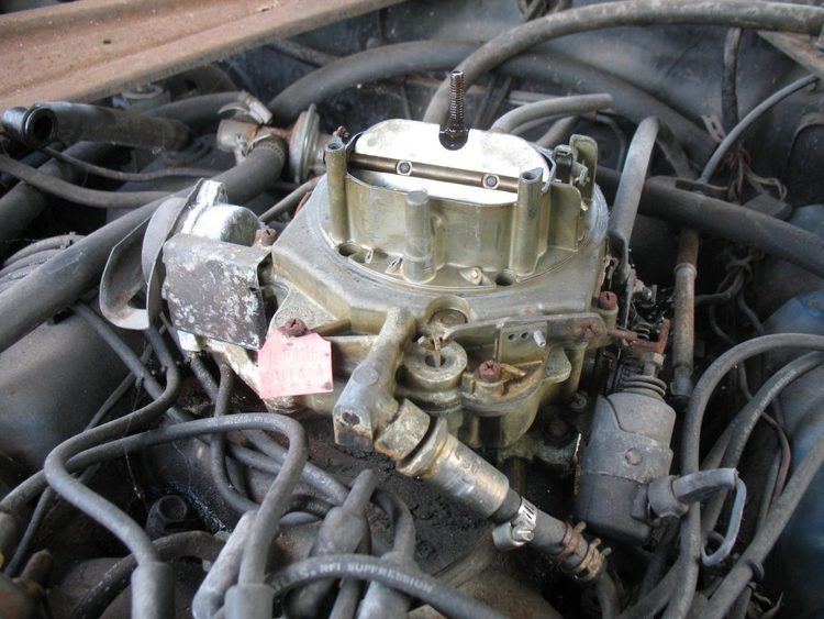

Also for completeness, here is a picture of an Autolite 4300 setup for a Manual transmission as instead of a dashpot, it has a solenoid. Note some A/C cars also utilized the solenoid to increase the idle speed of the engine when the A/C compressor is engaged.

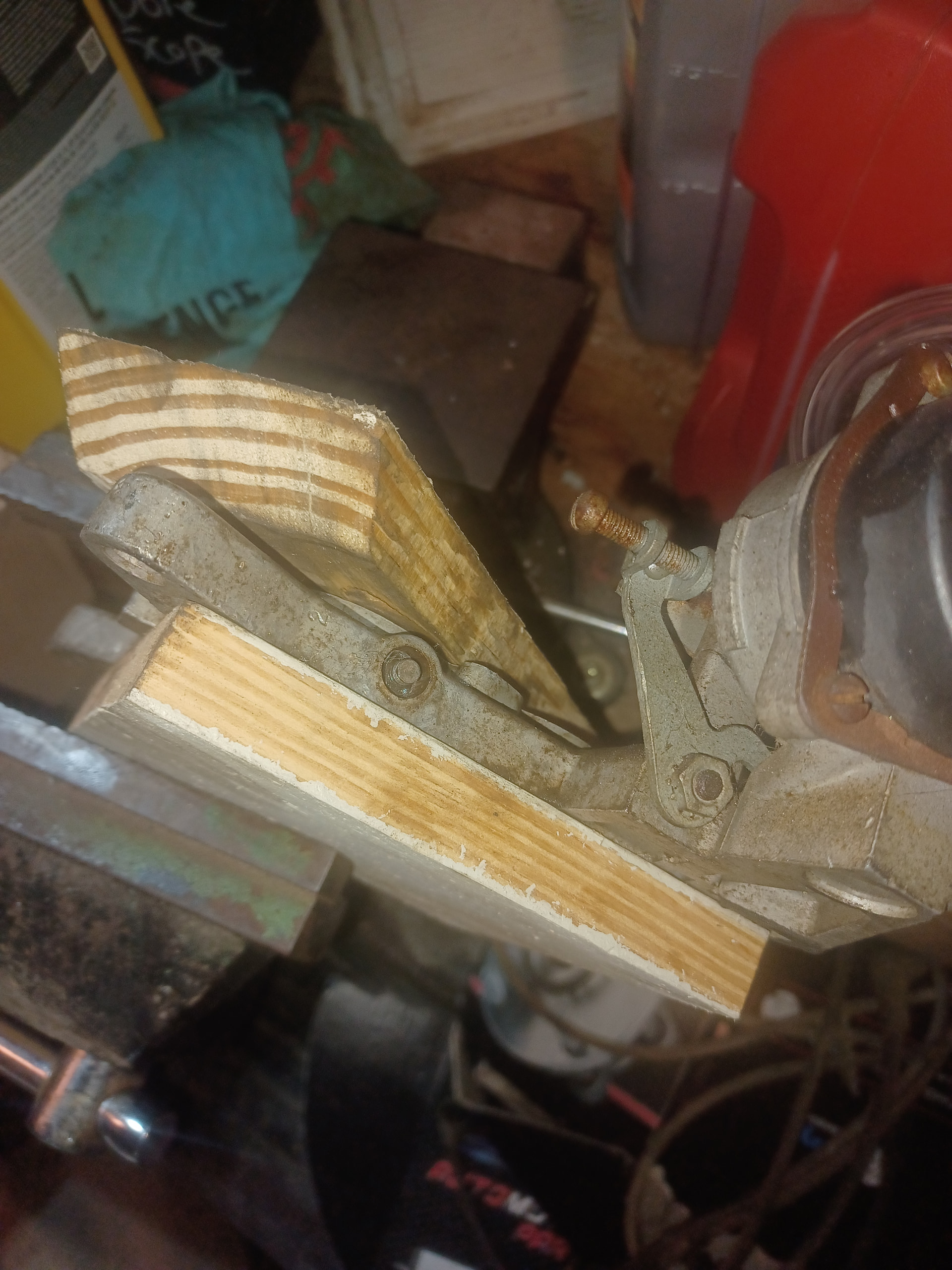

I appreciate all the responses in this. If yiu saw what I had to do to unstuck the secondary butterfly flaps and rod, you would have advised to throw it in the trash. I spent 3 hours working to unseize the rod, vise grip pull the flaps out, clean it up, drill corrosion out of rod bore holes, hammer the flaps back straight, and file them flat.
The previous PO deformed both sides of the secondary rod linkages by using vise grips but it didn’t budge. The previous po also hammered the flaps with a screw driver to try to get movement. Yea… it was a bear.
