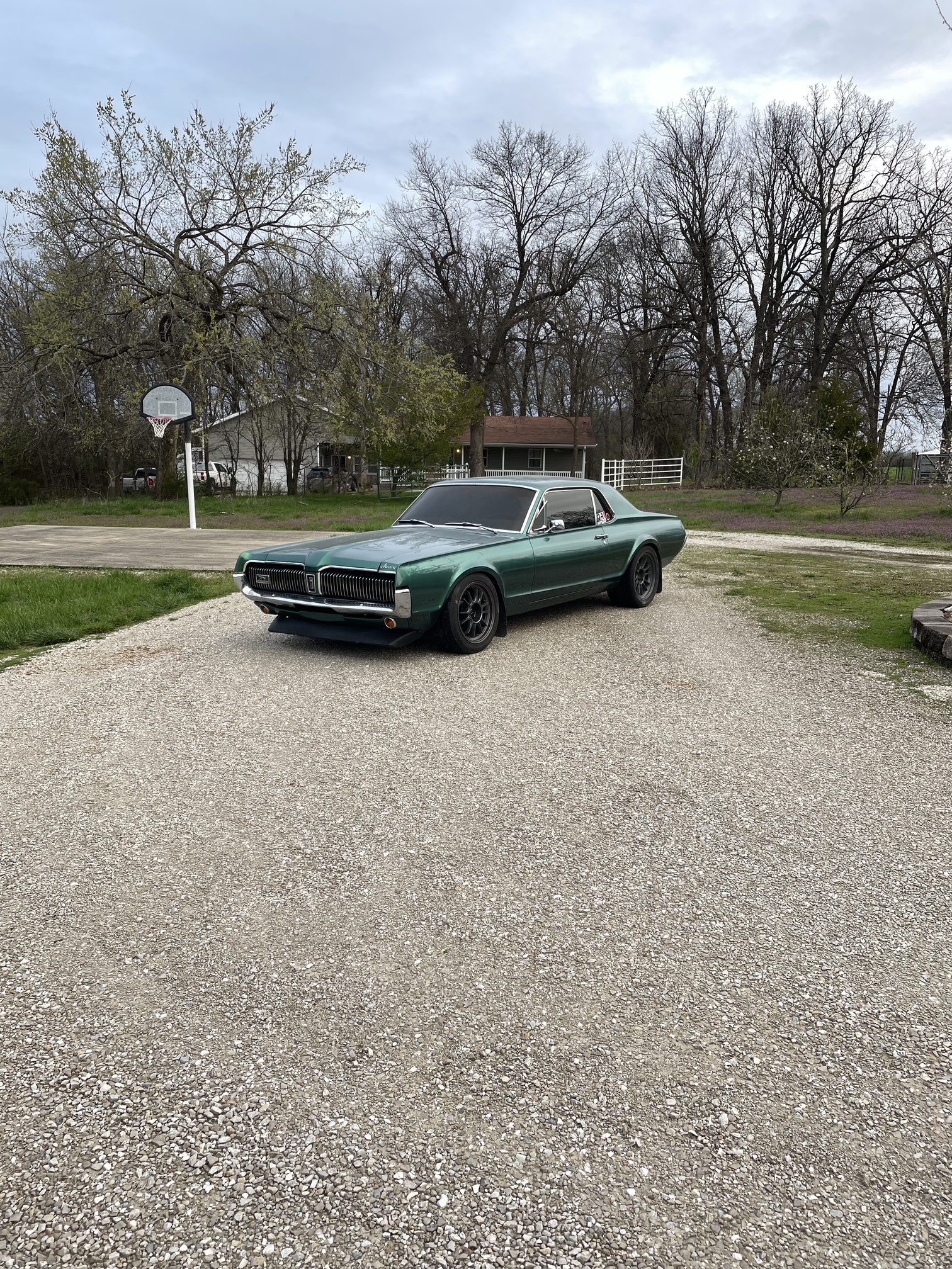

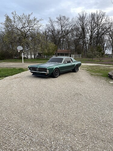

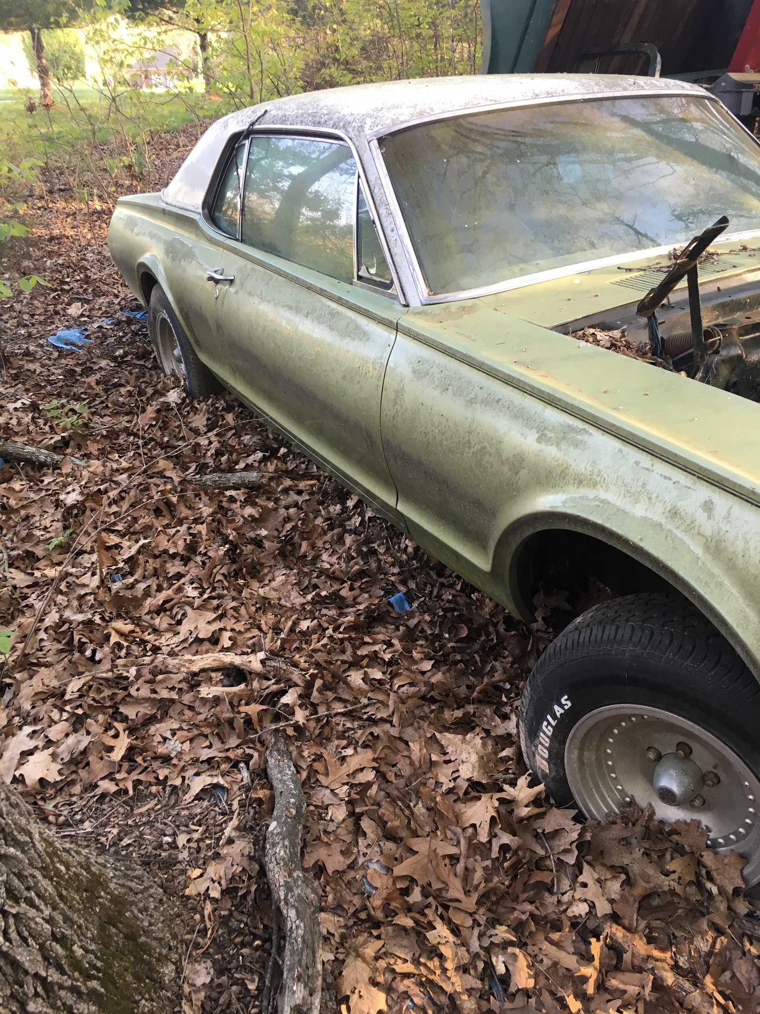

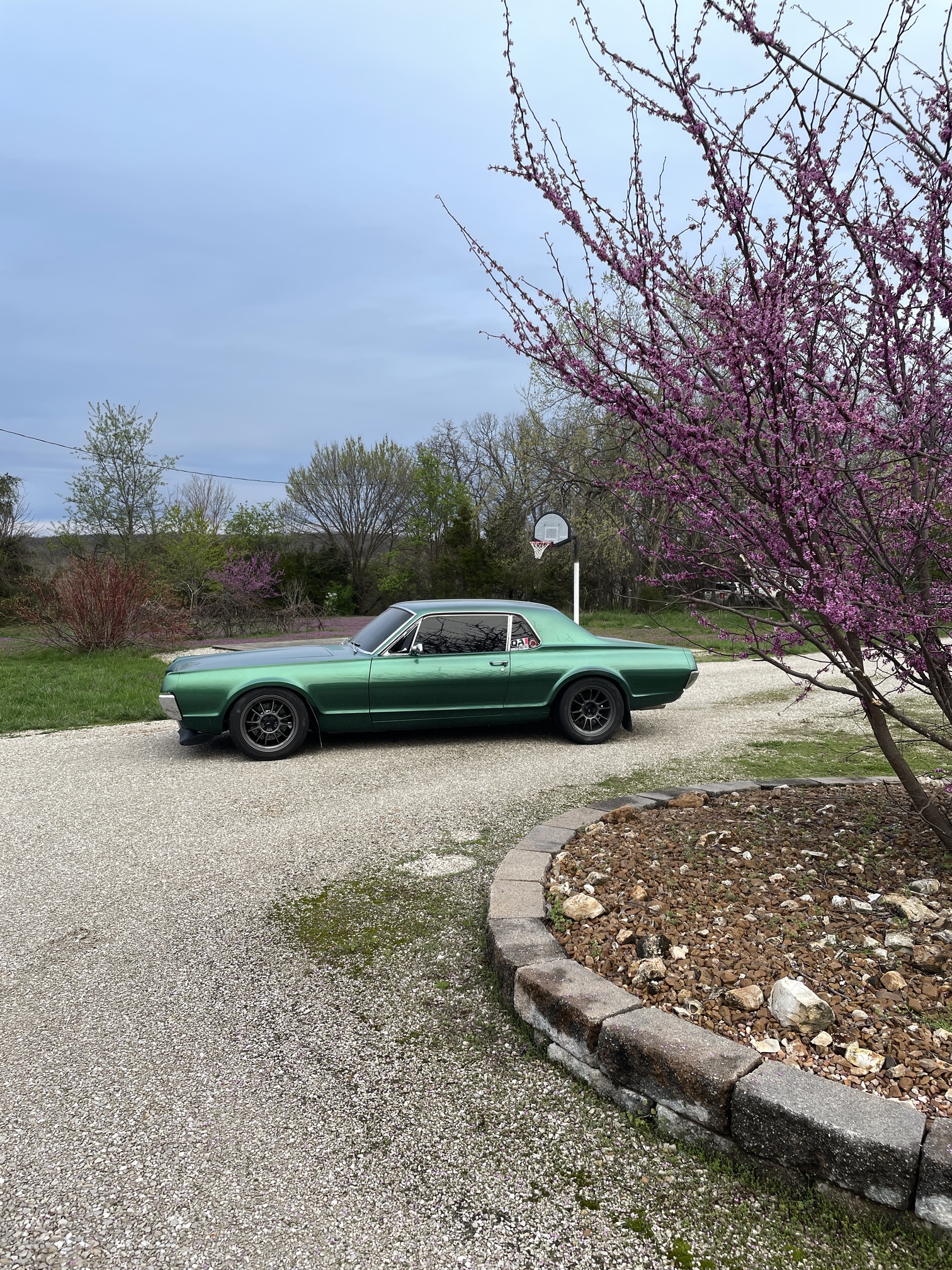

Hello, I’m new here so I figured I’d through together a little info about my car etc. purchased the car in 2018 from a friend who was going to scrap it. Over the last 6 years I’ve tried to make it a capable drivers car. The car is painted a custom tri coat Augusta green. Lowered on Calvert split mono leafs in the back with qa1 coilovers in the front. And large sway bars front and back. The drivetrain is a 289sbf with a mild cam and aluminum heads, intake and a Holley 600cfm double pumper. T5 transmission and 4.10 positrac rear gears
Managed 10k miles last year and shooting for the same or more this year!
Awesome car, I’ve seen you on FB. The car has a perfect stance with those coilovers.

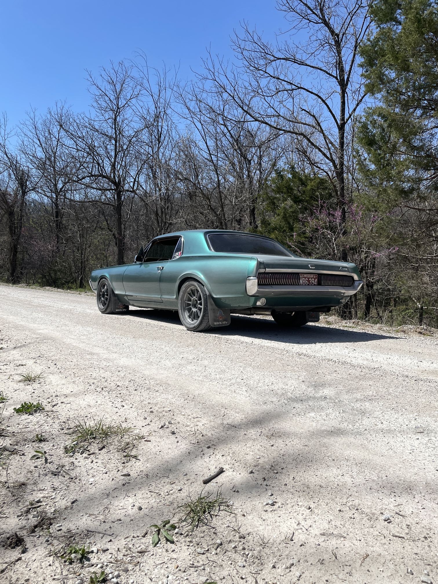

Put some more miles on the new setup this weekend!

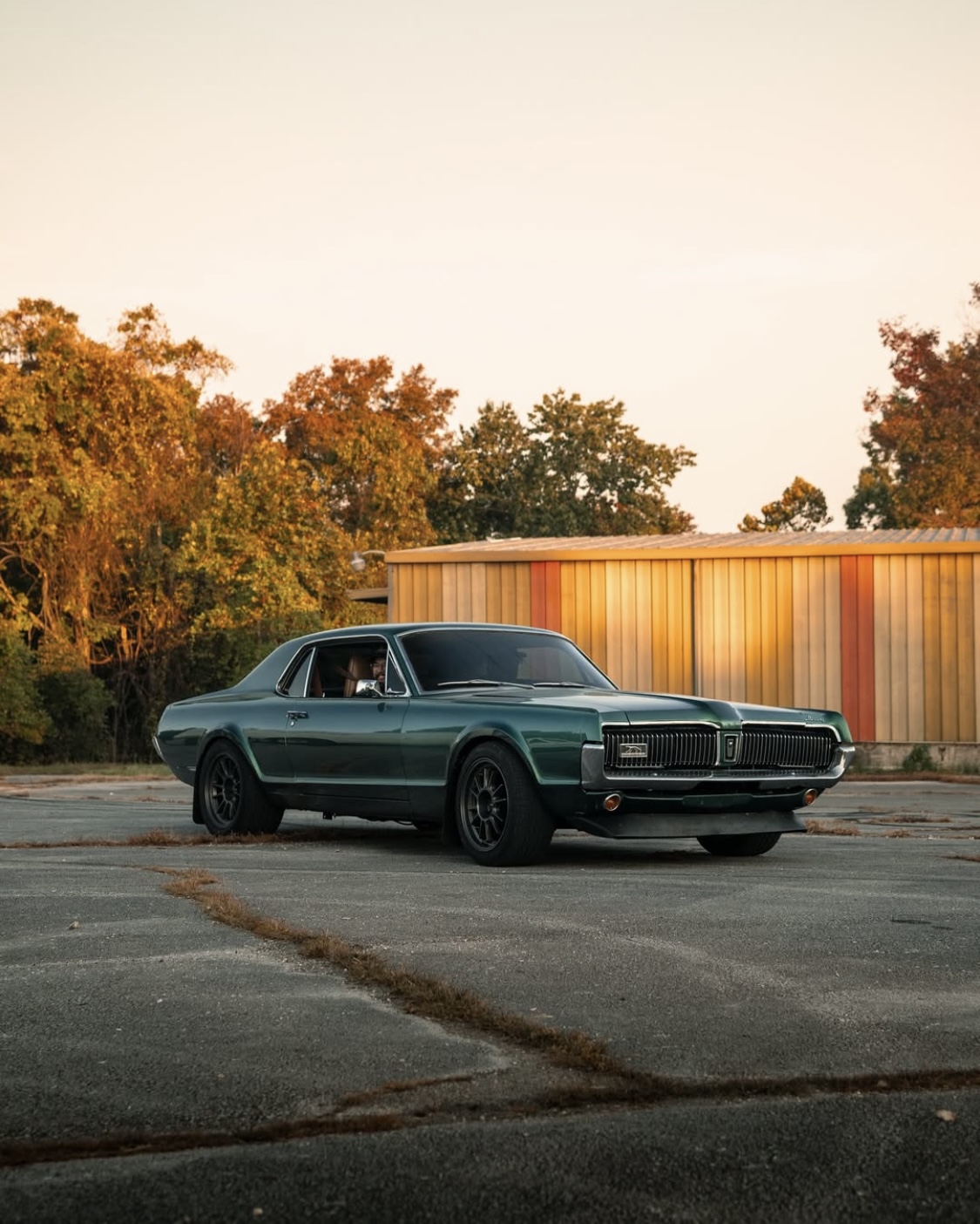

Very nice car - love the color. I, too try and make mine a regular driver.

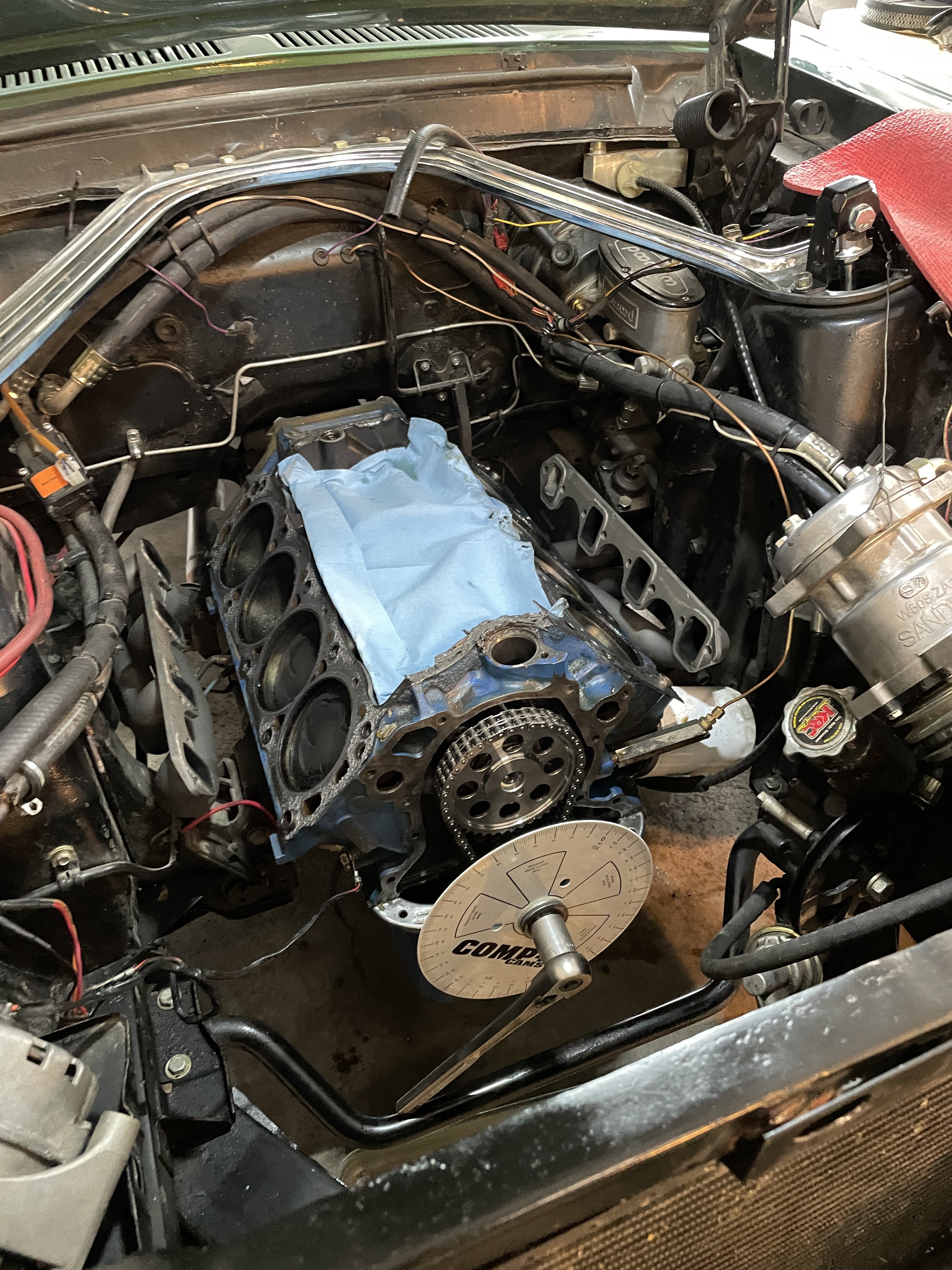

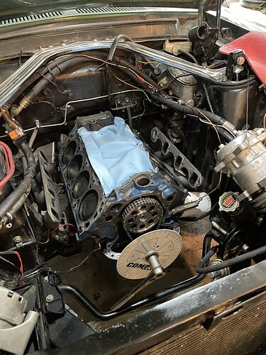

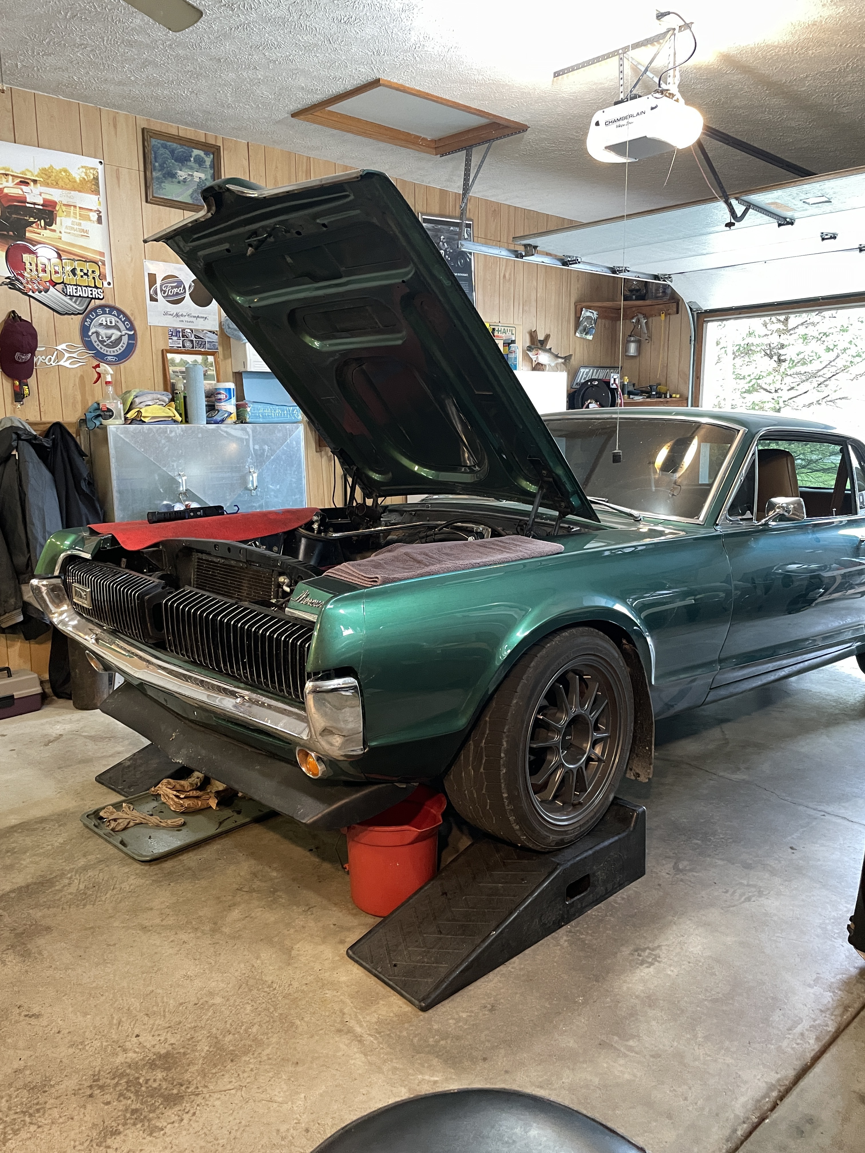

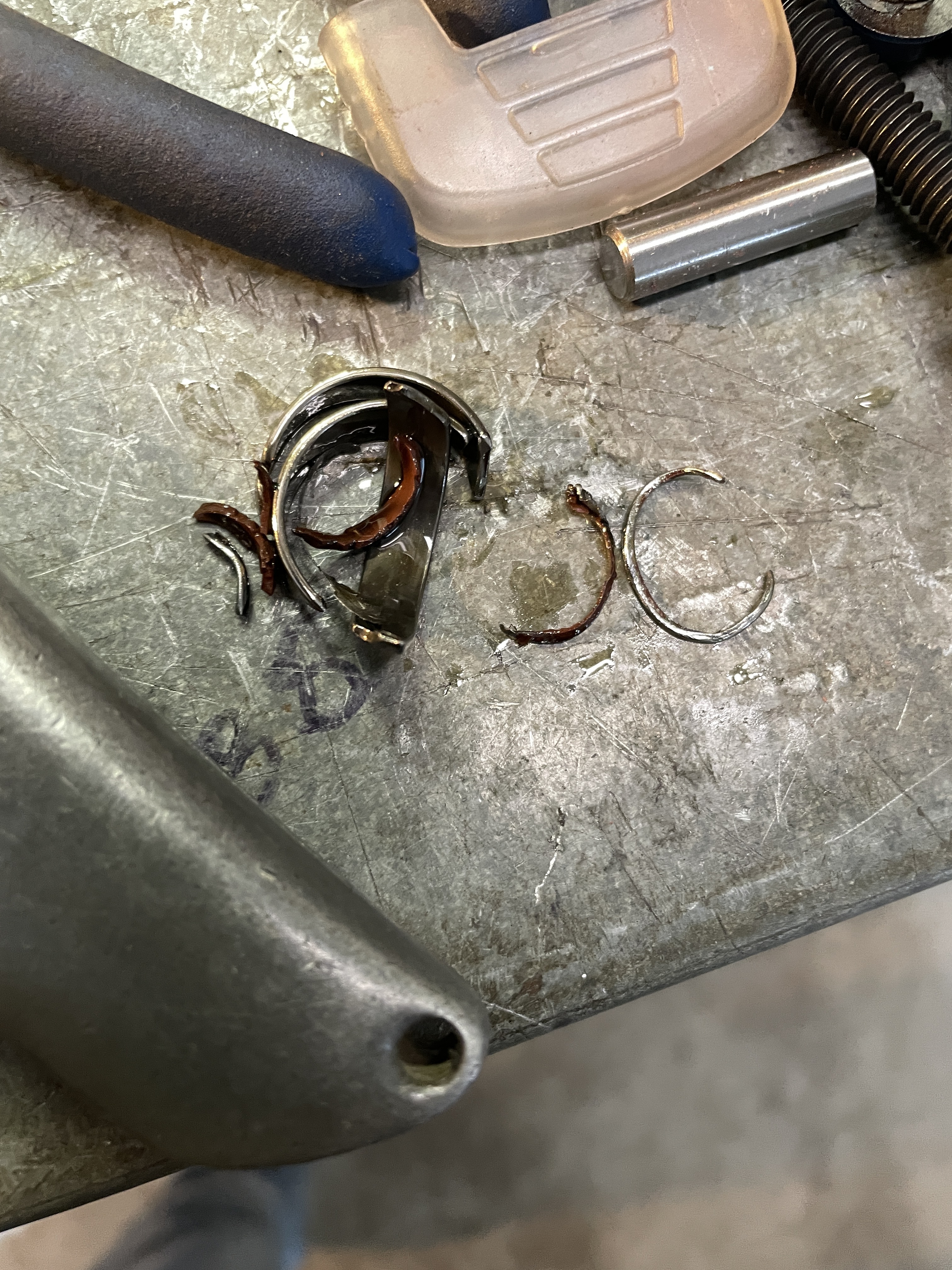

Good morning! I was in the middle of a cam swap when we found the spring dampers were destroyed in the heads. Heads are off and going to the machine shop Monday, hoping we don’t have a lot of other issues
