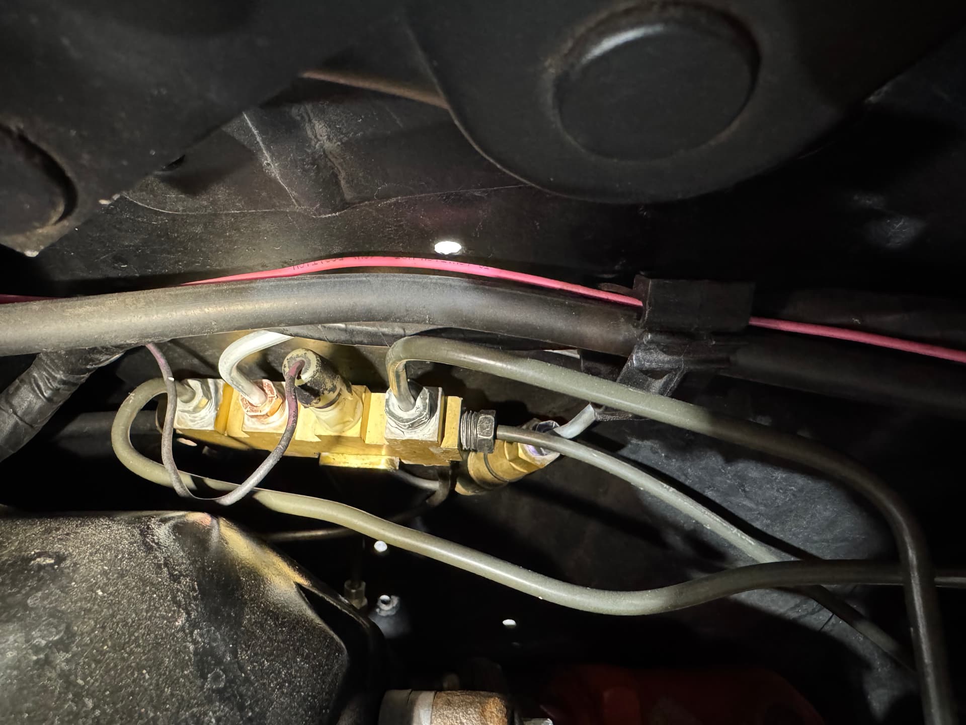

this is the distribution block and portioning valve
