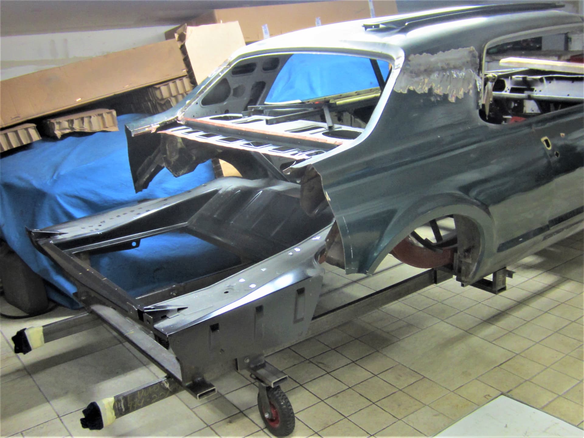

Hi!
I did all that without any welding experience .And with very good results.
But to be sure that everything stays in place I braced the complete car. I also replaced the frame rails, the floor, the roof, the front end and the rocker panels.Good luck !
Nice, hopefully I don’t have to go to that extent. My wheel wells and trunk are still pretty solid for the most part. Do you think leaving one quarter on would keep it rigid enough to not have to add additional bracing?

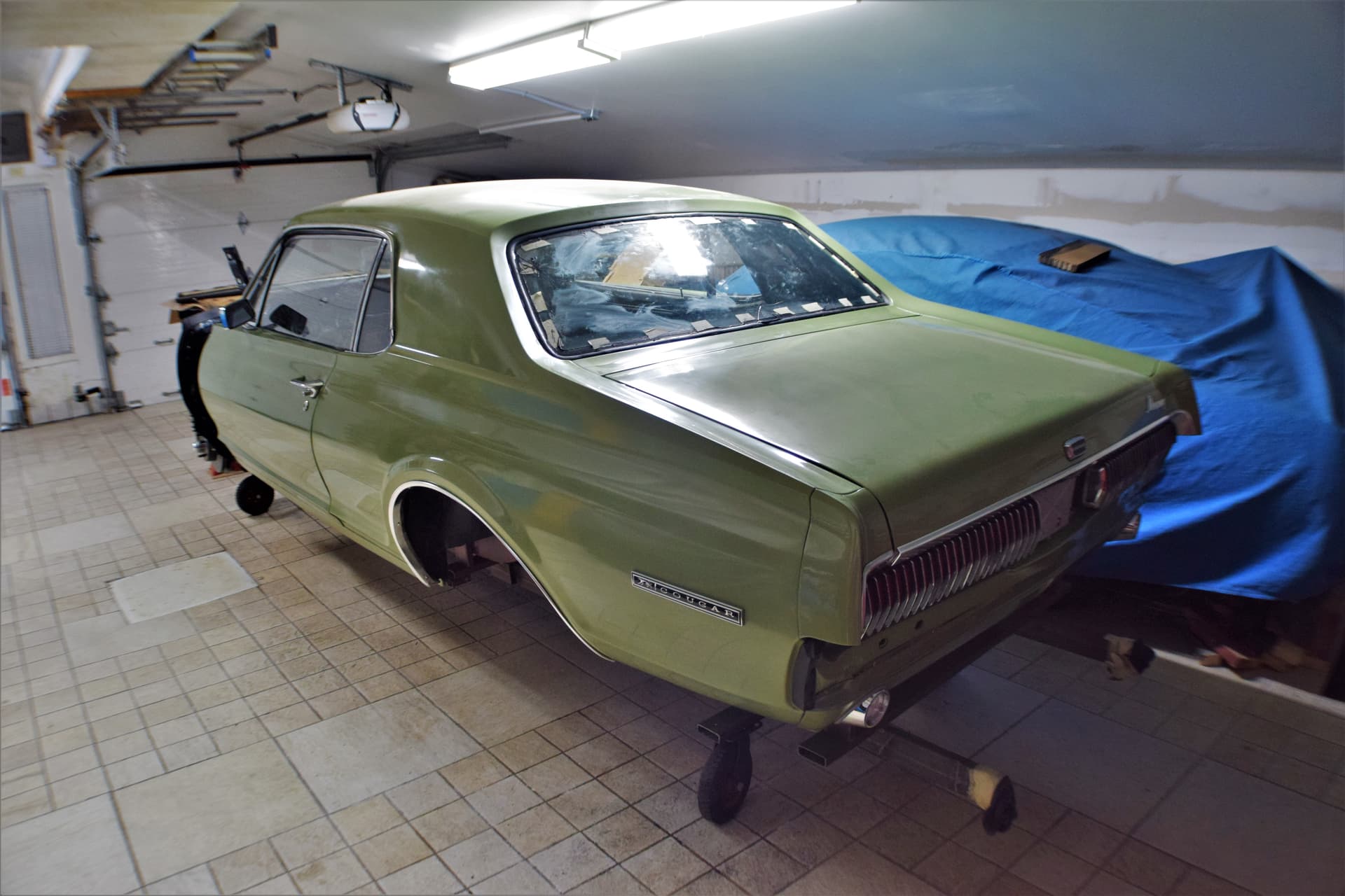

Hi!
The straight an answer is yes, but when I removed (cut) the first quarter panel, the panel pops (maybe due to previous repair or bender fender).
So I was happy that everything was braced .At the end it’s made my project easier, the time spend bracing paid off.
Here’s a picture taken last week. So 2 years after I start the project.
My advice to you is DON’T MAKE ANY ROUND CORNERS TAKE YOUR TIME !
Anything that you overlook or go to the Fastlane will haunt you at the end.
Wow, it looks great. Bravo
