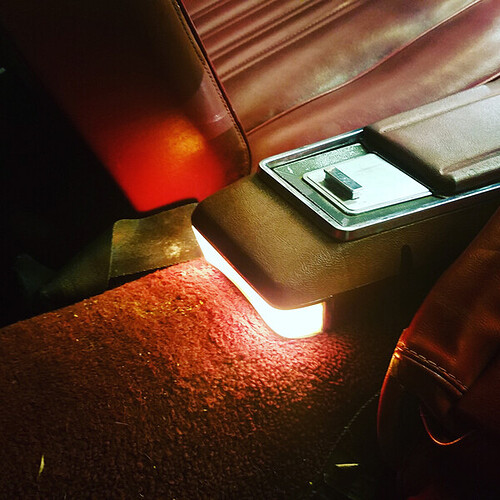

How do I tie-in the courtesy lights on the console into the non-console wiring? Should I just splice them into one of the underdash lights or is there a plug somewhere?

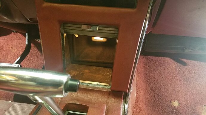

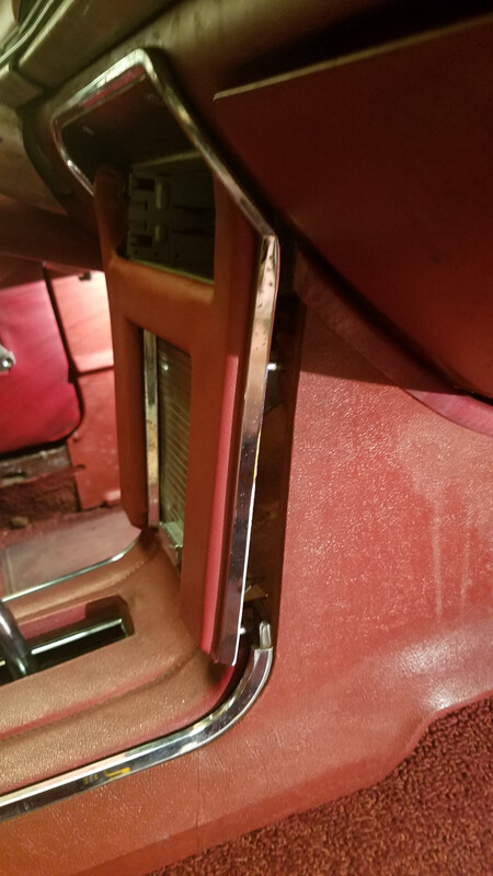

First of all, you need to be sure of what console you have. It could be from a 67 or a 68. It could also be from an XR-7. There are differences. It sounds like you may be missing some pieces too. You shouldn’t have to make any adjustments to the transmission itself though. There should also be a plug underneath the dash that the console wiring can plug into. Not sure why you are having a hard time getting the shifter into park. It could be installed incorrectly. Also, not sure how bad the radio section has been cut out. Some pics of what you got to work with will help us give you troubleshooting tips.

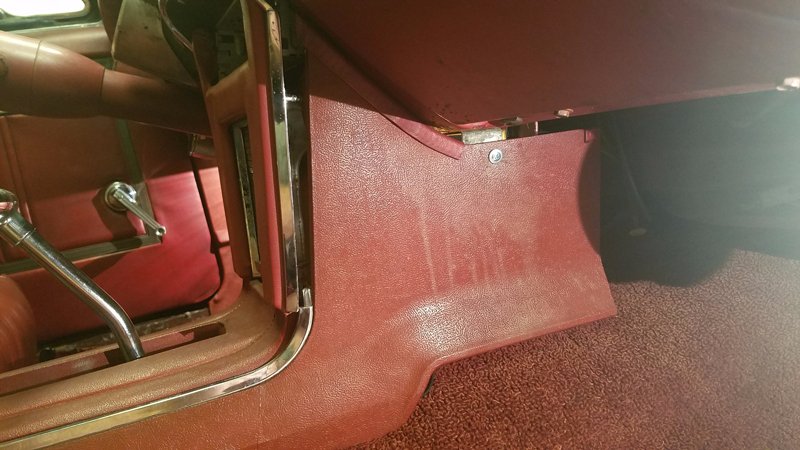

I did a lot of crawling under the dash and fitting and adjusting the past few nights. I think the previous owner perhaps installed the metal brackets under the dash in not quite the right place, so I drilled new holes in them further back. That scooted the entire unit more up against the dash and solved the shifter issue. However, the front piece with the radio slot still isn’t fitting quite right, so maybe I moved the entire thing too far forward.

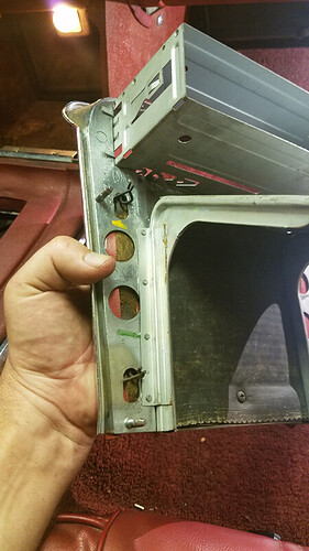

I did find the plug for the lights, so those are working now. However, I just have the panel on the inside of the storage compartment wedged into place. Is it supposed to clip on somehow?
After browsing WCCC and looking at parts, I deduced that I needed some speed nuts for the plastic posts on the back of the radio panel. Hopefully I ordered the correct ones.
Still pretty bummed that it’s going to be over $250 to get the correct shifter, shift indicator light and that little bracket that connects them.
Good pics. You definitely have a 67 standard console. XR-7 consoles had a clock in the center and were somewhat different. The panel on the inside of the storage compartment should fit right into slots in the console itself. There are 5 slots. One on each side towards the top and 3 on the bottom. From the photo you have provided, what you have looks incorrect. Also, the shifter on a 67 had a small hole/connector that is for the shifter rod that connects to the indicator light that slides back and forth. I am unsure if a non-console car would have came with it or not. As for the parts, yes, they do add up. It looks like you are well on your way to getting what you desire though. Good job thus far! :clap:

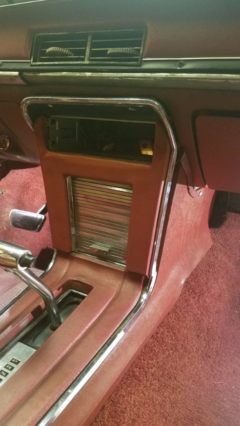

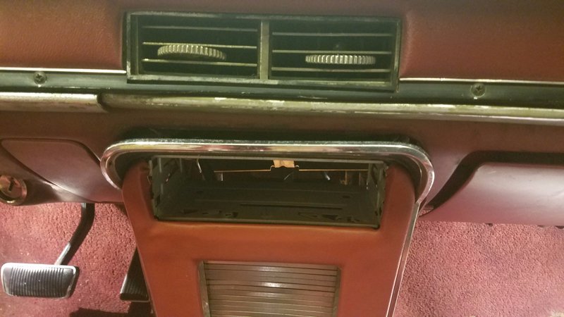

Further inspection of your radio area does show why you may have clearance issues with that cut out. It looks like the previous owner had a CD player. Did it ever fit correctly? Good question. I have a tape deck and it fits just fine, but there is not much extra room back there.

I bought one of these Amazon.com for my wife’s old Z3 a couple months ago, and it works fine, so I was considering ordering another one to stick in the Cougar until I can afford the small fortune it takes to get an uncut radio panel and pad to swap in there.
For $100 you can now get an Android head unit with a pop-out 7" touch screen, navigaion and a back-up camera. I thought heck, maybe I’ll do that and make the best of the cut out, but it looks like those won’t work in the Cougar due to the upper protrusion of the radio bezel.
You have lots of options. Some more expensive than others. My radio panel was cut and I had to get one from WCCC for $140. That was for the B grade, since an A grade was unavailable and that still would have been double the price. You need to remember that these cars are 50 years old and not many remain. The days of the $100 parts cars are gone. I know. I have bought two 67 cars for $100 each for parts decades ago. Get what you can get while you can get it. There are repro parts for the Cougars nowadays, but not like the Mustangs and Camaros. Good luck to ya, Brother!
